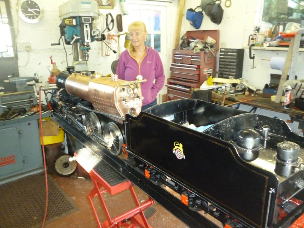

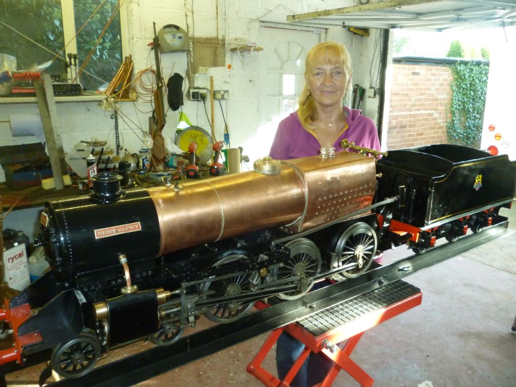

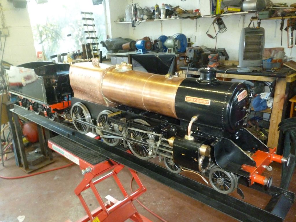

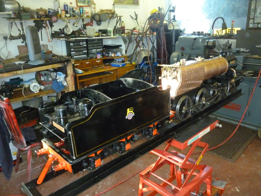

            p1070197-001.jpgp1070196-001.jpgp1070195.jpgp1070192.jpgAs Promised Boiler in the Frames.

                Looking good Ron…..is that the missis wondering where her next holiday has gone??
                #205782
                Ron Hancock
                  @ronhancock63652
                  How did you guess she only said this afternoon now you finished with the Loco can we go away for her Birthday in November.
                  She was not impressed when i said i had just ordered two new injectors for her birthday £120.
                  But she is still speaking just about he he.
                  Well i did say she could have a drive when finished.
                  Yes its starting to look like a loco at last had the boiler back Friday after George fitted another piece to the front for me.
                  Dreading doing the cladding !
                  #205790
                  KWIL
                    @kwil
                    Ron,
                    Good picsyes
                    K
