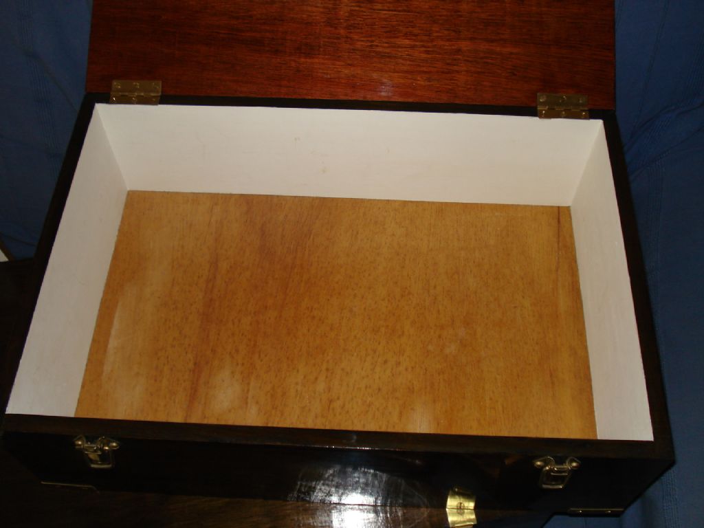

            Richard S2
              @richards2
              Good luck with your project.
              I cheated and sliced up an early 60s Kitchen Unit Top Box which I saved . Good quality wood and machined Dovetails. Too nice to break up-
              Glued-n-screwed Old Marine Ply for the bases. The 2 boxes will take 20kgs of Lathe accessories each with no issues-
              Making the partitions out of mahogany at the moment.
