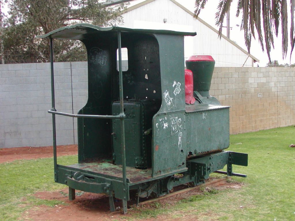

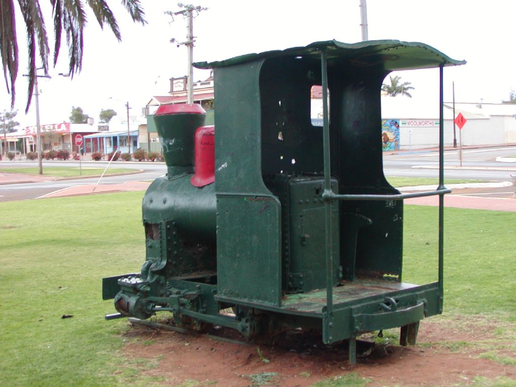

        Gentlemen
        this is a plea for help and an opportunity for one or more of you.
        I would like to see an article in model engineer for a 3 1/2″ and or a 7 1/4″ gauge model of this rare little 2ft gauge locomotive.
        This is the only loco from the Belgian maker Haine-StPierre ever to be imported to Australia. I believe it was made in 1887. It currently sits as a display in a park in the main Street of Meekatharra in Western Australia.
        It has been stripped of many components (prepared for display it was described as) but one of everything remains.
        There are no details sufficient for this neophyte to determin what the valve gear was on the loco. it is all external to the frames though. There is also no details available of the setup of the rear of the boiler.
        The Dutch Steam Restoration Society has photos on their web site of a similar loco that I think is under restoration so you chaps in europe and england should have a better chance of filling in the missing details than I have found that I have.
        My Haine-StPierre photo album on this web site has a few more photos and 10 dimensioned sketches I made when I had access to the loco. I have about 80 detail photos that I can add to the photo album if there is interest in modelling this loco.
        just get David the editor to make a post agreeing to the upload and I’ll do it.
        My photos and sketches I regard as being in the public domain so anyone having a shot at a ME design article will have a free go at it.

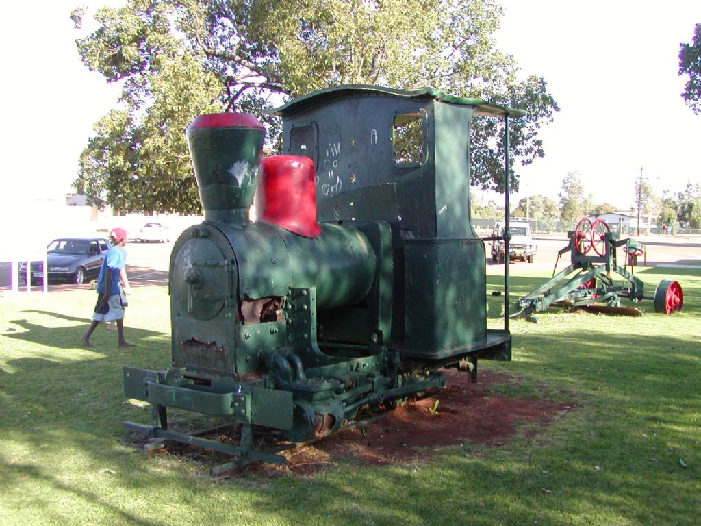

            What a wonderful machine. It looks more like an 60s fridge than a firebox – perhaps it’s an ice-engine?
            Is the equally fascinating device behind it a plough of some sort?

                    Stub Mandrel
                    the fascinating device behind the loco is a horse drawn road grader I seem to recall.
