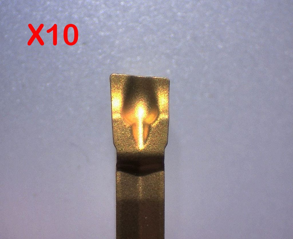

      Having experienced difficulties with the "Greenwood" type unless the TC bit was sharpened regularly on a diamond or CBN wheel, I followed a suggestion made by the owner of a small precision eng company. This was to part off with a slitting saw mounted on an arbour. Probably known to you all and It no doubt breaks all the "rules" yet works very well. When the contact tooth gets blunt, just rotate a little & use new one. New slitting saws aren't cheap but seem to appear in abundance at our M.E.Soc's auction nights. (The image shows parting PEEK CA30 piston rings).

          Fowlers Fury
            @fowlersfury
            With your +ve comments about the "Greenwood" tips, do you both also use the standard holder? (The one shown unused in my image above). I'd be grateful for some guidance then because even though I carefully align the vertical "tip holding plate" parallel with the chuck body, it apparently flexes enough to end up with a distinctly dished cut-off piece. There's no discernable sideways movement in the top slide and the saddle is always clamped hard to the bed.
            I had been using the TC tips from JB in the original Greenwood holder. Those showed this angled cut and I wondered if this caused the concave surface after parting (which doesn't show using the slitting saw & is thus now used exclusively).

                  Posted by Fowlers Fury on 06/12/2017 22:03:47:
                  In my experience, every time you put an angle on the end (usually the other way so there's no pip on the part being parted off), the blade does flex giving a dished surface.
                      Its a left hand parting tip for leaving best finish on the left of job.
                      Looks rather rounded even though unused.
                      Right hand opposite of above leaves in theory clean finished cut to the right.
                      Neutrals just neutral.
                      Try Iscar tips wont go wrong.

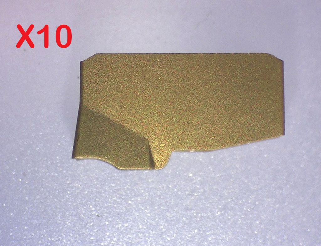

                              Fowlers Fury
                                @fowlersfury
                                > Chris T anhd Jon,
                                Many thanks for your comments.
                                I have used Iscar tips for general turning and found they performed well so I'll certainly try a couple for the p/o holder and hopefully start using it again.
                                "Looks rather rounded even though unused."
                                My thinking too & why I began to sharpen them on a diamand wheel, after which they cut much better. Here's that same new tip from the side:-
