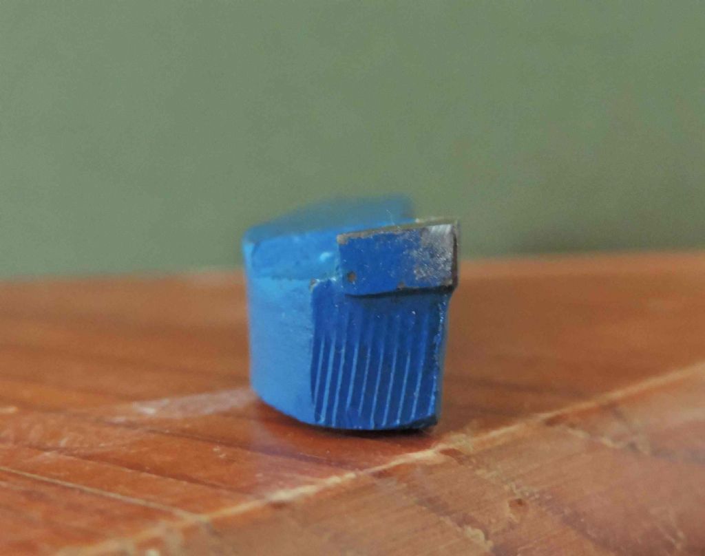

      Posted by SillyOldDuffer on 13/03/2018 10:10:57:
      Posted by Neil Wyatt on 11/03/2018 20:04:36:
      Most carbide tipped tools are supplied as unground blanks.
      Most suppliers don't state this.
      Most purchasers don't realise this.
      Hence most users think they are crap because they are trying to cut using tools with negative front clearance, which is like trying to thread a rope through a needle…
      Well I never. Is that true of the sets though?
      Absolutely, this example shows how the carbide is just brazed in place and needs clearance grinding on it. Don't be misled by the slope on top of the shank, the base of the tool is set flat.
      Edited By Neil Wyatt on 13/03/2018 10:52:40

          Posted by Neil Wyatt on 13/03/2018 10:51:59:
          … this example shows how the carbide is just brazed in place and needs clearance grinding on it. Don't be misled by the slope on top of the shank, the base of the tool is set flat.
          It looks like the base of the tool would need grinding flat before it would sit properly in any known tool-holder !!
          … Is this really what people are buying these days ? surprise

                Posted by Michael Gilligan on 13/03/2018 18:40:50:
                No the opposite. Its just ground under the edges of the tip, to stop any distortion from when the tip was forged stopping it lying flat. The main shank is dead flat all along.

                  Posted by Neil Wyatt on 16/03/2018 15:59:50:
                  Glad to hear it, Neil yes
                  Note: I did, cautiously, use the phrase "It looks like" … [which it still does]

                    Posted by Michael Gilligan on 16/03/2018 18:00:12:
                    If it was my old set, you would probably have been right..
                    I'm not paying for a copy of DIN4980 to find out exactly what the specification is. I note that while some beautifully finished brazed tip tooling costs more than the typical set used by hobbyists, some 'professional supplies' sites sell supposedly 'precision ground' DIN4980 tools that have the entire carbide tip completely covered in paint…
