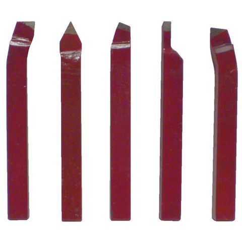

        I have been looking at the diverse collection of lathe tools and only have experience of the my ford carbon tipped tools. I note there are Chinese makers making Osrom or something similar and there are also indexable carbide inserts. does anyone have any experience in using these tools of different type and what are you using now and why please?

            Do you mean Myford carbide tipped? I can't see any on their website?
            There are several places selling brazed carbide tipped tools. The best advice I can give is to avoid them at all costs as generally the quality is poor, you will soon chip one, and then its junk unless you have a grinding wheel that will cope. Even then it's hit and miss.
            Indexable carbide tools are a very different kettle of fish. There are lots of suppliers to the hobby, quite a lot of discussion here. I can recommend JB Cutting Tools and Greenwood Tools, I've bought from both and the tools have been/are good. You buy a holder and inserts that generally have multiple cutting edges, as one wears you turn the insert round to select another. Widely used in industry – in fact the default nowadays. There has been a view that they don't work well with our small lathes, but I find them fine with my Super 7. But search on here for other views. My go-to tools use rhombic 80 degree inserts, I have holders for RH and LH knife and boring, and also one that lets you use the 100 degree corners for roughing.
            I can also recommend the Diamond Tool Holder from Eccentric Engineering – see advert/link to the right. These use a 1/4" HSS square bit but have only one face to sharpen. Give very good finish and can take large cuts.

                          Most carbide tipped tools are supplied as unground blanks.
                          Most suppliers don't state this.
                          Most purchasers don't realise this.
                          Hence most users think they are crap because they are trying to cut using tools with negative front clearance, which is like trying to thread a rope through a needle…

                                                  Posted by Neil Wyatt on 11/03/2018 20:04:36:
                                                  Well I never. Is that true of the sets though? Starting up with a new mini-lathe I bought some very like this from MachineMart:
                                                  They seemed to cut OK. After a while I decided they were neither fish nor fowl, combining the disadvantages of HSS and Carbide in one convenient tool! (I find HSS is easier to sharpen than carbide, produces a good finish and isn't fussy about cutting rates. Inserts don't need sharpening at all, and – big advantage – changing one doesn't disturb the tool settings. The downside of inserts is they like to be worked much harder than HSS. Also they have a pronounced sweet-spot such that not using them "correctly" is liable to produce an inferior finish.)
                                                  I've never tried a carbide tipped shank that didn't come from a pre-shaped set. Am I missing out on a useful option?

                                                      Neil's point would explain my experience with the only brazed carbide tip tool I ever bought.
