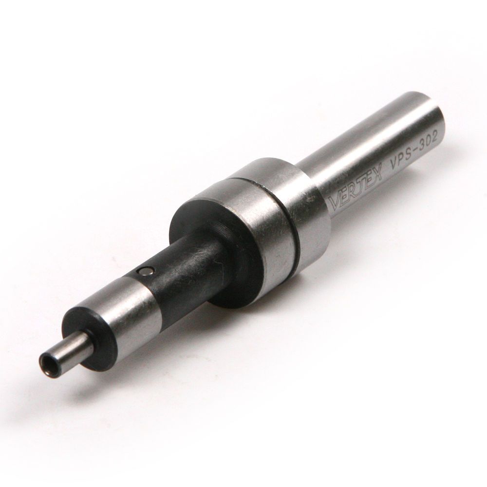

                Andy Holdaway
                  @andyholdaway
                  I use the ball ended type that lights up an LED on contact. It requires a certain 'feel' but I find it very easy to use, and certainly accurate enough for me in combination with a DRO.

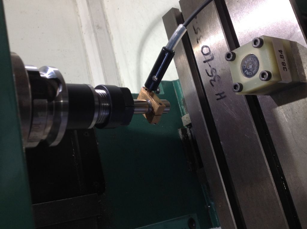

                      #345191
                      John Haine
                        @johnhaine32865
                        Partly to this and partly to the laser safety thread, here are a couple of photos of edge and height finders I made form my CNC mill. The edge finder is equally suitable for manual mill where contact is sensed by my multimeter on the lowest resistance range which has a continuity buzzer function too. One lead goes into the 4mm hole in the brass block, the other to the machine table. Slowly advance the finder to the edge and it buzzes when it touches. Spindle axis is then 4.99 mm away from the edge. Took about 30 minutes to make, then 2 days for araldite to cure, and another 30 minutes to finish off.
                        Edited By John Haine on 09/03/2018 13:52:28 sorry the photos are on their side

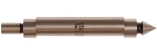

                          I treasted myself to a Starrett double ended edge finder. Very useful, 10mm dia body and 6mm dia tip.
                          Got it from Amazon at a reasonable price. Doesn't mark the work very much if at all. Very easy to use, just allow for the 3mm radius to find the edge.

                              #345195
                              richard 2
                                @richard2
                                Many thanks indeed everyone.
                                I have decided to go for an LED edge finder as that will be easier to see than having to use a magnifier.

                                    #345220
                                    Journeyman
                                      @journeyman
                                      Posted by Simon0362 on 09/03/2018 16:02:40:
                                      I own one like Journeyman with the pointed centre and I have never managed to work out how to use the pointed part for centre finding……
                                      Is this equally obvious to all bar me?
                                      I've only ever used the straight end on mine wink so any pointers to using the sharp end would be good!
                                      #345224
                                      Emgee
                                        @emgee
                                        Posted by Journeyman on 09/03/2018 16:46:11:
                                        I use mine in a collet but only tighten by hand to allow the edge finder to move up when the point is lowered into a centre drilled hole, any off centre can be easily seen or felt and the table axis moved to correct alignment.
                                        The same method can be used in a chuck but these normally have less length to allow the tool to slide upwards.

                                        #345237
                                        Muzzer
                                          @muzzer
                                          Mine is single ended with the "square" end, so I've not used the pointy type. However, I assume it's for centre finding smaller holes than the square end will fit in (4mm in my case).
                                          I tend to use mine with the DRO or CNC, so it's easy to subtract the 2mm radius of my square end or use the "1/2" function on the DRO. Obviously with a pointed end you can't subtract the radius but that's not an issue when finding the midpoint ie hole centre.
                                          There may have been a handful of situations where a pointy end may have been useful. When I eventually shear the end off in a senior moment, I may replace it with a double ended version that has a pointy end.
                                          If you look carefully, there is sometimes a very light witness mark where it touched if you use it on loominum but it's really not a concern on my work.
                                          Murray

                                          mark costello 1
                                            @markcostello1
                                            The center point picks up center marks or I sometimes use it to pick up a chamfer on a hole.

                                                    D Hanna
                                                      @dhanna35823
                                                      The pointed end of that type of edge finder is used to set up work to a prick punch/centre hole on a marked out workpiece in a 4 Jaw chuck. The body is held in Jacobs chuck in tailstock. The point is lightly located in the punch spot on the workpiece. A DTI on the pointed section will show trueness as workpiece is rotated. Hope that helps.
