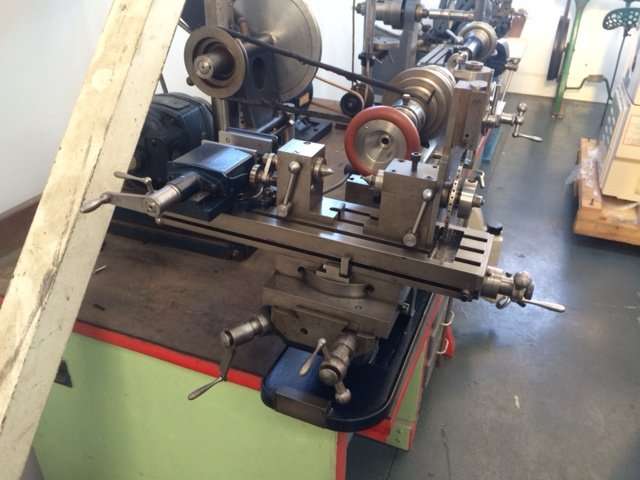

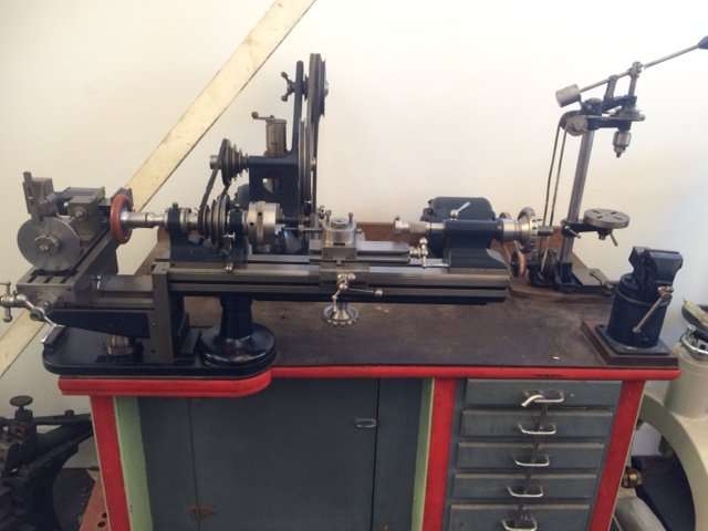

          When I visited a machinery dealer a few years ago there was a model engineers workbench with a mill, lathe, drill press and a vise set up on it.

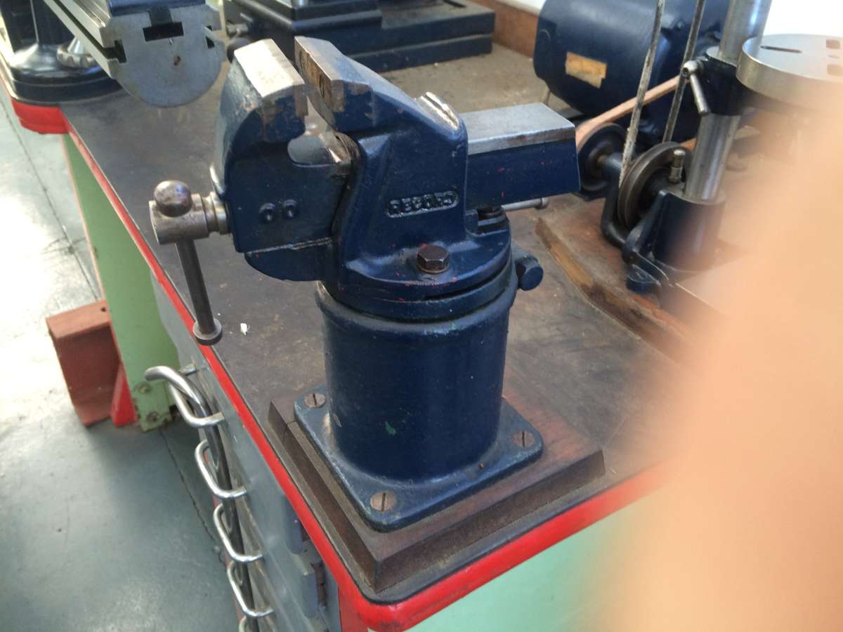

          The vise was a record 00 vise and I was quite impressed with how it was mounted, it had a swivel feature and locked up so solid. I’ve always thought if this design was upsized and used with a record 5″ vise it would be a very versatile setup.
          Here is a pic of the bench setup
          Img_1241

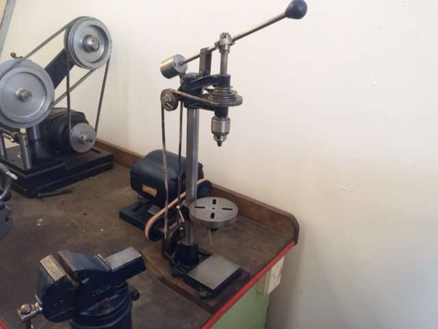

          The vise and drill press
          Img_1242
          A better pic of the vise
          Img_1250

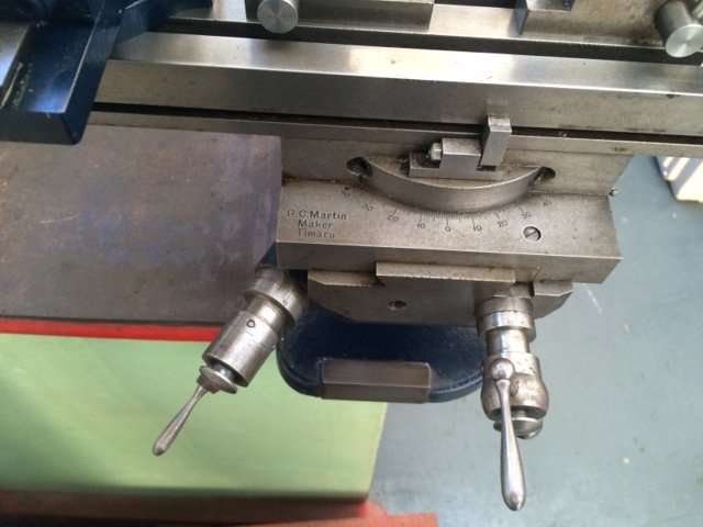

          And just in case anyone wants to see here is the mill
          Img_1245
          I thought I would add this, you can see the makers name
          Img_1248

              Nice setup ! All in one package

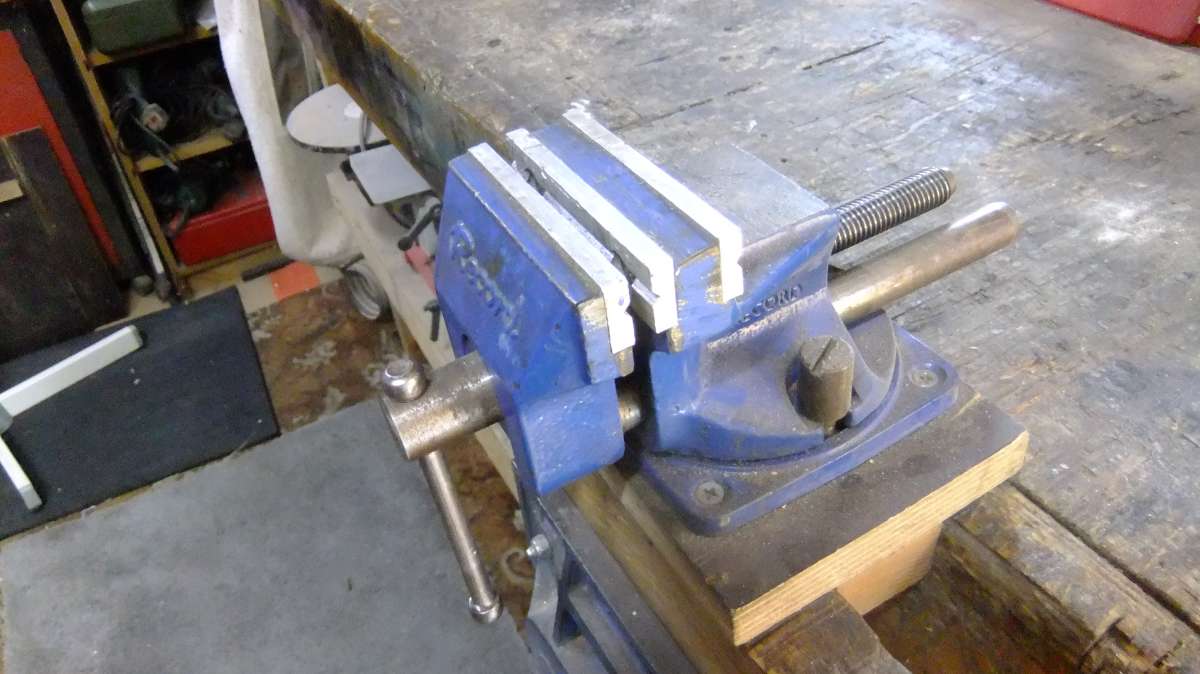

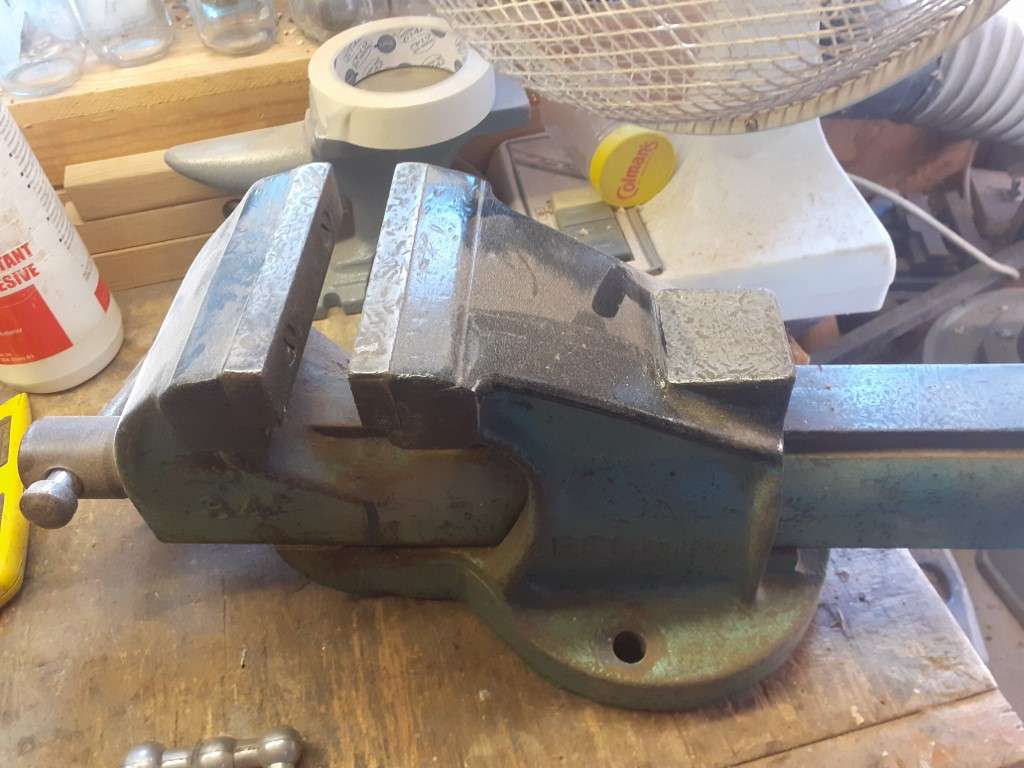

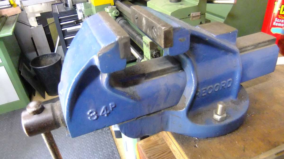

                      These are the two metal working vices that I use, the large record one was a gift and does lock across the jaws, the second was one I purchased but had soft jaws. This one swivels which can be useful, when the plastic soft jaws wore out I made some replacement Ali ones as can be seen. I do need to replace the temporary base for something better but for the light use at the moment it does a good job. Both of these are Record vices.
                      Before and after photos of the large vice
                      20191027_121015 (1024x768)DSCF4308
                      The small swivel base vice
                      DSCF4309

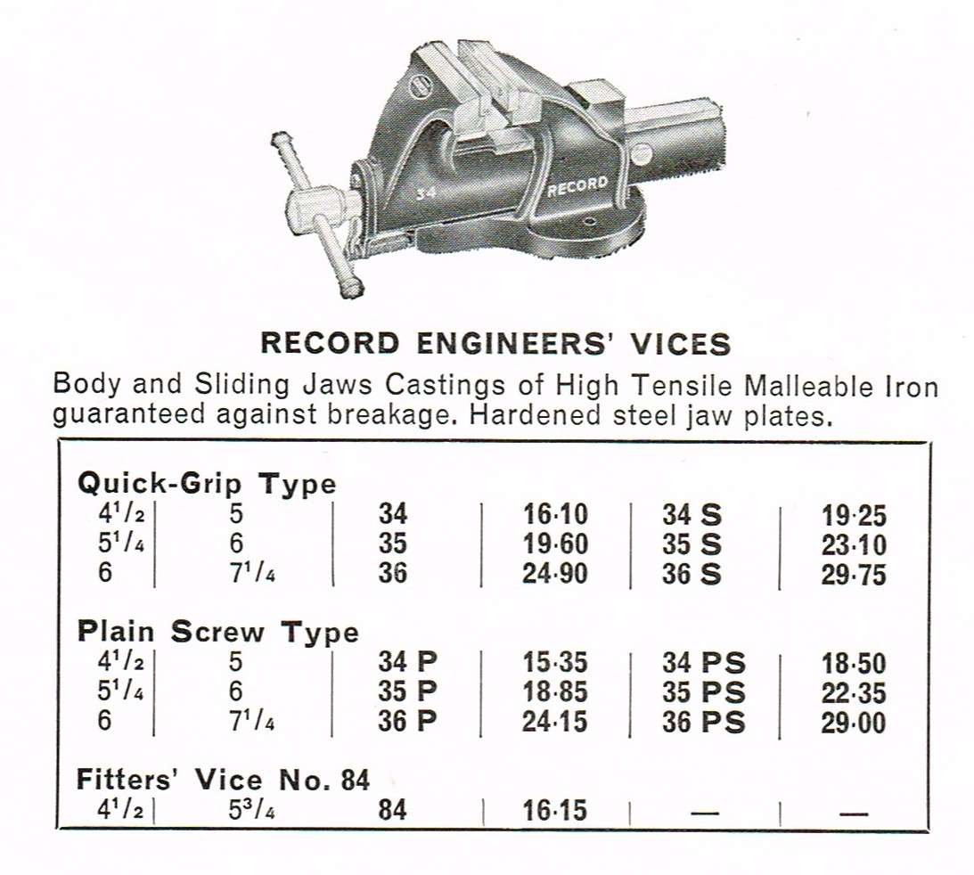

                        Hi Dalboy, that No: 34P vice is a good one. the price (£/p) in the scan is 1974.
                        Engineers Vice
                        Regards Nick

                          I have that exact vice, the 34p, didn’t cost me anything I probably would have looked for a quick release lever if choosing a particular vice but it’s good condition and an excellent vice.
                          The smaller one with the plastic jaws is a 2075, I’ve thought about buying one a few times for my car tools toolbox, looks like it’d be good for holding brake calipers while rebuilding and stuff like that, the movable jaw comes out and can be put in the rear side for a bigger opening.

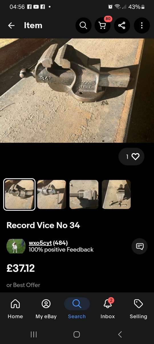

                          A quick look on ebay and you should find something without much problem, I found this within 1 minute of looking, if that isn’t a bargain I don’t know what is, much better than anything you’ll buy new for under 500 quid, it’s a steel one too.
                          Screenshot_20250623_045621_eBay

                              Yes the 34P is a good vice not really needed the quick release version but when I was given this one why complain. I also enjoyed cleaning and repainting mine.
                              Yes @Pete I also like the fact that the jaws can be reversed for larger opening
