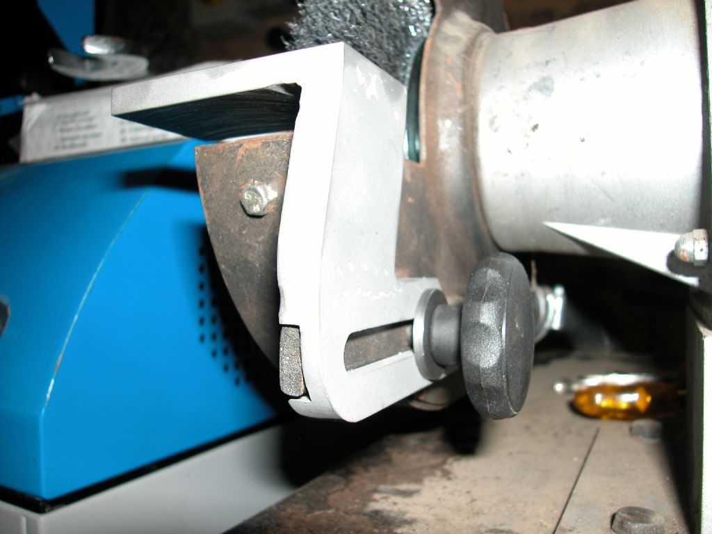

                      Clive Foster
                        @clivefoster55965
                        Used a cheap Whitcote 6" grinder for many years. Typical of the not so bad imports. Adequately smooth, just about OK grey coarse and fine wheels and, like Colins Hilka, less than stellar grinding rests that weren't quite bad enough to absolutely have to be replaced. Almost but not quite. There being more work than it appears at first sight in going from back of envelope sketches to something properly engineered that really will work. When I got a bit more serious about things I sidestepped the whole issue with proper cup wheel and adjustable angle table on the side. One of these :-
                        cheap from Axminster worked pretty well once I'd swopped the nuts on the adjusters for Bristol handles.
                        Couple or three years back a Cruesen came along at a price that didn't strain the budget too far. Evidence of careless use included a grinding wheel that pretty much re-defined undressed and a missing grinding rest on the left hand side. So I had to do something.
                        Found some 12 mm and 8 mm steel plate to weld up an opposite hand copy of the one on t'other side up from. Came out pretty well :-
                        Took some pictures of the making thinking I might do an article for Neil but illness and family issues got in the way. If it might be of interest I could have a a go at a write up now I have time again. Need to draw up the mount rail on the grinder tho'. If someone did want one its lots easier to modify dimensions on an existing drawing than to engineer from scratch.
                        Can easily send a PDF copy if required. Just PM me your E-Mail.
                        Clive
                        Edited By Clive Foster on 15/01/2018 19:07:17
                        Edited By Clive Foster on 15/01/2018 19:08:19
                        #336890
                        Joseph Noci 1
                          @josephnoci1
                          There are so many ideas deeply buried in the posts on this site – the same problems, queries and requests come up again and again, but it is rather difficult to find the buried info.
                          Anyway, my efforts at half decent grinding rests was a post last year some time…some of the pics attached again – also not easy to just link to the specific post itself, rather than the entire years thread…No idea how this stuff works anyhow!
                          The typical crappy rests that are supplied with the grinder..
                          The new rests made from bits of flat bar, angle iron and round bar
                          All fitted to the grinder:
                          Tilt and pivot to hearts content.
                          Joe
