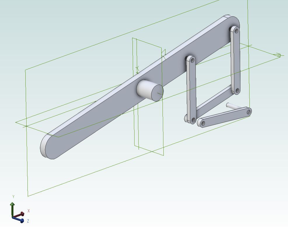

      What would be an acceptable amount of lateral movement in the piston rod for a beam engine?
      I know the Watts linkage does not produce a perfect vertical path, I have moddeled the linkage and can get the error down to to less than 0.19mm (0.0075 ins)
      Would this be an acceptable error on an engine with a stroke of 60mm in a 22mm bore ?

          Before making a comment I would like to know the length and diameter of the piston rod. I assume the rod is steel (or stainless steel).
          Really I am bumping the topic up the list because it is an interesting question.
          JA
          Is the "error" 0.19mm overall or plus/minus?

              Mr Watt has 2 straight line linkages, one as used typically on beam engines, the other on verticals (cylinder at bottom, crank overhead). As you have found they both produce a shallow S shape, but if you frig the position of the fixed points you can get top middle and bottom on a straight line. Is this what you have done? I ftf so the maximum error will be at 1/4 and 3/4 stroke, so there will be a bit of rod sticking out to accommodate bending. Ideally you'd make the gland float, but difficult in small sizes

                The piston rod would be 98 mm long SS plus the piston thickness.I am working on a diameter of 5.5 mm to 6 mm.
                The error is 0.19mm right at the bottom of the stroke and is down to 0.04mm after 60 Degrees of crank rotation which equates to 5mm of piston movement. At 254 Degrees the error is -0.05mm and at TDC 0.09 mm.

                  7 thou is not much. Just make the packing gland a loose fit and let the packing fill in the gap. Teflon can do wonderful things. And make the piston a loosish fit, maybe even a little barrel shaped to allow a little angular clearance. Use a viton o-ring as piston ring and let that do the sealing. James Watt did not run one thou clearances in his engines. Some of his engines ran 1/8" piston to bore clearance and more.
                  Plus a bit of clearance on all the pins and links and piston rod bearing will all add up to provide some relief as Jason says.
                  As Mr Harley famously said to Mr Davidson: A little extra clearance never got in the way.

                      You said 60mm stroke in your original post, I see you now have a crank throw of 26mm = 52mm stroke.
                      5mm dia would be more than enough for the piston rod on an engine with that size bore, it's what I tend to use on engines upto 25mm bore and similar strokes to what you now have.

                        One simple way to reduce the effect of that -0.05 to +0.19 error would be to move the position of the cylinder -0.07. This would then give you -0.12 to +0.12 about the cylinder's new ctr line at the extreames and the +0.04 would become -0.03. That reduces the maximum deviation by about 30%

                          I just plotted out the geometry of the Stuart Beam engine in Alibre by way of comparisson as there are plenty of thos ethat work. With no play in the pivots
                          Piston mid stroke 0.00mm offset
                          Piston top stroke +0.14mm offset
                          Piston bottom stroke  -0.14mm offset
                          This is 51.8mm stroke, 25.4 bore
                          If I allow for an H7 tolerance on all the pivots which is 0 to + 0.01mm and what your average reamer will give there is 0.07mm of sideways play at the pivot on the end of the piston rod so those offset figures could be halved allowing for play in the links.

                                          So what I'd suggest is rotate the piston centreline so it passes through the 3 points Jason has identified, then rotare the whole thing back again to get the piston CL vertical. This will mean the beam doesn't go equally up and down, but not noticeably, but the deviation from a straight line will be reduced, and the max deviation won't be at the bottom of the stroke, so the piston rod will be further extended and more accommodating.

                                              You could even do a least squares fit to the locus of the pin, but that might be OTT, and it wouldn't be on centre at the bottom which feels like a good thing.

                                                Having read all this I am considering a slight shift of the cylinder away from true, It would be such a small deviation so hardly noticable if at all. Havn't got round to the cylinder yet.

                                                  Having completed my first simple beam engine recently I found it most frustrating trying to set it up to run smoothly.
                                                  I couldn't understand why the piston rod was binding at around a 1/4 and 3/4 of its travel. Of course I now know why!!
                                                  It didn't help that I reamed the holes (3/16&quot in the cylinder and gland cap so the piston rod was a precise fit. I decided to enlarge them to 4.9mm and rely on the ptfe plumbers tape between the caps to give a good seal.
                                                  It certainly did the job, much smoother, still a little binding but nowhere near as bad as it was. Engine now ticks over really slowly, so I'm really happy about it.
