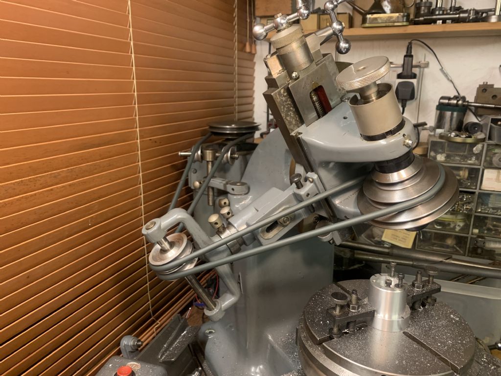

        I'm making a comparison of the best drive system from Hauser Mill to Deckel pentograph GK2 and now BCA milling machine. Does anyone owns a BCA mill and able to share some light over the pulley drive system as well as the constant belt tension it can offer when the spindle head moves?

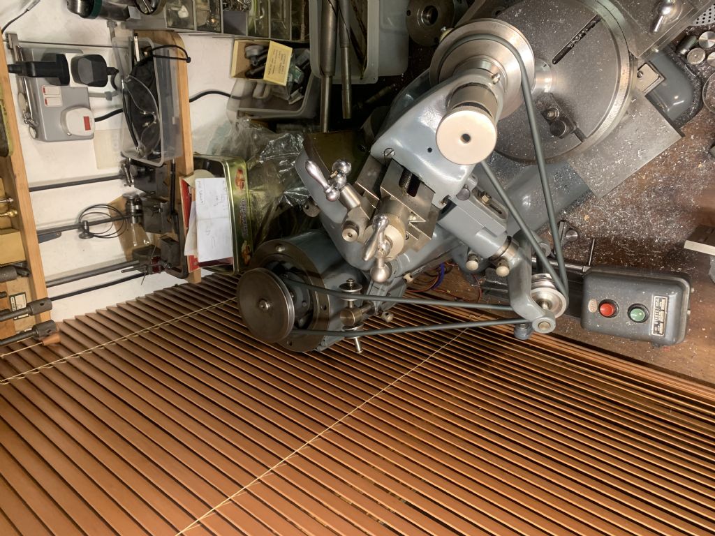

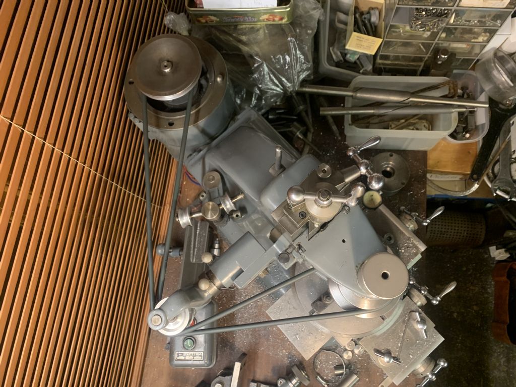

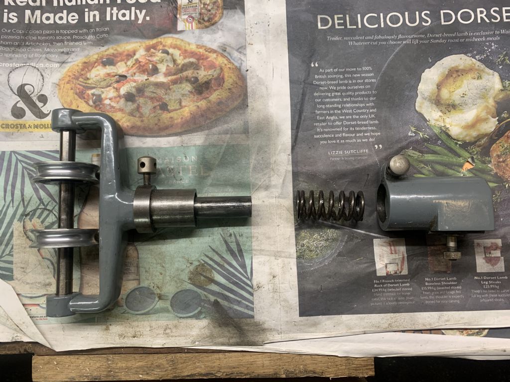

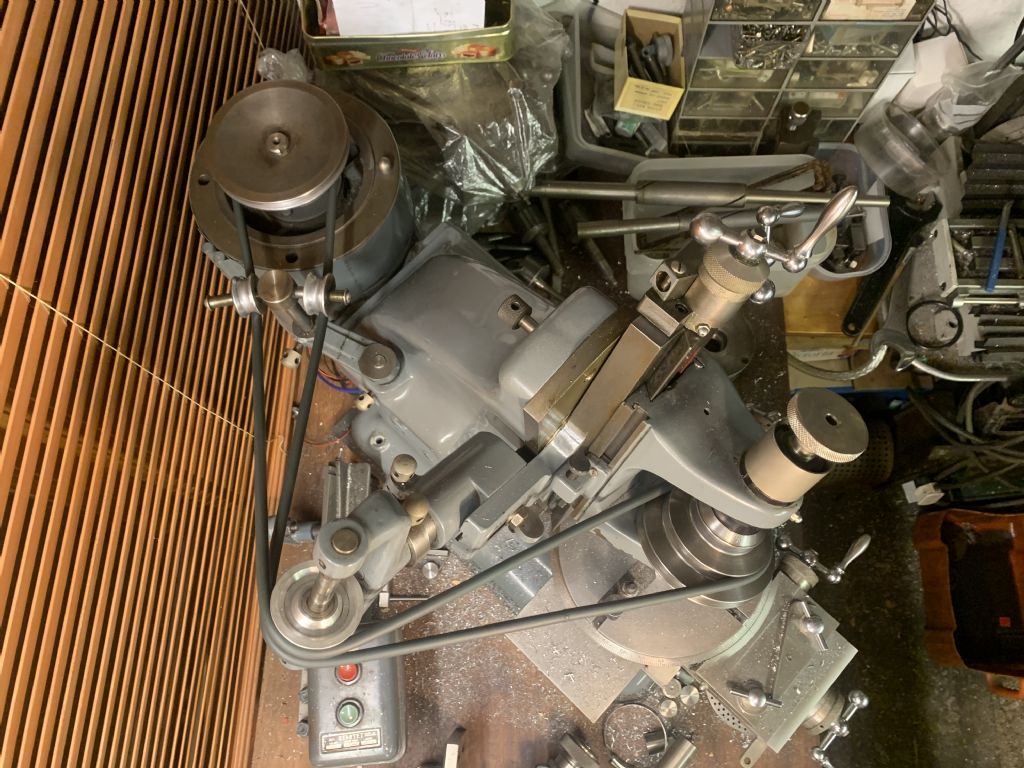

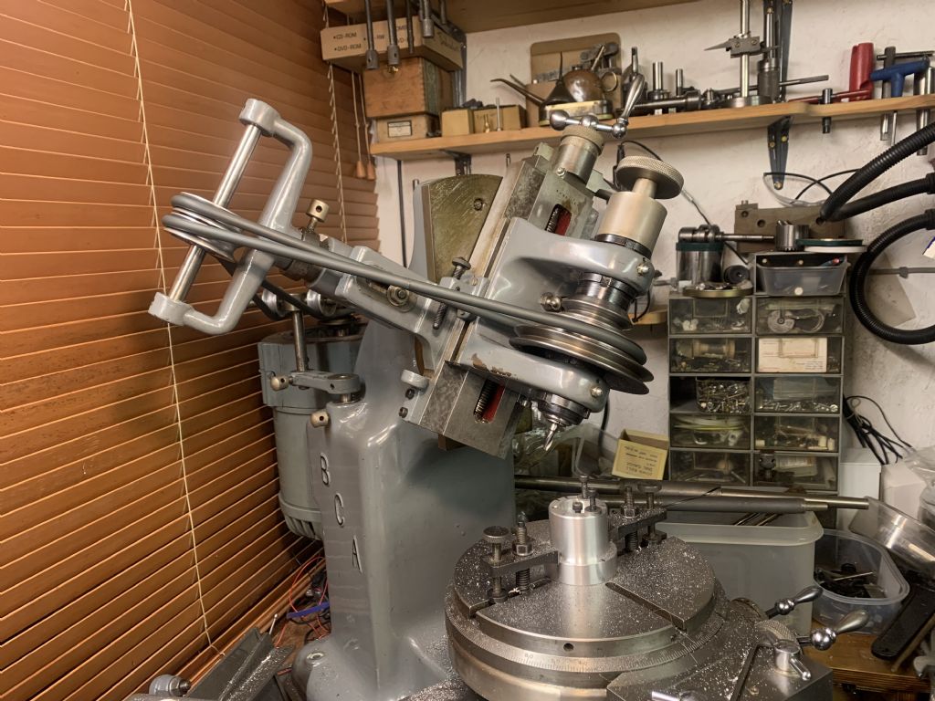

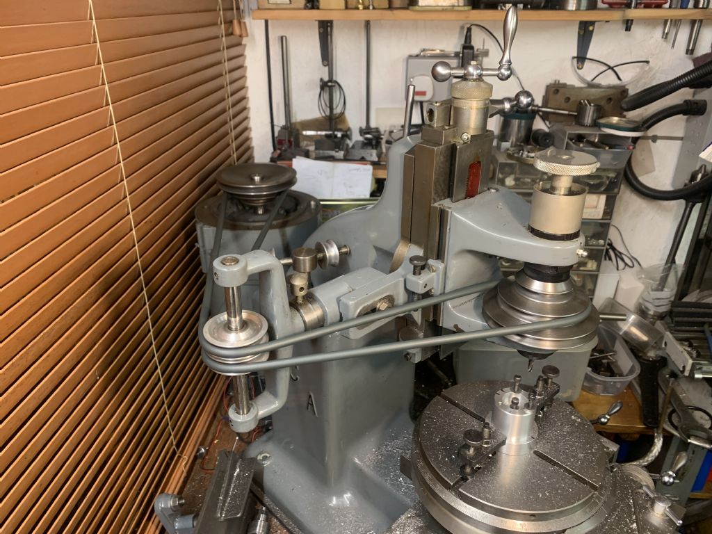

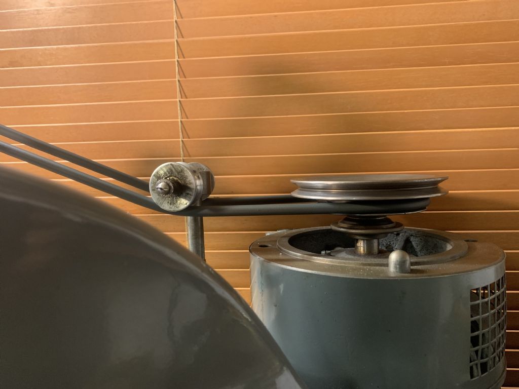

          Hello Steve
          Me again! I think the following pictures should explain better than words:
          Any questions, please ask, I have/will update the pantograph drive pictures thread aswell.
          William

          Nigel Graham 2
            @nigelgraham2
            I have one of these (that a bit of Dorset Echo in one photo..? .) and I must admit that the rear pair of pulleys confuses me, though I notice you have the belt passing under them in one or two cases. On my machine the belt usually runs clear of them, but in any case they never seem aligned at the belt angles.
            Mine came with a rather dubious inverter to power its original motor so I replaced both with a new motor and controller (Newton Tesla) but I was careful to fit the original pulley, and in its original location including height. I had to make an adaptor plate for the task.
            Nevertheless, whether those jockey pulleys do any jockeying seems to depend on their mood at the time, and I am not sure if that is natural.
            I am not convinced either, that the tensioning spring does much, but I have noticed that even when the tensioner is out at its maximum, the belt rubs slightly on the body of the machine if used on the lowest speed spindle pulley.
            I suppose it's possible the belt on my BCA has stretched with age. I've not tried asking Tenga if replacements are available but if their collet prices are a guide, they won't be cheap!

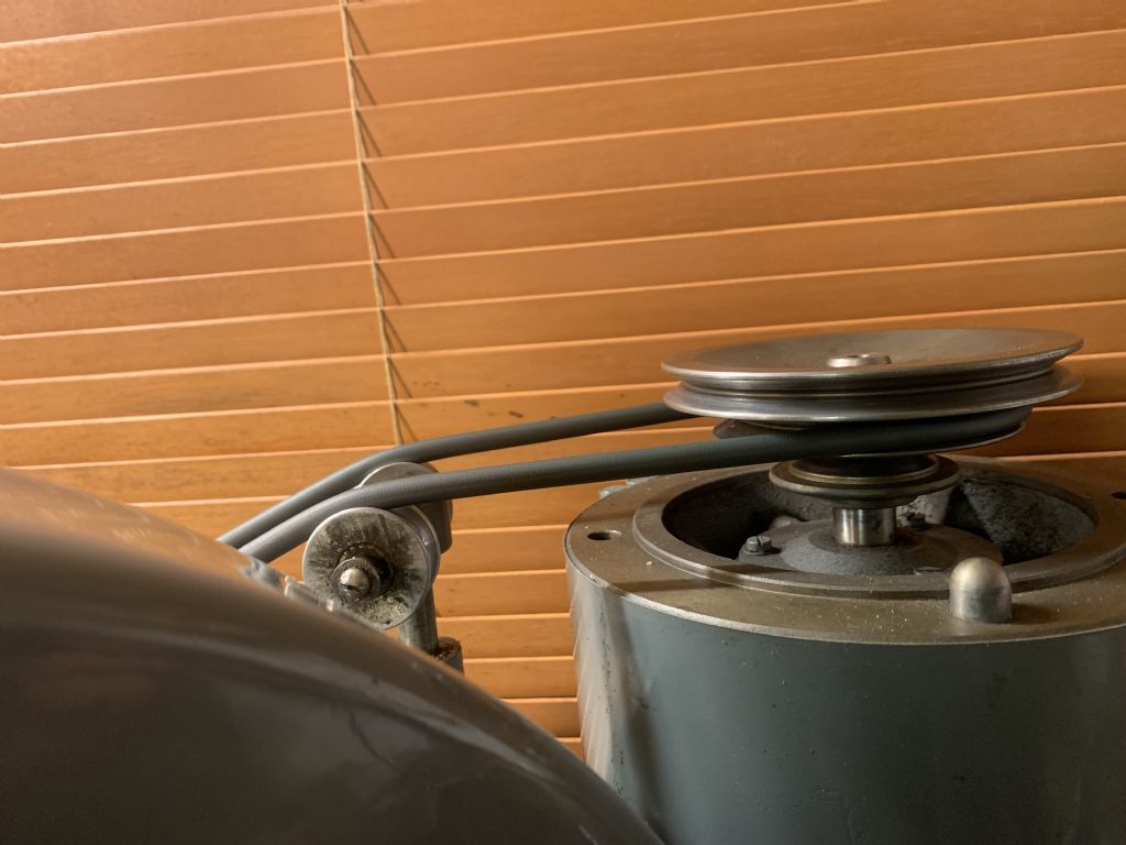

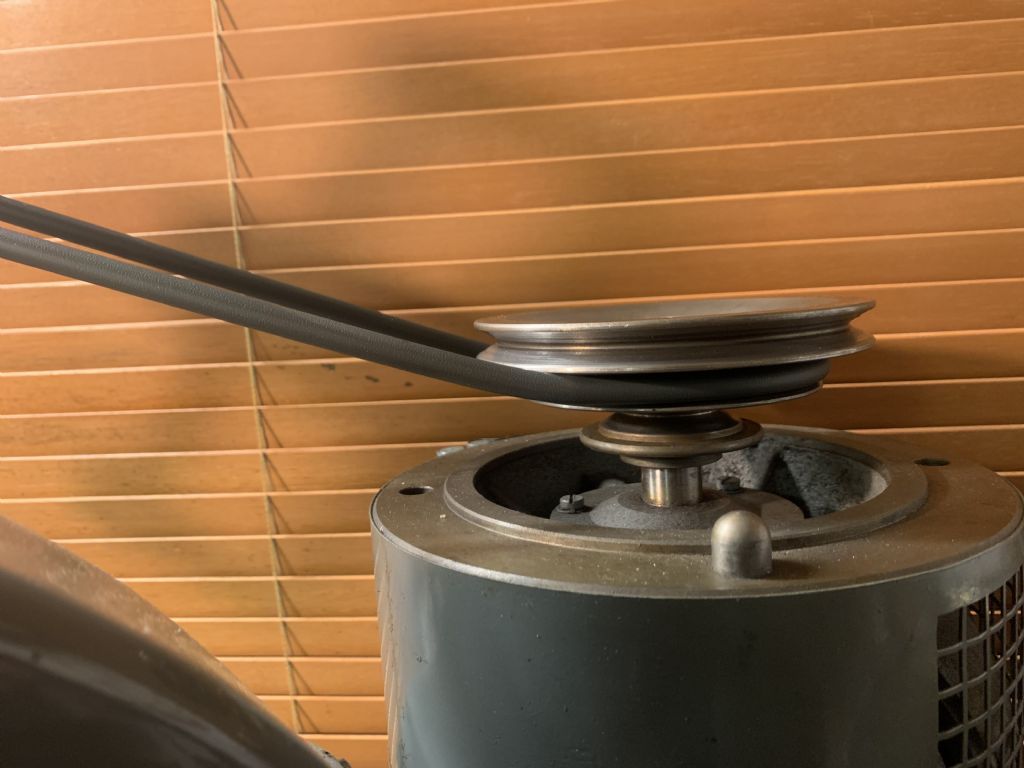

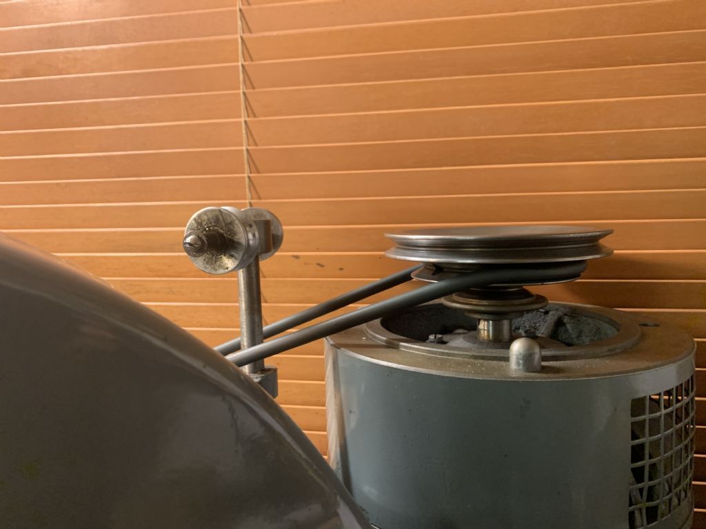

              William S
                @williams
                Hello
                The rear jockey wheels that I have run the belt over and under in some pictures are only to be used when the head is tilted, not when vertical. As I demonstrated they are there to keep the belt square off the motor pulley.
                The newspaper is a Waitrose own brand thing, it’s the only plentyfull supply of free good fire lighting paper(and bench protector)!!
                Even with the original motor the belt does stilll rub on the headstock casting on the slowest pulley combo, however on my previous machine which had a longer belt and a smaller diameter it didn’t.
                The spring does seem to work on my machine, better than my previous machine, it has to be the right length too long and when the belt is released it launched the pulleys across the room! The spring in the machine above is perfect as the belt can be totally removed and the assembly remains. I do still have belt slip when using a slitting saw not that that is an issue, saves the saw blades!
                Yes Tenga are not cheap, but nor where the machines back in the day, mine in 1977 with all the tooling I have would of been around £14000 in today’s money!
                William
