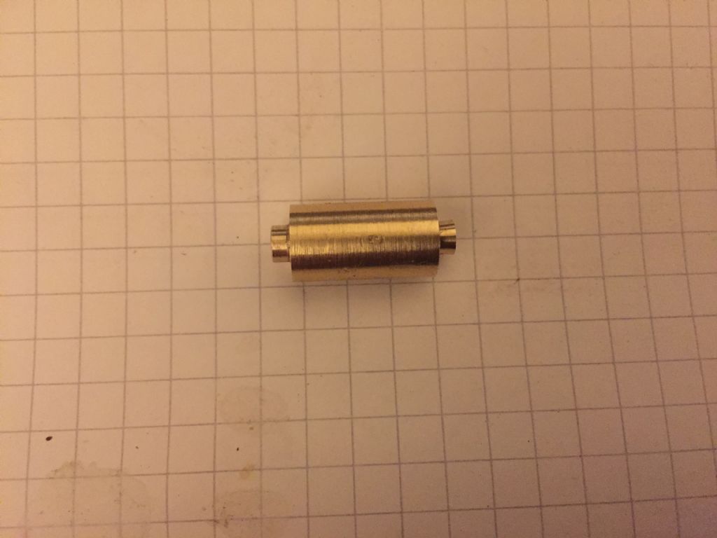

      I want to make a small batch (maybe 12) of rollers like this:
      I would like to get the width of the rollers between shoulders to 15mm +0 / -0.05mm – the prototype in the pic is actually within that tolerance despite appearances – either cr@ppy graph paper or a trick of the camera!

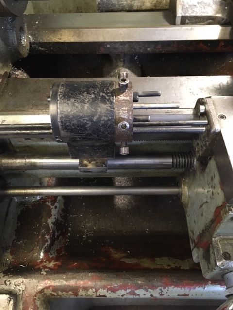

      How would folk go about it? I have a carriage stop which is good to better than +/- 0.01 mm (according to the lathe DRO) and also a backstop which I made a some time ago:
      I fouled up on the design – the first and only time I used it the MT got well stuck in the lathe spindle and it was the devil of a job to get it out – I hadn't made any provision for extraction. I could ( should) re-machine it to correct that, but I'm not convinced it would work for this job. The chuck jaws are 50mm deep so I'd have to make a longish slender extension to the stop. Is it likely that I could hold the tolerance I want with this arrangement if I sort out the design of the backstop? Or is there a better way to do this?
      Robin.

            How the lathe carriage stop is used is key. I have a 4 position carriage stop so I can set up all 4 stop positions in advance using a test part.
            If using a fixed stop, make a spacer equal in thickness to the length of the spigot. Hold the spacer against the fixed stop when facing off. The stop without the spacer will control the length of the spigot. Reset he fixed stop to get the correct shoulder to shoulder length. Do the second end of the part in the same manner as the first.

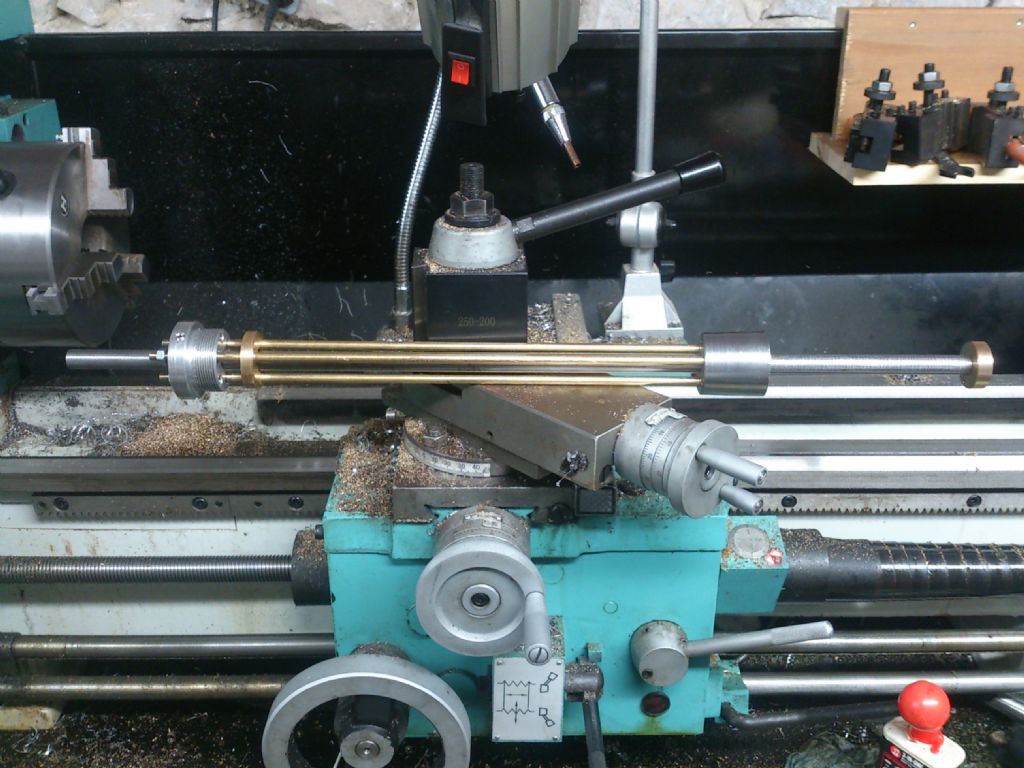

                                        This is the sort of job the multi-position bed stop was invented for. Especially useful if you have a QC tool-post and longitudinal travel dial on the apron or, better, a DRO.
                                        Here is mine :-
                                        I use the apron dial to set the stop positions for workpiece extension from the chuck or collet for both turning operations and parting off as I don't have a DRO on the lathe. Big advantage is being able to do the whole job in sequence on the parent bar before parting off. I'd use a collet for that job as my spindle is native 5C and I have a full set of collets to fit.
                                        I use the Morse Taper drill carrying block out of my Dickson QC to set-up initial workpiece extension. Side is flat to close limits so it makes a nice solid work-stop. As I have the device might as well use it for something! (Also use it for setting the tool-post square to the tailstock barrel. Yet to meet any Home Shop person who actually uses one for its intended purpose tho'.)
                                        With this sort of step turned job I find it worthwhile to take the time to adjust tool projections so that the final cuts are made with the cross slide dial reading zero. Easier with a decent DRO as they all seem to be able to store multiple zero positions. Assuming you have the discipline to switch zero position number when changing tools.
                                        Habitually setting up to finish on dial zero is an effective way of limiting the number of "Oh bother. Took off too much!" moments.
