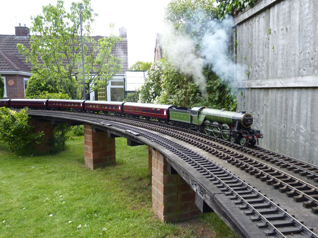

                    #247113
                    IanT
                      @iant
                      Couldn't find a photo of a B/L 'Scotsman' with the teaks I'm afraid Derek but here is an example.
                      Gauge '3' Members are a very friendly lot and you do not need to build your own track to be able to run your Flying Scotsman… so you are certainly not alone…
