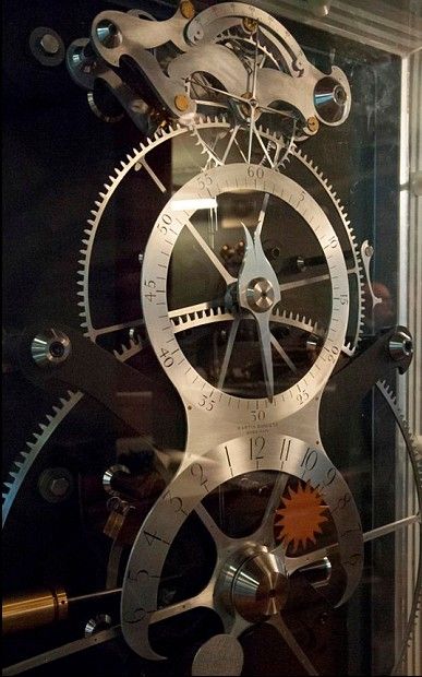

      There isn't much room around them Russel. I have seen various sizes at the odd clock fair I go to but the colour of the "new" ones is hopeless and would never match. The seller pointed out that it would be a problem, Easy to make a replica but he reckoned I would never match the colour. The alternative would be to put something entirely different there but I don't think that would work in the case. It didn't on the one in the hall but that is a very cheap old clock. The colours don't match and the addition looks cheaper than the clock.
      Following Michael's comments I had a look around at true regulators. One thing that surprised me was that they date from 1800 plus or minus rather a lot and scarcely any example photo's about at all. Just shots of the face showing the separate hour, mins and seconds dials. The mention of this one earlier in the thread has fascinated me
      2 aspects. The general construction and the use of dural. Interesting to note that it uses an electric remontoire that winds every 30 sec. That seems to be done by the wheel that looks like it's the escapement but that seems to be behind it.
      Also serves as a shot of a real regulator but the hour dial is rather unusual.
      Edited By Ajohnw on 17/04/2016 13:31:09

        Well that's Burgess' Clock B at the Greenwich Observatory, hardly 19th century as it was finished in 2013! Has been running for 2 years in the Clock Workshop and has never been more than a second adrift from exact time. It demonstrates what Harrison's grasshopper escapement is capable of when properly implemented. There have been two seminars held at the RGO on the clock and I had the chance to have a close up look at the second. However it isn't perhaps a "basic clock design"!
          I seem to remember the electric drive to the remontoire was really simple – no clever escapement. Are you looking at the right thing – I think the remontoire weight is brass lump at bottom left of picture.

              Jack, John, the brass weight drives the great wheel through (IIRC) a differential arrangement so it can be lifted by the winding motor every 20 minutes (this is from Frodsham's website). The remontoire is essentially a spring arrangement behind the escape wheel (at the top of the clock) which is itself rewound every 30 seconds. The main rerason for the remontoire here is to keep the drive torque to the 'scape wheel, and hence the pendulum impulse, as constant as possible and isolated from variations introduced by inaccuracies and stiction in the train.

                      The weight drives the hour wheel, which drives the minute wheel, which drives the remontoire input, which drives the scape wheel through a spring mechanism. Actually it's quite a simple clock apart from the grasshopper escapement. The dural is I think mainly the dials and large wheels, the backplate is a massive 1 inch thick mild steel plate and the cocks and bridges also steel IIRC. The construction was described at the seminars by a man from Frodshams but for some reason the RGO has chosen not to publish the slides. It's a big clock too, must be a metre and a half tall.

                                  I was wrong. But, the motor driven weight could be a nice simple solution for Jame's clock.
                                  Can the motor driving the brass weight be considered a form of remontoire or are there some conditions it doesn't meet in order to be considered one? e.g. does it have to be supplying power closer to the escapement?
                                    "a form of remontoire" … I would say Yes
                                    [Note: I did try to keep that broad definition when I mentioned it earlier]
                                    A good recent example is included in John Reynolds' "new design of" Regulator which is being published in EiM and has been completed in HJ.
                                    P.S. … Harrison did not have the luxury of electrical rewinding available to him … but I'm sure he would have used it if he could !!
