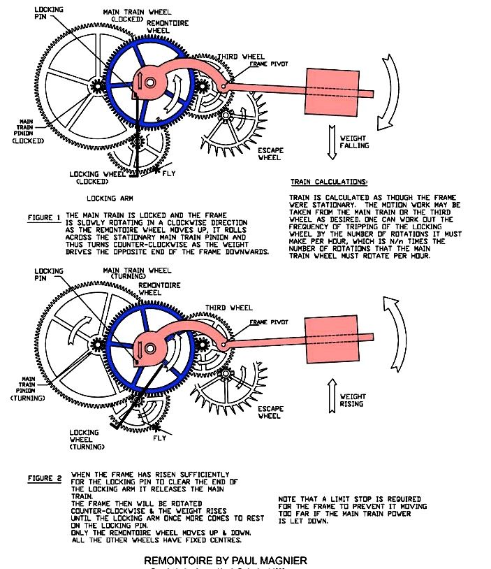

                I have looked at remontoires, but, to be honest, am struggling to see how they actually work. Fascinating though they may be, I do not envisage building one into this design. Similarly, I have considered other types of escapements, such as the grasshopper design, but, again, this looks a trifle fiddly to start with.

                  I have looked at remontoires, but, to be honest, am struggling to see how they actually work. Fascinating though they may be, I do not envisage building one into this design. …
                  James, and jaCK,
                  If I led this discussion off-topic by mentioning the remontoire, then I apologise.
                  There are two different reasons that one might use a remontoire (a) to improve the timekeeping of [typically] a spring-driven mechanism, or (b) to reduce the physical loadings on a weight-driven clock.
                  It was for reason (b) that I suggested James could use an electrically powered remontoire [call it electrical rewinding if you will] and thereby retain the advantage of weight-drive in his lightweight skeletal frame.
                  Again; apologies for any disruption …
                  I will observe with interest, but not interfere any further.

                      Michael. I appreciate your suggestions and whilst I may not use a remontoire, reading the links has given me plenty of other things to consider, especially friction losses. Please keep the suggestions coming.

                                Posted by Michael Gilligan on 14/04/2016 23:32:47:
                                laugh
                                … but I think this variant offers a much better solution.
                                Michael,
                                That is the type of design that I envisage: thank you. By coincidence, although I have not seen that clock before, the plans that I have bought for my first clock are from the same person.

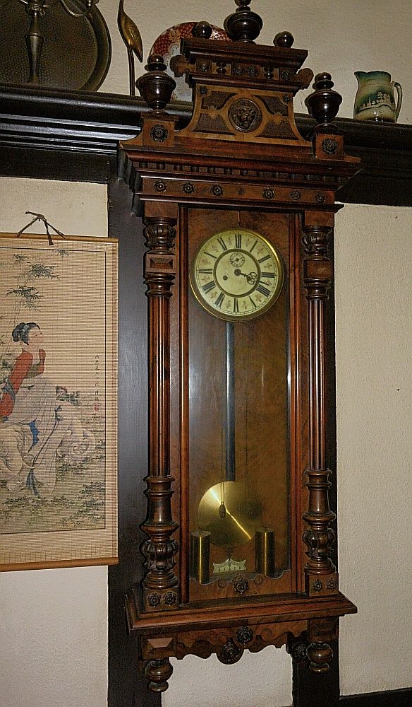

                                                That I think is one of the ways Peter Heimenn suggests for the clocks he deals with in his book Russel which he reckons will hold 2sec per week. The book is called "Regulator Clock Construction". He gives 2 designs in it. Personally I think it's pretty good value compared with some.
                                                My challenge is this beast.
                                                I don't anticipate any problem with the mechanism but the 2 missing bits will be a challenge. The worst one being getting the colour of the "rose" shaped part correct. The tiny bit of missing woodwork may not be such a problem. The missing rose can be made from a plaster casting but getting the colour to match is another matter.
                                                laughWe're not minimalists here by the way in case some one doesn't notice.

                                                  John,
                                                  You are probably aware; but I should mention [for the benefit of any novices reading his hread] that a 'proper' Regulator differs greatly, in construction and performance, from the typical 'Vienna Regulator' that you are having trouble with … 'though they do both have their place.
                                                  Now:
                                                  When I worked on my Mother's Vienna, it ran beautifully in my test stand, but was very troublesome when returned to her. … The reason turned-out to be that the glue holding the case together was failing … The flexing of the case robs energy from the pendulum. crying 2
                                                  #234884
                                                  Ajohnw
                                                    @ajohnw51620
                                                    True Michael but the usual term for them is Vienna Regulator. They can keep good time as well. The book I mentioned contains two regulator designs. Much plainer animals although the month going one does show the movement fairly well.
                                                    An antique dealer sold it to me because of the 2 missing parts as small as they are at a very reasonable price all things considered. Having just checked ebay prices I am even more pleased with that aspect as it is basically sound.
                                                    We have another much smaller one in the hall that was very cheap – the top decorations missing. That one really should go in the bin as even with something suitable on top it just doesn't match the rest of the clock.
