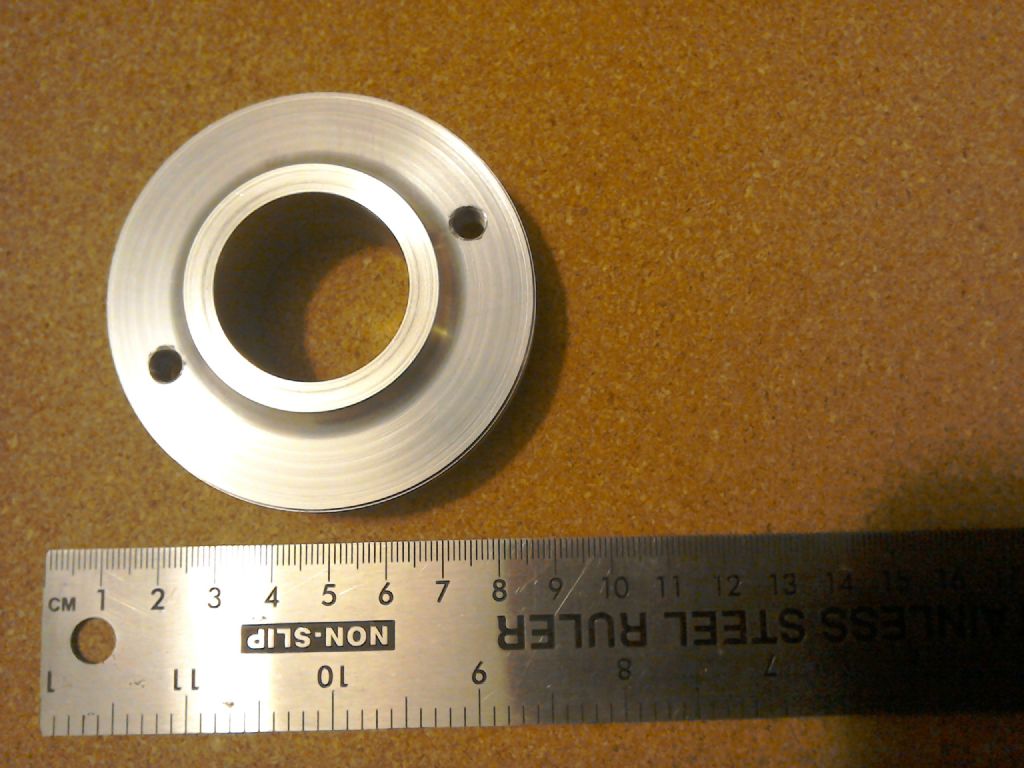

                    Martin Connelly
                      @martinconnelly55370
                      This shows concentric banding on an aluminium alloy part cut with 0.2 depth at 35mm/min using a 0.2mm radius tip insert 800 rpm. You can't feel the banding and the lighting has to be just right to see it which is why the photo is lop sided. It polishes out with very little effort using some well used scotchbrite. The banding matches the cross slide lead screw pitch. I have not polished the part since it needs further work in the mill which will remove a lot of the face showing the banding.
                      Martin
