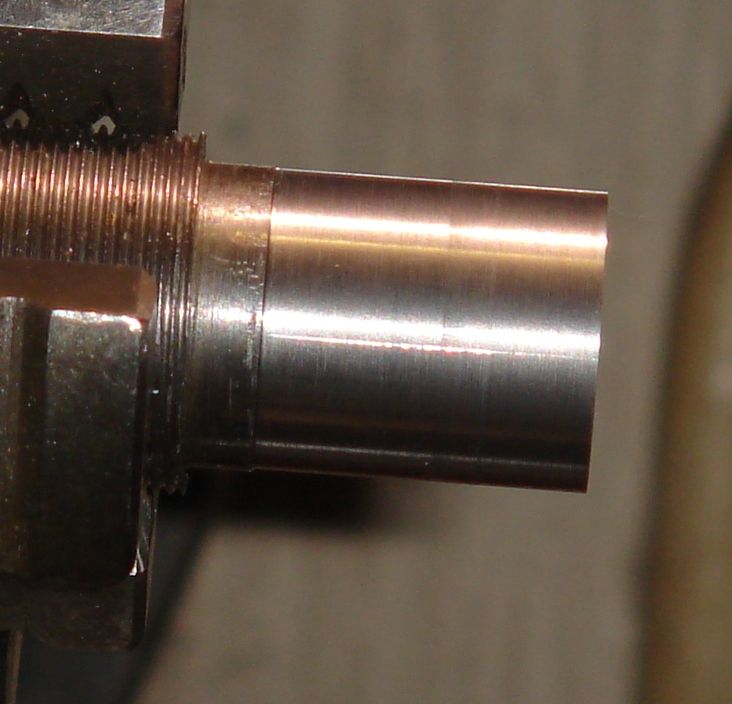

                                      I have an example of what vibration can do. This is what happens when my boxford bearings have warmed up.
                                      It's silver steel and no doubt some will think what a crap finish but it isn't. It feels like glass and the shot is larger than life size.
                                      There is a vague repeat pattern. I reckon it's caused by a wobble on my countershaft pulley. It's a pretty big one on an ME10 and it has about 1/16" + wobble. The same cut was run twice to get this but all the 2nd cut did was take a tiny amount of the end and make the pattern a little clearer. The cut was also pretty light. The effect on the end is probably down to the feed rate changing a touch as play is taken up.
                                      What's being seen in the shot is features that probably aren't even 1 um deep. The same sort of thing can happen due to changes in the hardness of the material that is being turned. That usually produces rings that are obvious and spaced further apart and usually down to headstock bearings being past their ultimate best.Heavier cuts or a faster feed usually get rid of those.
                                      The problem really apart from wear is that the tiniest deflection of the work or the tool can show. This is why on some lathes heavier cuts can help. The cutting forces produce enough deflection to make any other causes too small to show so well.

                                          Super 7's have been know to produce immaculate finishes Michael. Truly amazing ones. The better it gets the more apparent very minor defects can be.
                                          I've also got a shot of the same piece of silver steel turned without giving the bearings chance to warm up. It just about shows some rings down to the bearings and material / feed variations but most likely material.
                                          The pattern isn't so marked and the light reflections show that the finish is worse. Increasing the feed rate may have given a better finish.

                                                A photo would help. Best lit with some reflection to give some idea of the degree.
                                                The fact that they match the leadscrew pitch is rather unusual – in my view. It suggests movement on each revolution of the leadscrew. Larger work may provide more load and prevent it from happening. It really and truly isn't unusual for machines to produce different results due to cutting loads.
                                                I think I would be inclined to look at the saddle fit as well. Also check somehow that the leadscrew isn't angled to the bed. It could be running true but if the bearings are miss positioned it wont be true to the bed. A tighter saddle fit might mask that problem. If it's a severe problem with the leadscrew you might be able to detect it by using the handle with the drive to the leadscrew disengaged.
                                                From my memory the spindle pulley set up on a Myford is cast iron. Vibrations there could cause problems but not ones that match the leadscrew. I can't see how they could anyway.
                                                If the work is bending running the same cut again usually shows that is happening but make sure that there is sufficient feed on before it takes the 2nd cut. Saddle fit can make the tool move away from the work when the saddle is wound back.
                                                A travelling steady set perfectly more or less takes the rest of the lathe out of the equation. A principle much used on production capstan and auto lathes. Everything on them can move all over the place on these when the work gets into the cutter box and they still produce perfect results – usually with a rather heavy cut. I was gob smacked when I saw just how bad the rest of the machine could be.
