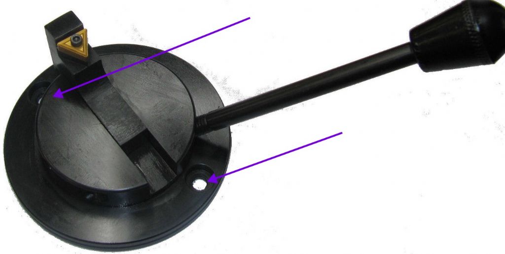

        Hi, has anybody had any issues with mounting a ball turning tool to their lathe? I have a Chester DB8VS lathe and recently purchased a ball turning tool from RDG. However it doesn't fit, as the centres on the lathe are about 5mm inboard of the centres in the ball turning tool. I did assume that the centres would all be standard as they are never given on the tools description so I just took the chance and rather annoyingly it didn't pay off! When I remove the topslide, the lathe has 85mm centres and the tool has 90mm so it's really close, but just won't fit properly. Is my only option to open up the holes on the tool or is there an easier way, surely I can't be the only person to have hit this problem but I can't find anything from a forum search. Ideally I don't want to have to open the holes up because the tool doesn't rotate on a central pivot, but on the 2 mounting bolts so could end up very easily not sitting central about its rotational axis. I don't think there's an easy option but it's worth asking in case I'm missing something.

                      Sorry gents, maybe I've not explained the problem well enough. My problem is that the mounting holes for the tool are 90mm centres and the mounting in the cross slide is 85mm centres.

                                    I had a similar problem on a similar ball turning tool, just drilled two new holes at 90deg to the existing ones.
                                    Would that work for you?

                                        Is there room to drill out the mounting holes and replace with eccentrically drilled plugs?

                                          Posted by Daggers on 12/10/2021 10:36:59:
                                          Daggers, that's probably the best shout. I'd considered opening up the current holes but not just re-drilling new ones in another position, I guess it doesn't actually matter where they go as the bolts slide in the slots anyway. The holes will get close to that upper (smaller diameter) portion of the tool but I could always bring it in work and get it CNC milled to put a clearance cut in that bit as a drill would just wander when it hits the edge and I need to be able to get a nut on too. Thanks for the suggestion, it's good to know other people have had similar issues.

                                              There doesn't seem to be any reason why the holes have to be symmetrical, so can you just drill a third hole on the same pcd but moved round a bit so it is 85 from one of the existing

                                                Good point Duncan. I have been debating if it needed to be central. At first I assumed that it rotated on the mounting bolts in the same way that the top slide does when they are loose. However, on second thought (I haven't got the tool to hand and can't remember) it must rotate about it's own axis on an internal bearing/close fit. Therefore, as you say, it wont matter if it doesn't sit symmetrically on the cross slide.
