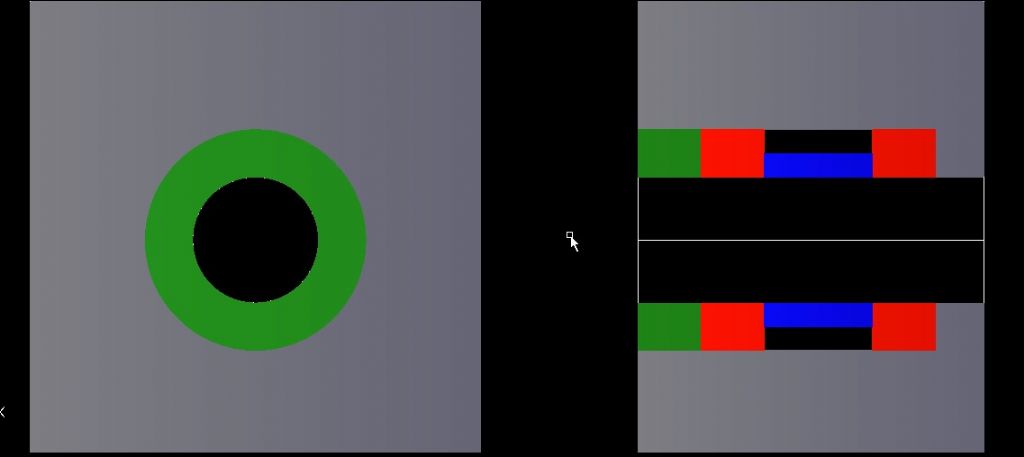

                      Here's what I'm thinking of, this is a tender axlebox. Just realised I should have drawn the hole blind, not through, but you get the idea.
                      Green is a viton lip seal, red are ball bearings (2 per box), blue is a spacer for the internal races. The loco boxes would have a viton seal each side.
                      Not shown are oil plugs top and bottom. The gap round the spacer would be the oil reservoir, boxes would be filled after fitting on axles but before fitting into horns. My intent is that with the oil sealed in, it cannot escape while dirt is kept out. I'd have to drop the wheels out every so often for oil check/change.

                      Speedy Builder5
                        @speedybuilder5
                        So what happens if the left hand wheel tries to drop further than the Right hand wheel ? I would have thought that you would need self aligning races if you are going for that sort of precision.

                        Phill Spowart
                          @phillspowart84010
                          Posted by Speedy Builder5 on 03/03/2018 18:15:13:
                          BobH
                          The clearance in the hornways would allow for that I think? It's how I've seen it done on full size narrow gauge practice. This is why I'm posting though, far easier to find the flaws before I build it

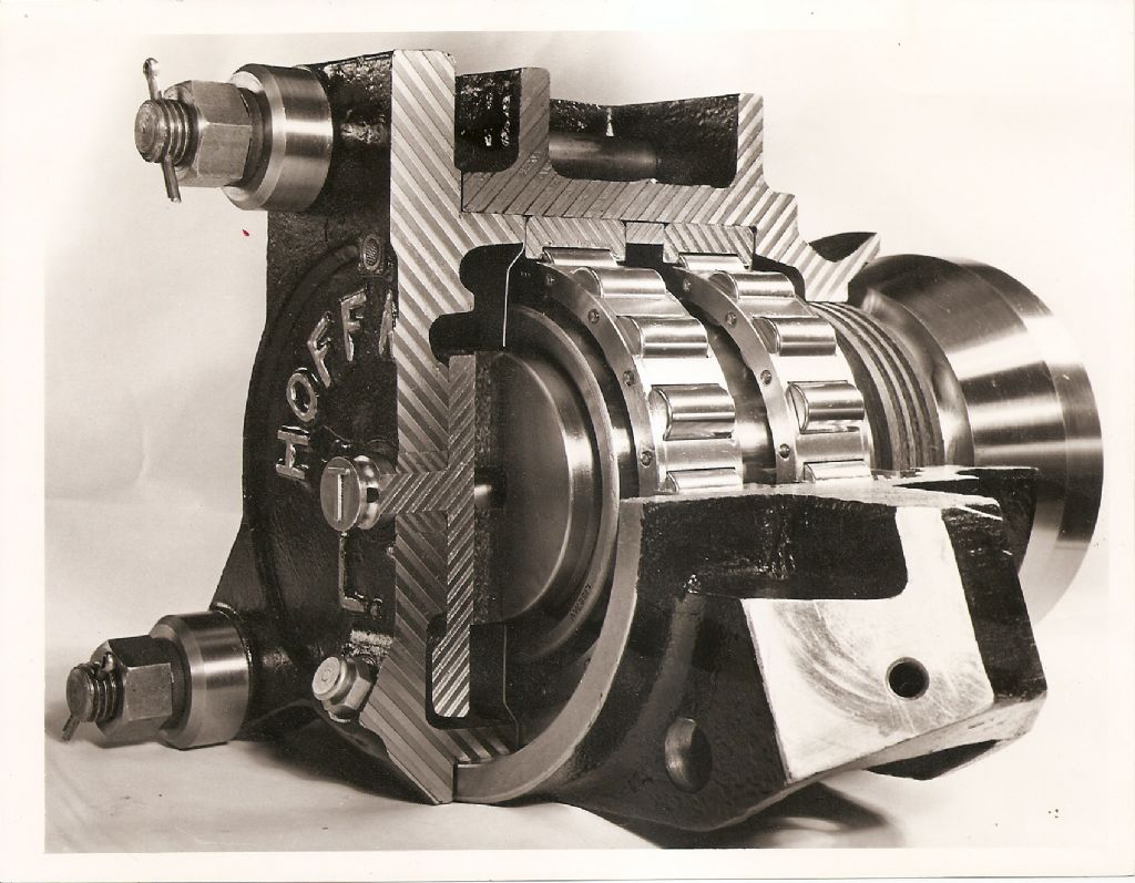

                            gerry madden
                              @gerrymadden53711
                              Here is a typical Hoffman axle box. This one was fitted to underground stock but the internals were the same on boxes fitted on things such as the Class 31. The two rows of rollers carry the journal loads and the bronze pads carry the thrust from the axle.
                              #344260
                              gerry madden
                                @gerrymadden53711
                                oh and they are grease lubricated, yes, including the thrust pad !
                                ps this picture isn't very good I wonder what I'm doing wrong…..

                                  Thanks for that. My thinking is that the ball bearings will take the side loads, but other than that it looks pretty similar?
                                  #344264
                                  gerry madden
                                    @gerrymadden53711
                                    Yes two ball bearings side by side will be absolutely fine in your case. Its sensible to put a small spacer between the inners. Just be careful that you don't nip the outers when you secure them axially. I wouldn't bother with oil though. Use ball bearings with a single metal shield and position the shields on the outsides.

                                    Phill Spowart
                                      @phillspowart84010
                                      Yep, was going to keep the outer shields on the bearings, with the separate seals as well it should be leak proof.
                                      I was thinking oil would give less resistance, and be able to flow better into the bearings. In full size the grease gets forced in by gun, whereas I have no intention of making a 1/16 scale grease gun!

                                      gerry madden
                                        @gerrymadden53711
                                        The picture wasn't so clear in the earlier post. So here it is again. A little better I think.
                                        Regarding grease, yes there will be a little more friction than with oil but it will still be small compared with your seals. And once the grease in the bearings has 'channeled' (might take a few thousand rotations) the friction will drop to a level much closer to that of oil anyway.
