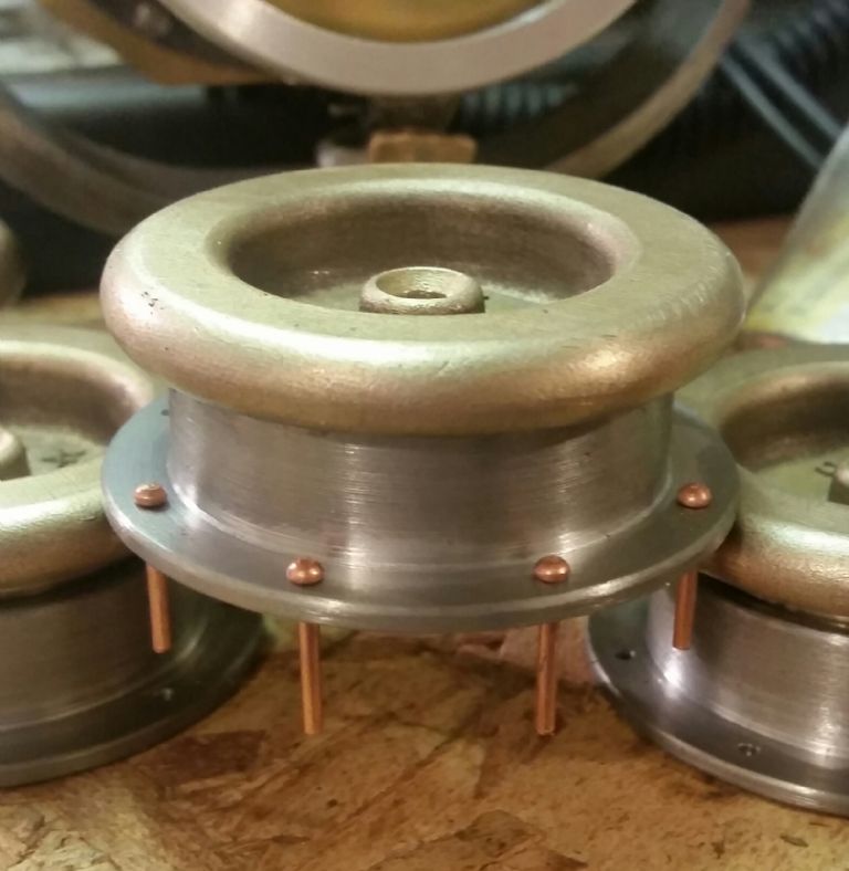

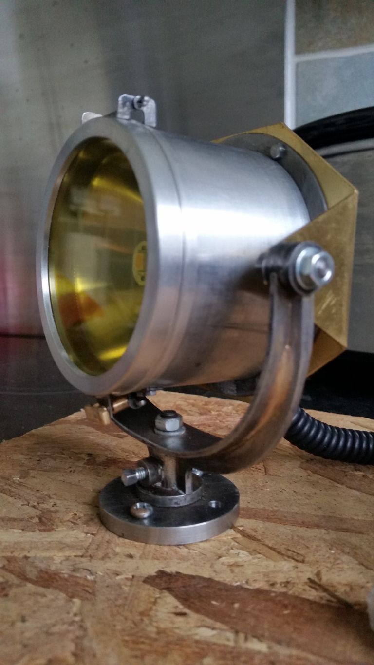

      I have just finished a pair of these lamps for my Baldwin 50HP gas mechanical. One sat on the "hood" in front of the chimney and the other hung from the rear underside of the cab roof. The body is turned from solid corrosion resistant aluminium alloy.  The bit of wood was so I could take them to the Work in Progress night without risk of damage.

        OldMetaller
          @oldmetaller
          Nice work Steve…what scale are you working in?

          #228384
            Very tidy, Steve
            LED illumination too. yes

            Steve Addy
              @steveaddy35670
              Thanks guys.
              It is 7.25" gauge which converted from 600mm gauge I make 3.26" to the foot. Not an ideal scale. The LEDs were sourced as filament automotive bulbs will vanish shortly in my opinion and these have a very long life – I bought a spare set too!
              The lamp body is 72 of 73mm diameter I can't remember which.

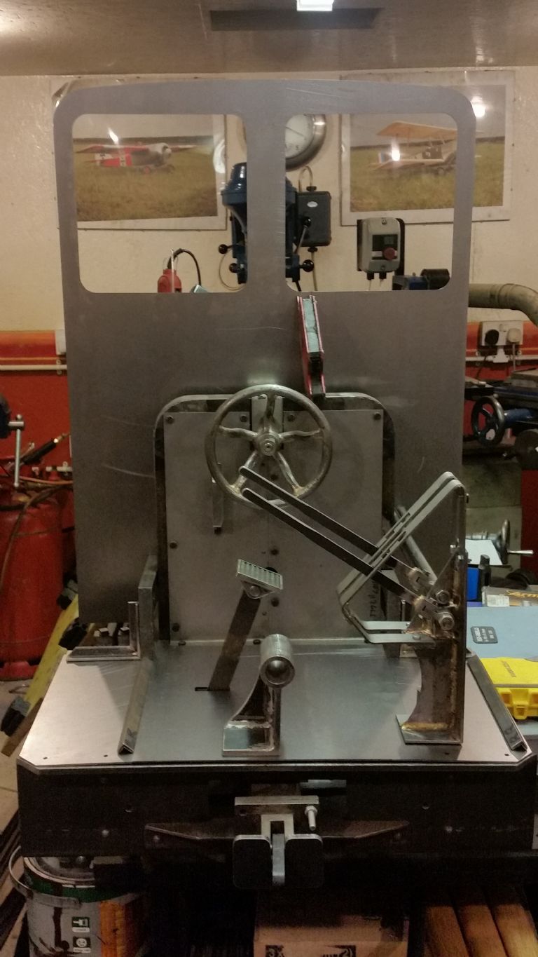

                Here is the "office" at the present state of building.

                OldMetaller
                  @oldmetaller
                  That looks really interesting Steve- I hope you'll post your progress occasionally. That is very much my kind of model engineering!

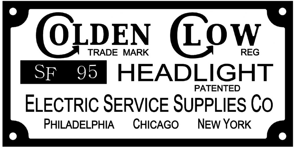

                              Further to these lamps. I have drawn the manufacturers plates in 3D. These have been printed in wax in New Zealand and investment cast in silicon bronze. The detail level was at the edge of the printing capability. I have made a jig to bend the plates to fit the lamp body. Pictures hopefully in a minute.

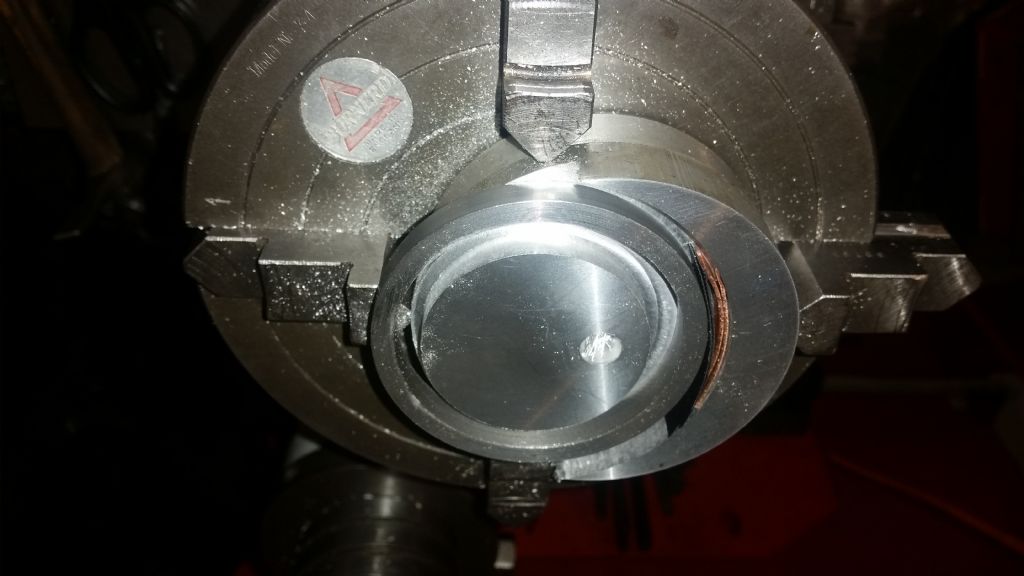

                                Jig as milled in dividing head, the spindle is actually vertical

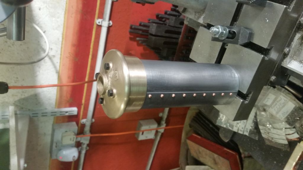

                                    Investment cast chimney top and chimney tube turned from solid 70mm bar

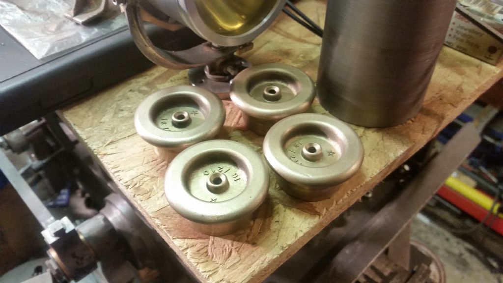

                                    Steve Addy
                                      @steveaddy35670
                                      Investment cast silicon bronze sand fillers

                                      #278394
                                      Steve Addy
                                        @steveaddy35670
                                        Sand filler with turned angle ring, ready to mount on tank/body

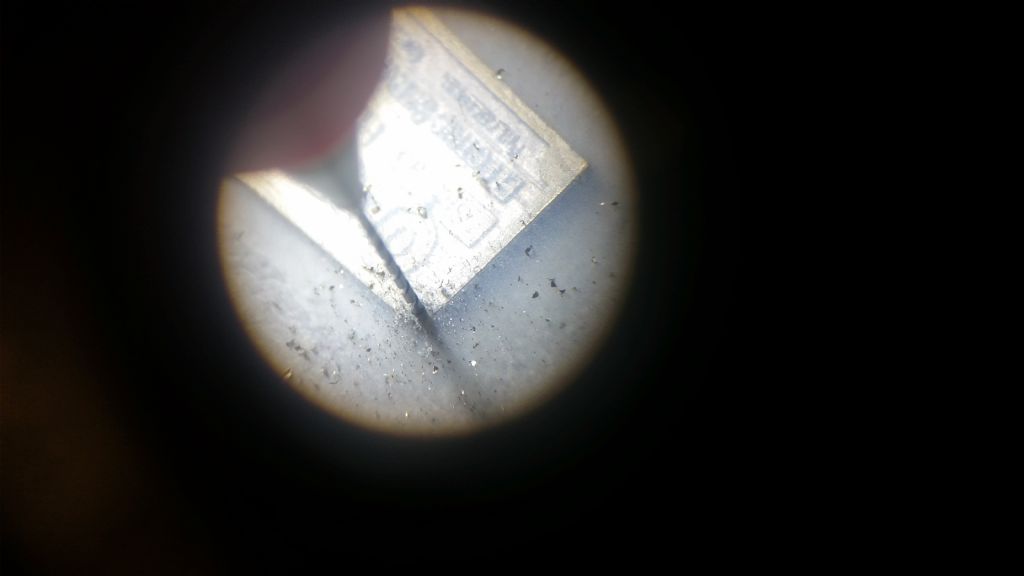

                                        #278396
                                        Steve Addy
                                          @steveaddy35670

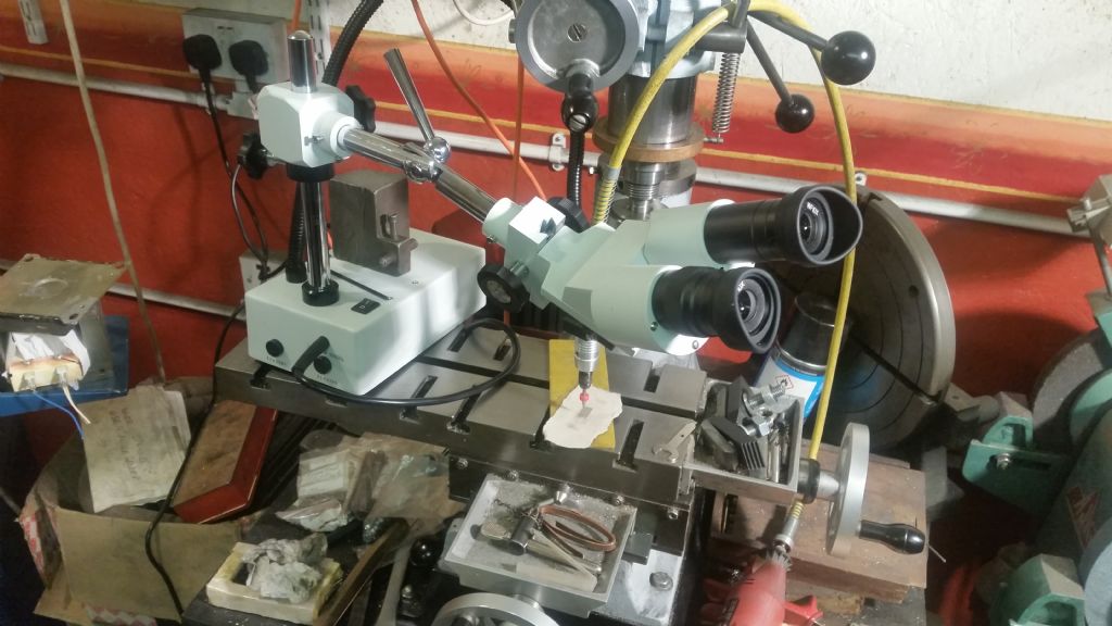

                                          Drilling lamp plates with 0.4mm carbide PCB drill, view through microscope

                                          #278399
                                          Steve Addy
                                            @steveaddy35670
                                            Microscope on Dore Westbury. Drilling spindle is a Proxxon flexible drive held in a drill chuck in a modified tool post holder. You can just about see the plate I was drilling, taped to a bit of card.

                                                This is an image created from the CAD model, the lamp plates are roughly 14 x 7mm. The black parts are raised with respect to the white parts. The model number was stamped on the prototype.

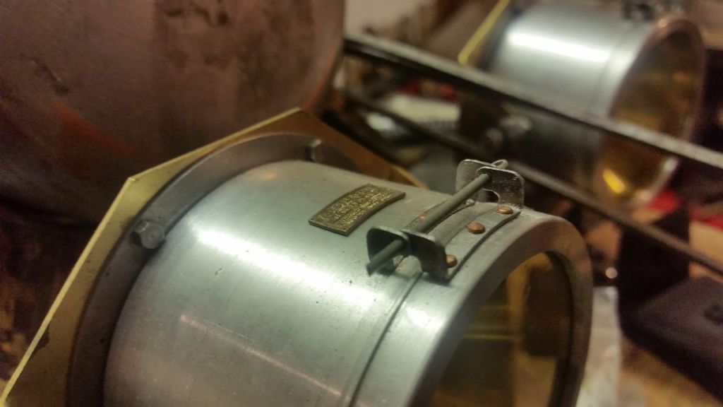

                                                #280368
                                                Steve Addy
                                                  @steveaddy35670

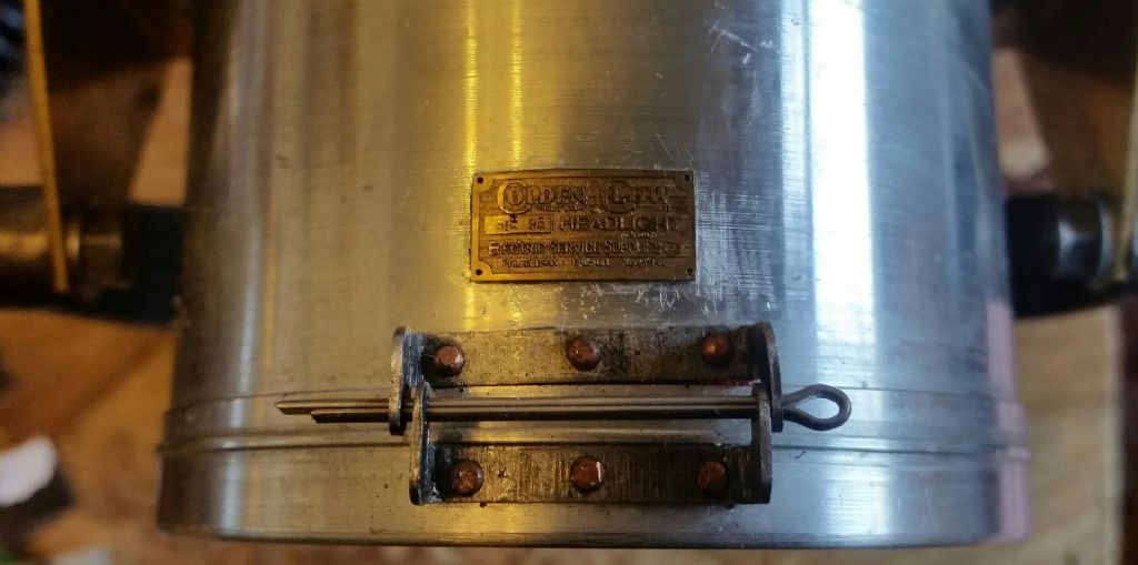

                                                  Aforementioned Lamp ID plates finally fixed to the lamp bodies. The rivets are 0.5mm AF hex on a 0.3mm shank.

                                                      Thanks John – laser cut bits arrived from Malcolm High this lunchtime so I have progressed the chimney this afternoon.  The bottom flange is now finished, but not welded to the tube.  The top spider is drilled and tapped to fix the chimney top and M5 bolts have been turned up to suit.  A bit of welding and riveting is in order now.  I think I'll leave the bottom flange off so I can use it spot the bonnet top though.
