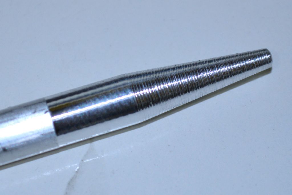

        I'm doing my first experiences with the lathe. This aluminum part was machined at 1500 RPMs lubricated with WD40 and with CCGX09T304 for aluminum.
        As you can see in the photo the finish is not the best. Any clue to what I'm doing wrong?

          Pausing the feed as you reposition your hand causes banding like this. Unless you have a lathe with a taper turning attachment you can't use power feed which would help with finish. You need to practice keeping the feed constant.

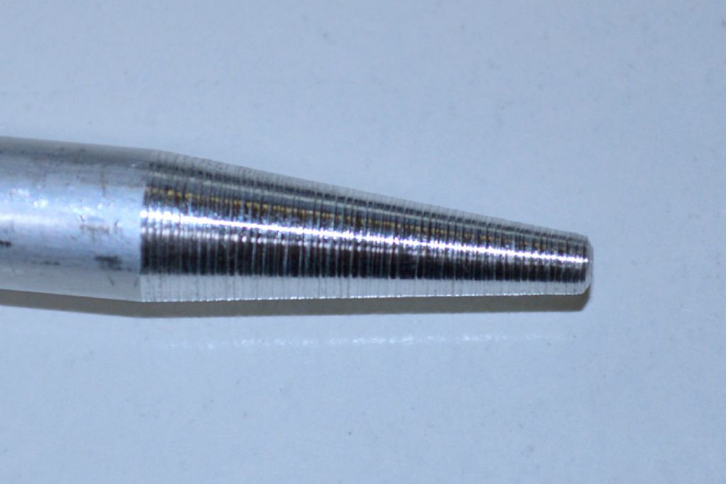

            It seems like I'm going to have a lot to practice. I've tried the power feed and the finish is perfect.
            It is not easy because it does not have a smooth movement, I guess it needs tuning…

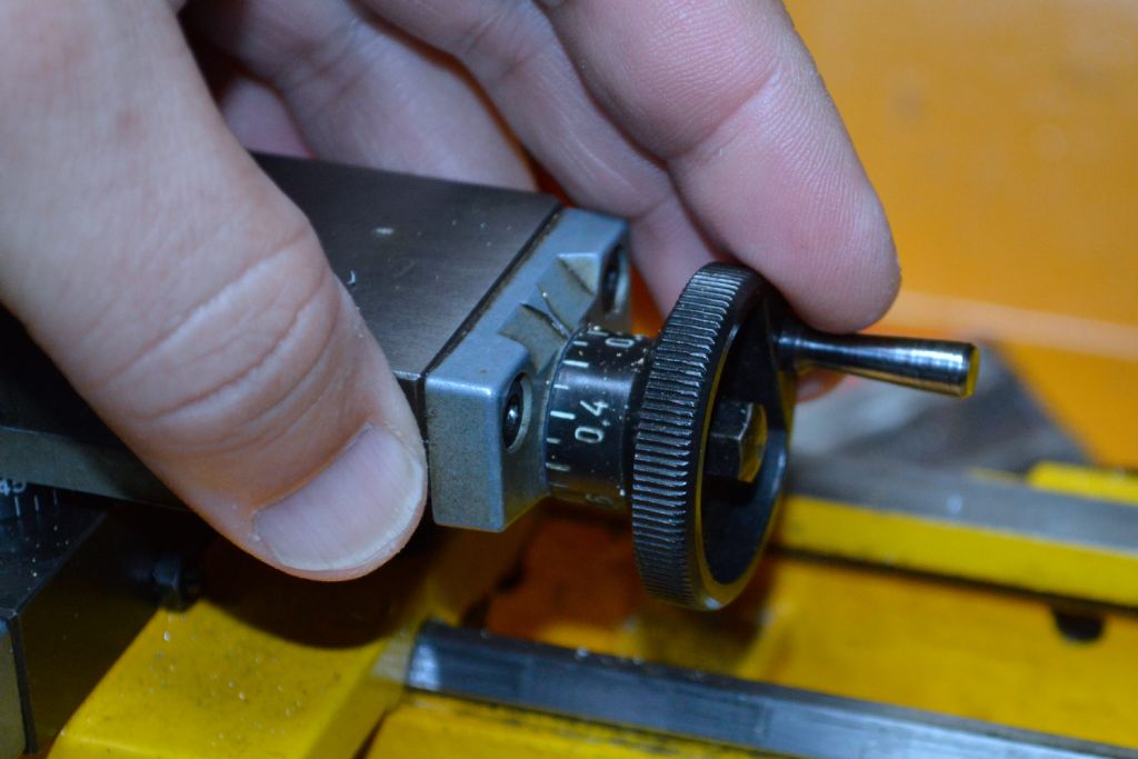

                  It is the feeding that is the problem. It does not have a smooth movement at all and it is very difficult to maintain a constant movement.
                  Maybe I'll fit a small stepper motor. First I will try to fine-tune the movement (and the hand)
                  An EMCO Compact 5

                    I was taught by to feed gently using two hands, use the ring of the handwheel rather than the knob and keep feeding it through both hands a little at a time. Keeping the pressure even on the transfer is the trick. Like all skills it is a case of practice.

                      I've just looked at some photos of the EMCO Compact 5 topslide … I would avoid using the handle on that little wheel [in fact, I would probably remove it]; I think you will get much better control using the wheel as a knob.

                        Not at all convenient …

                          Fitting a stepper motor to a sticky slide is not really the solution. You need to pull the slide off off and clean and lubricate the moving surfaces, remove all burrs etc beforehand, then reassemble carefully and adjust the gib strip adjusting screws until you get an absence of shake but a nice free motion. If you flick the handwheel it should spin freely for half a turn or more after your finger is removed.
                          Then use a two-handed method to continously turn the handwheel without pausing and turn it nice and slowly.

                            I'm with Marcel looks like you were feeding using the handle which tends to lift and then lower the end of teh topslide which gives the regular rings you are getting. This is OK for roughing out but for finished cuts two hands are needed on the wheel rim to give a constant even feed.
                            Also make sure the gib is not loose.

                                              On my top slide I have cut down the supplied handle, about half way. Then fitted another handle opposite, does help in smoother turning.
                                              #267687
                                                Jason has hit it on the nail and others who suggest turning it as a 'knob'.
                                                'Balanced handles' are much better.

                                                  No-one would think twice about using the power feed for plain turning, and the second photo shows what an excellent finish the OP has produced using this method. I can't see a problem using some sort of power feed for the top slide as I'm sure it would produce similar good results. All those advocating more practice at hand feeding – I wonder if you all use treadle lathes
                                                  For someone relatively new to turning, being able to produce good results is probably more satisfying than spending hours trying to perfect a technique that will, in any case, come with time as experience develops. So I suggest a quick try with a hand held electric drill + suitable socket to check that it is indeed the method of feeding which is at fault. And maybe his next project could be to make a motor drive for the top slide.

                                                      Agreed … provided that the size is appropriate to the user's hand size.
                                                      The photo that VCR kindly posted suggests to me that any type of 'balanced handle' would prove impractical.
                                                      [his best compromise, therefore, is probably to remove the little handle]
