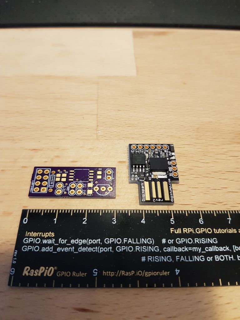

                                    Donovan Kaardal
                                      @donovankaardal43990
                                      I'm a big fan of the ATTiny range from Atmel (well, Microchip owns them now). The ATtiny85 is extremely popular, and you can get ones that people have made into Arduinos if you really want. You could make one yourself and flash the arduino bootloader, or just say to heck with it and program it straight. If you're not going to be changing the program very often, there's no reason to waste the space with the bootloader.
                                      Power wise they can be very efficient, though as was previously said using sleep states or low power states helps with that as well.
                                      Here's a pic of an ATTiny based arduino. I bought a bunch of these ages ago so there may be better ones out there now. This one was called the digispark? The purple board next to it is one I made that uses smd components – this is a wireless temperature sensor, but for this one I'm pretty sure I used the Arduino IDE to write my program, then programmed the ATtiny(s) with a second arduino.
                                      Low power ATtiny info is out there – here's at least one page that is a good place to start: ATtiny low power
