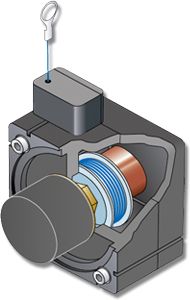

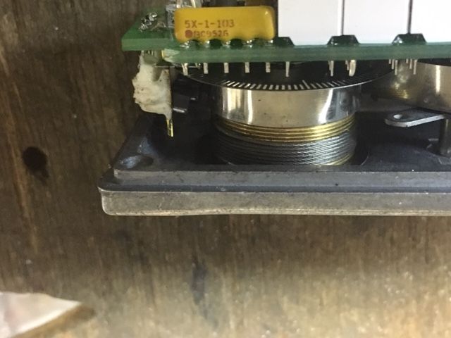

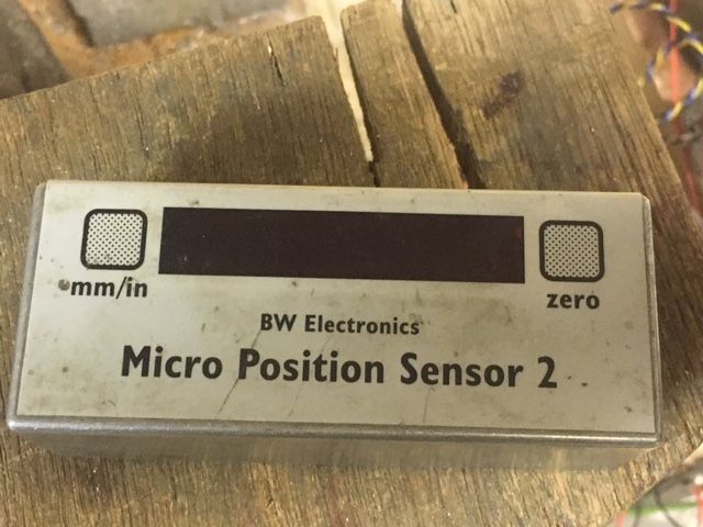

      I have another DRO application but this time I would like to make a draw wire spring return linear encoder but using a rotary encoder in the style of one in the pics from BW Electronics which works well.
      I know there are commercial units units available at suitable prices but before attempting I wondered if anyone had constructed one using an optical (ebay around £8.00) or magnetic rotary encoder?
      Peter

              I had thought of a retractable key ring but realised that I have a few scrap 3m tapes. Dismantled, this revealed a 0.12 thick, 9mm wide return spring easily long enough to try. This I was going to put in a spring barrel at one end. Have two plates with the wire drum in the middle and the encoder at the other end on a ball bearing spindle if you see what I mean.
              Yes that was the encoder I was going to use. It hasn’t arrived yet but I also found this magnetic type which gives a genuine 256 ppr. Could do with a higher count but want to avoid gearing. The wire drum dia is something unknown at present but the BW Electronics version looks to be fairly coarse on the encoder and uses a drum about 0.8” dia. Any guidance on drum dia will be gratefully received!

                        Agree a draw wire sensor not ideal but its not terribly expensive to give it a bash and I used the BW electronics one successfully for years.
