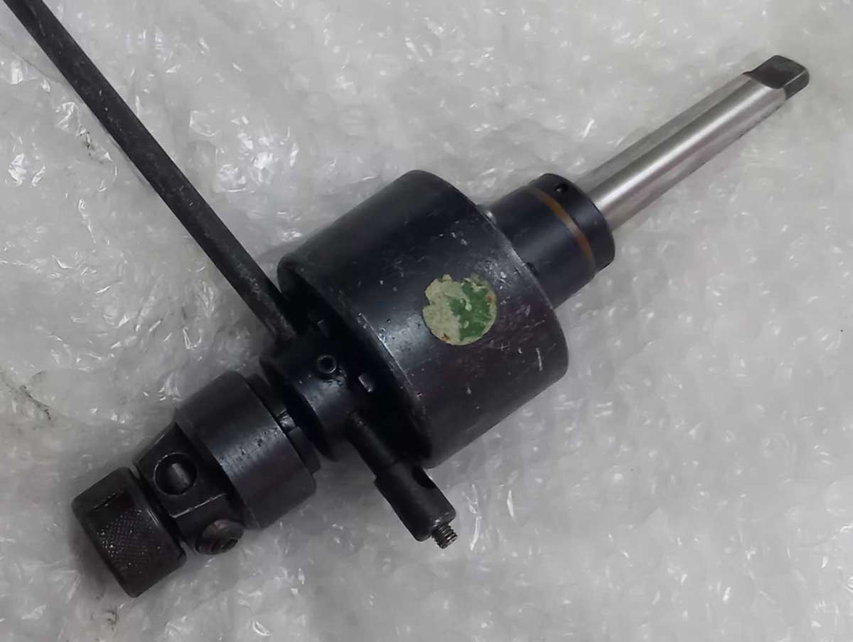

      I bought a couple of Auto tapping heads at a recent industrial auction. They are a fairly modern A STM JSN 12 and a older Archer No.1 with a No.10 chuck. The STM is a little big for what I do and is missing the reaction arm and metalastic collet. Seem to be OK but I’ll leave it until have a need for its capacity.
      So the Archer:
      Archer-No-1-1
      The gearbox seems OK, but the friction clutch in the chuck wasn’t releasing.  Gentle  application of force with a bar wouldn’t move the adjusting ring. So as it hadn’t been abused before it seemed a good excuse to buy a set of flat C spanners. The forged ones I have are too thick to fit in the gap. So I bought these https://www.ebay.co.uk/itm/336402449654 They cost nearly as much as the tapping head.

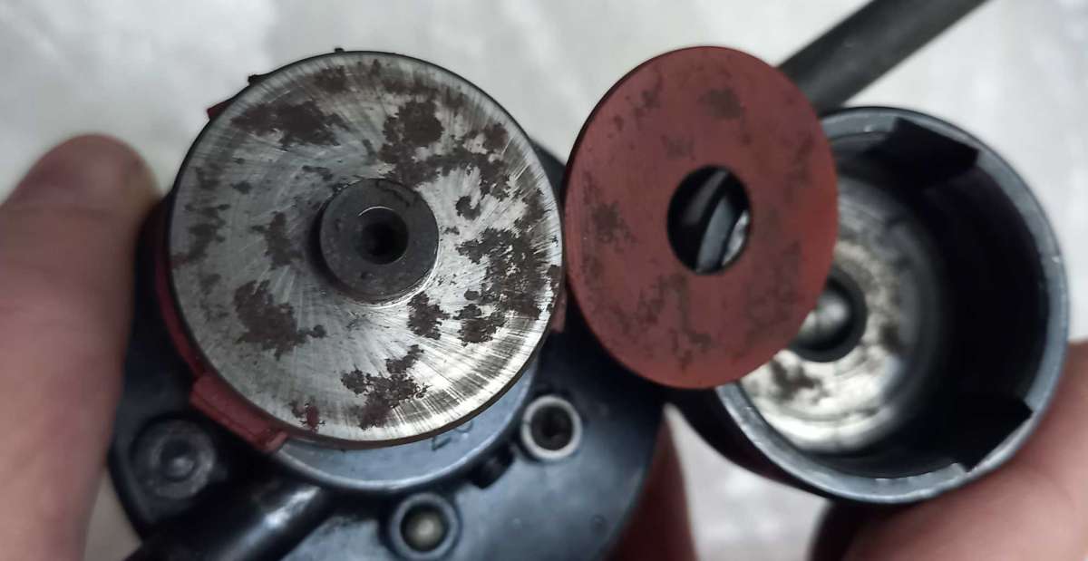

      Backing off the ring allowed the clutch to slip. It was however very rough. Taking it apart soon revealed the cause:
      Archer-No-1-2
      Clearly damp has got in there and rusted the plates. It’s also damaged the 3 vulcanised fibre friction discs. I’ll have a go with Evaporust to start with and see how that does.

      #843083
      bernard towers
        @bernardtowers37738
        When I did my head I reground the washer and gave the fibre discs a clean-up and with a little light lube its been working well ever since

          #843117
          renardiere7
            @renardiere7
            As of a few years ago there was a fellow selling replacement Vulcanite discs for Archer heads. With a bit of effort I might find his website.

            #843146
            Robert Atkinson 2
              @robertatkinson2
              On Dave Halford Said:
              There should be an oil hole on the top.
              The oil hole is on top of the gear box, not the chuck.
              The clutch plates should not be lubricated. Looks like a bit of corrosion protection is needed though.
              The gearbox is grease filled with an oil hole. Yes really. It requires oiling when used constantly. This is to ubricate the input shaft bearing.
              Robert.

                Apologies’ I was thinking Ackworthie, the gears and clutch are combined on their smallest head.
                #843169
                bernard towers
                  @bernardtowers37738
                  I found with mine that the clutch was very abrupt without a little lube
