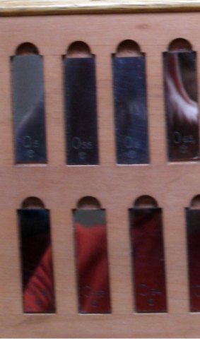

              I have a specialised set of gauge blocks – the thickness run from 0.5 to 0.9mm in 0.05 steps the 0.91 to 1.0 mm in 0.01mm steps Not sure for what purpose they were acquired by a now defunct microelectronics company – dated 1971 made by Cary Le Locle Switzerland but marked on box "Calibration uncertified"
              (difficult to photo as very reflective)
              They are really clean room only use – they need cleaning (iso-propyl)  but my own usage is more admiration than use as I have a more useful standard imperial set which allows checking of mics etc
