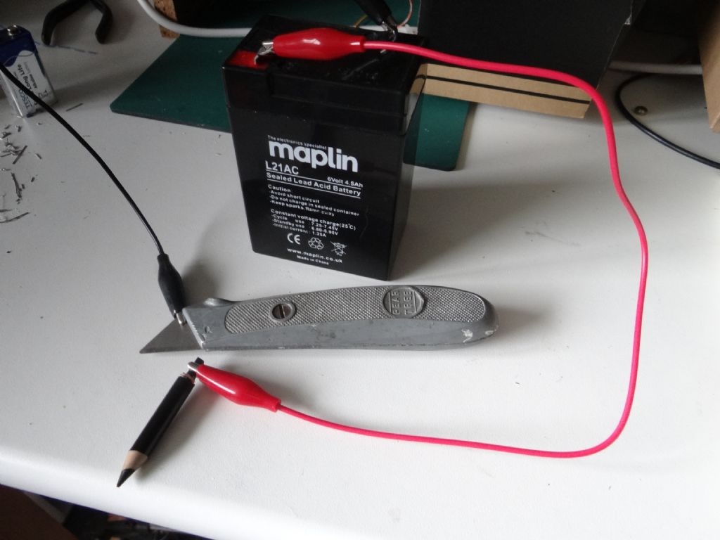

              Apologies for the delay reporting back on low voltage arcs – I had trouble finding a zinc-carbon battery.
              However:
              This is the set-up with a 6V accumulator with a Carpet Knife blade as the negative electrode.  The positive electrode is a the soft artists pencil that didn't work – it's resistance is too high.

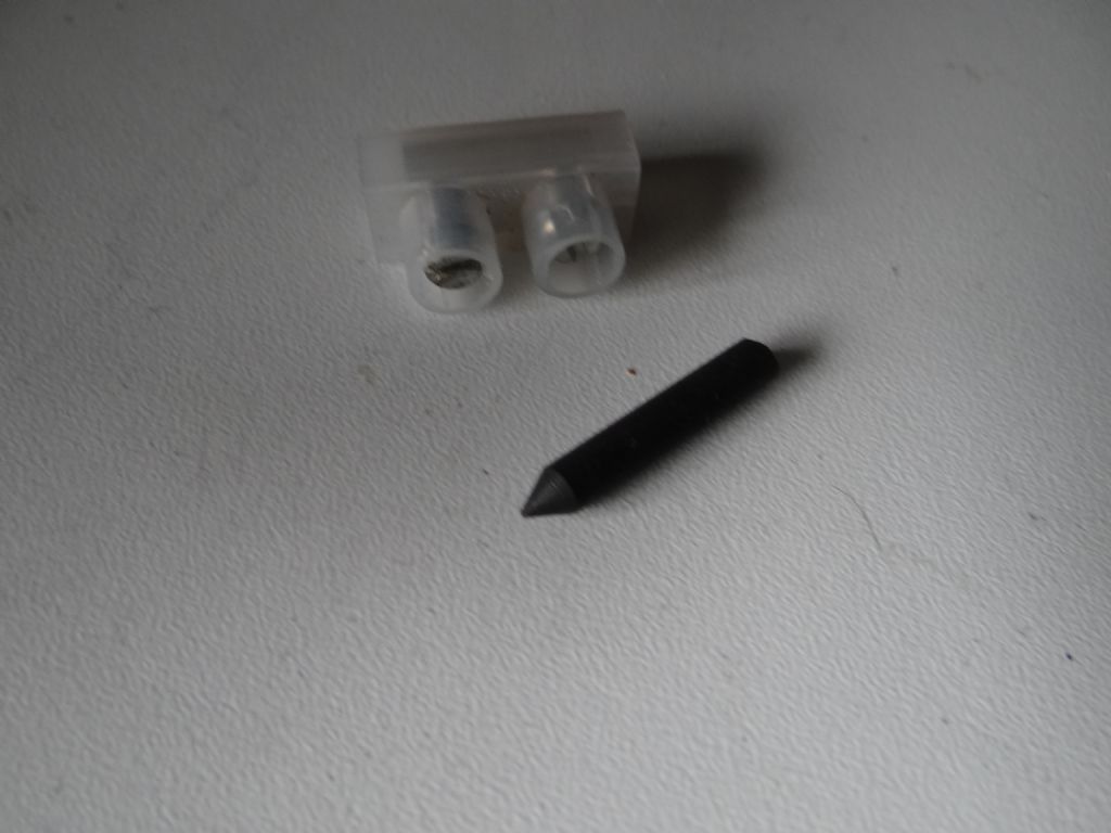

              This is the Mk2 electrode made from the anode of an 'AA' sized Zinc Chloride Battery.  I broke it taking the battery apart.
              Not a good photograph but trust me you can easily strike an arc at 6V.  The resistance of the electrode is about 3 ohms, so this is about 2A.  The choc block terminal soon got hot enough to melt the polystyrene insulation, and the crocodile clip wires got warm.   Trying to keep the arc going with one hand while taking photographs with the other is tricky.  Also camera had trouble capturing the characteristic bright white point of light from the arc – most of the colour in this photo is red-hot carbon.
              The arc is only 12W and most of the power is heat and light.  Even though it's not in the same power league as a welder, I wouldn't risk it if I had a pacemaker.
              The arc does severe damage to the knife blade.

                Very nice demonstration, thanks Dave
                I would, however, just mention that although it is clearly possible to strike and maintain an arc … that is not the way that conventional Resistance Soldering [the original subject of this thread] is done.

                  Yes indeed. I wouldn't want to scare anyone off. I deliberately created the conditions necessary to strike an arc. Pushing the electrode firmly against the work and applying power with a foot-switch would reduce the risk massively. But a careless operator could cause an arc by accident, and the arc would be much more exciting with 200 Amps than my 2A!
                  My original point was that an AC Resistance Solder Unit is safer because AC is intrinsically much less likely to arc than DC. That led to discussion about the difference between sparks and arcs, and whether or not starting an arc needs lots of volts. It doesn't.
                  Fortunately AC Resistance Solder Units are easier to make than DC provided you can find or rewind a suitable transformer. (Lot's of good advice in the thread about that.) Pacemakers apart (get expert advice!), anyone who wants to build one can crack-on.
