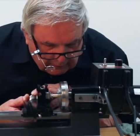

      My USB microscope from Aldi is surprisingly good but the latency means using it for machining would be pointless.
      People often over estimate how much magnification they need. What about something like this?

      #427811
        I use a Brunel MX1 Stereomicroscope for low power x10 and x20 duty in my other hobby. I've often thought it would be easy to make a stand for workshop use because it mounts on a simple pillar. I imagine something like a beefed up arrangement of rods like an overgrown DTI base.
        The image is sharp with good depth of field and there's no digital processing lag. I'd recommend a stereomicroscope for cutting as opposed to simple inspection because its easier to judge distances in 3D.
        Not top of the range optics by any means but it's not a toy, just under £90 today. Other suppliers available.

          I use a 5x one of those with my little sherline, got it from Aldi a few years ago. A quick google shows that 10x ones are also available from various online shops.

                    I find the Optivisor headset excellent for when I'm turning very small parts.
                    You choose the lens by focal distance rather than magnification so you can select one that is comfortable to work with. This helps prevent any aches and pains from being scrunched up. Very comfortable on the head too.
                    Good stereo vision, decent width and depth of field and you can "look under them" for a naked-eye view without lifting the visor.
                    If you get an opportunity to try a pair, please do. They are the only form of magnification I've ever really got along with.
                    Steve

                        Yes, I'd second that Steve. I wish I'd purchased mine many years ago – they now live on my head whenever I'm in the workshop – they flip in and out of use as required. Mine focus at about 8" (forget the lens reference) but I also have the extra 'loupe' fitted which is very handy for looking at tool tips etc (and I can always find it!).
                        I do have an inexpensive USB microscope, which I've used in static applications when I've needed a close up view, as it's much easier on the back/neck if you are doing things (comparison and/or examination) for an extended period. I've got an old large (& very heavy) DTI stand and the scope works well when set up on it. I also used it once to see where a 'pointer' (held in the chuck) was on the back of some work I was trying to set-up in my small horizontal mill as I was having some difficulty seeing what was going on whilst twiddling the knobs…the LED light was very useful and looking at the laptop screen much easier (once I'd started to 'twiddle' in the right directions)
                        However for the smaller work I do, the Optivisor is ideal when actually turning it.
                        IanT

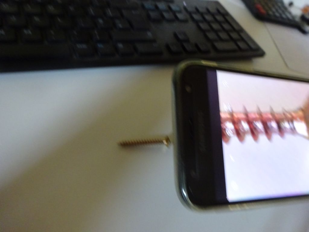

                              Was that info from me where I pointed out what jerry had said in his reply and the same in his older posts?
                              He also lives dangerously and uses a Loupe, thought you would have gone for that too.
                              As for the phone just find a way to hold it an dyou have big screen viewing
