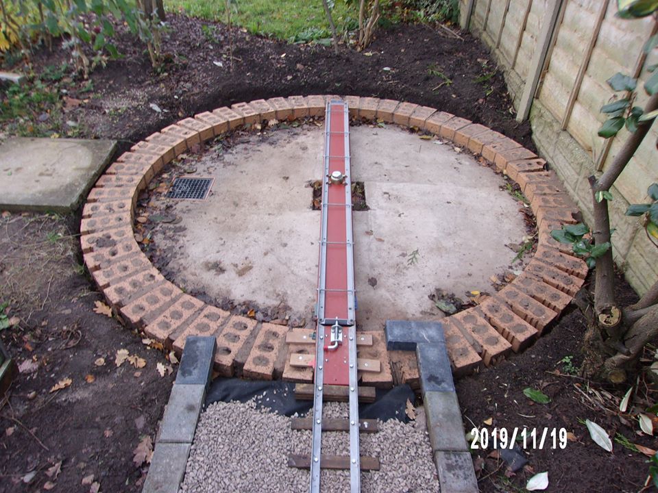

      Has there ever been an article on building a 5" Gauge Ground Level Turntable ? "Search This Site" suggests there hasn't. Does anyone have any advice for a beginner-level metal worker ( no lathe or milling)? I was thinking of a design based on cheap, easily obtainable 2nd-hand car wheel hub with angle-iron to form both the rails and the structure . Is a circular ring rail necessary or use castor wheels? Only need a basic functional design for 040 /060 tank engine and Bo-Bo battery diesels . Thanks in advance for any hints and tips.on how to start this project.

                            Thanks for all the advice and comments. Thought I should share with you the almost finished product.
                            So I went with original car wheel hub idea. This turned out to be reassuringly sturdy, almost too heavy to lift. Main beam is 150 x 75mm x 8 mm C channel with 25x25x5 angle iron rails. It is 2m long and uses an inexpensive trailer wheel hub.. There is no peripheral rail as there is only about 5mm of deflection caused by play in the hub but this isn't a problem to be solved as the necessary locking mechanism ( stable door bolt) keeps everything aligned and supported. There is still cosmetic and landscaping to compete but it is too cold to lay more brickwork.

                              Looking really good Chris. Does your angle section have a fairly flat edge in contact with the wheels or is it the rounded edge type ?
                              #439769
                              Chris Pyne 1
                                @chrispyne1
                                That is why I went with the 5mm thickness rather than more common 3mm . A bit flatter with round edges rather than semi-circular profile. Hopefully better engagement with flanges and sufficient adhesion surface . Tested Ok in workshop with small battery 040 shunter but cannot get big BO-BO loco around to that part of layout for a real test until I clear all the leaves off the line !
