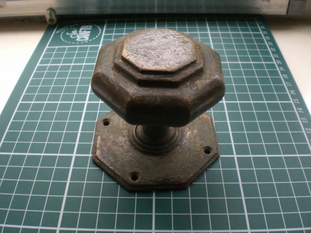

                              Hi, the lever looks to me, as if it has part of it broken off it, I guessing that being that this valve, (if that is what it is) and is attached to the boiler, is a safety valve and would have had a small weight hanging on the lever somewhere on the part that is maybe broken off.
                              Lovely looking engine, pity there isn't any drawings available, as I have a couple of these fancy doorknobs.

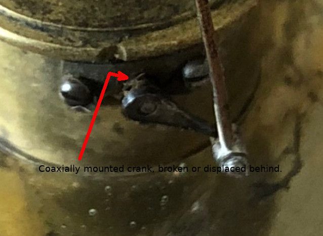

                                              I wondered if there's a second missing or hidden crank that should be mounted coaxially on the same axle as the main crank. Like the hour and minute hands, a clock maker might think of that as a cunning way of passing an up-down stroke to a valve under the piston. The valve? rod might move safely in the slot behind the rotating crank.
                                              The plate with two screws might cover access to the valve gear.

                                                    Hi, what about a rack and pinion arrangement instead of a lever. Is the plate with the two screws complete or has something broken off it perhaps? as the bottom edge doesn't look as straight and neat as the top.

                                                      Hi Sorry for the delay replying. The doorknob is about 2 inches diameter, not a big doorknob at all.
                                                      I removed the screws from "the plate with two screws" (carefully!) hoping the plate was simply a cover but the crank passes through it so the screws went back in before anything got bent.
                                                      I removed the old brasso marks with a turps-based cleaner and it doesn't look to me as though anything around that area is missing. I think the area behind the crank arm on that side (without the flywheel) is too tight for a coaxial gear, and the thing you can see in the photos is a tiny pin that is fastening the crank arm to the crank, or rather wedging it tight against the end of the crank.
                                                      The small lever under the main cylinder rotates on a wedge shaped pin; it doesn't seem to me to be made for frequent movement, or it would be on a cylindrical shaft. The range of motion is quite wide – it moves from about 20 degrees past vertical towards the centre of the engine, down to horizontal outwards. So I'm inclined to agree with the idea that it's some kind of relief valve. But I'm no expert! The end of it doesn't look broken to me but shaped to allow a fingernail or similar to pull it back down.
                                                      I like the idea of using air to get a feel for the operation. I am still looking for a piece of tubing that will fit the filler hole!
