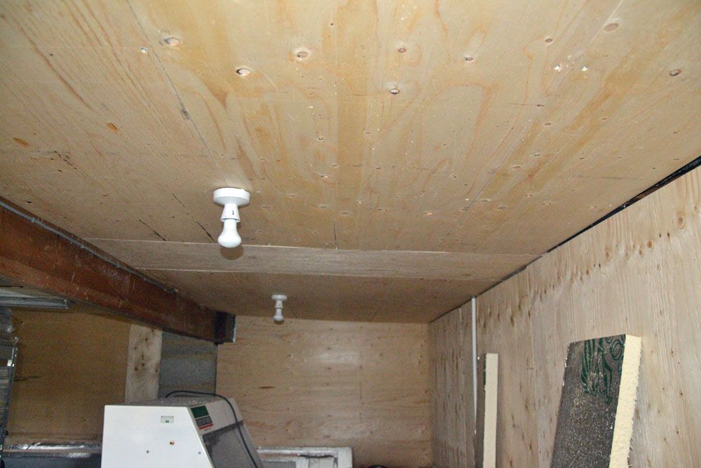

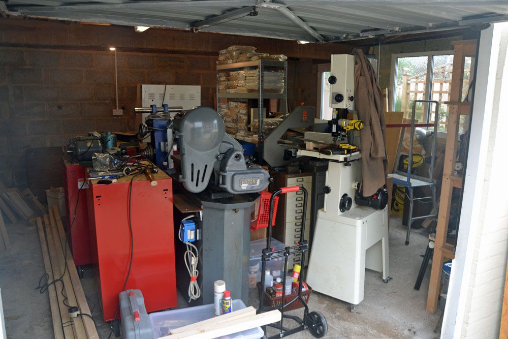

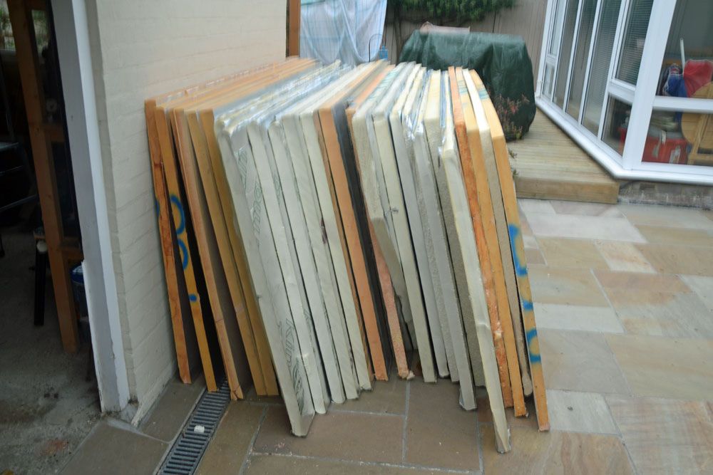

                                              Here's my pallet of Kingspan, nominally 50mm. A few are 40mm, which have gone on the party wall and there was one at 60 which has gone on the ceiling.
                                              It's been quite awkward moving around the kit but the weather has been benign so most of the cutting has been done outside.
                                              Two walls and the ceiling finished so far, with much help from my glamorous assistant ( Mrs J)
                                              The softwood ply came from my neighbourhood bargain DIY store at 12.95 a sheet – Fairly crappy and It feels a bit damp but I guess it will dry if I keep the doors open. They delivered 20 sheets for £5. The Kingspan has been fitted between 50mm square battens screwed to the wall and fitted between the ceiling rafters (or are they joists?).
