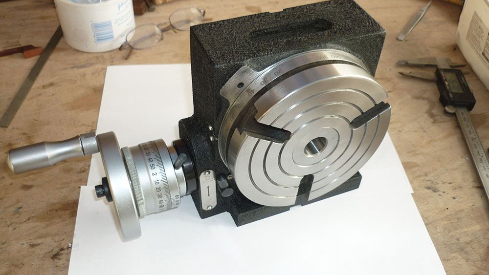

      p1280364.jpgp1280363.jpgHi, Ive never used and as yet dont know how to use a rotary table.
      I just bought a 5" table from warco and im trying to dismantle it to clean it up as i dont like all the razor sharp edges and dirt /swarf inside it.
      Ive got the table removed but im stuck as how to remove the rest of the handle and worm gear ???
      The screw in the side of the casting just seems to turn and nothing has become free. Do you need to press it out or what???
      Thanks

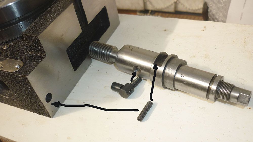

          Hi, Mark,
          Your table looks very similar to the one I have. Looking at your top photograph, there is a hole in the base just above the axis of the handle. On my table there is an allen-head screw in the hole, which retains the handle and worm drive. If I take it out completely, then the complete handle/wormdrive assembly pulls out of the block.

            Thats the hole ive tried ,the screw just seems to spin and do nothing it wont tighten and wont come out of the hole . The whole worm assembly is stuck tight .

                  Hexagon Allen key hole is fine looks like the head has sheared from the screw . Probably when manufacturer tightened too much.
                  I cant even get the loose head out ,i wish  i`d noticed this before id took it apart as i would have sent it back.
                  Whats the screw go into ,some sort of groove in the worm shaft?
                  I may have to drill it out.

                    If your table is the same as mine, the handle and worm assembly is mounted in an eccentrically drilled cylinder. If the screw we are talking about is loose, then the cylinder can be turned to adjust the engagement of the worm and table gear. The hole the cylinder fits into is split, and allows the hex screw to slightly close the block and clamp the cylinder.
                    That raises the point that if the screw head has broken off, there should be no clamping, so the handle/worm/cylinder assembly should pull out. Mine was quite stiff, and took quite a pull to get it out.
                    If this is your case, you may then be able to get the bolt shank out of the hole without drilling it, if the cylinder is out of the way.

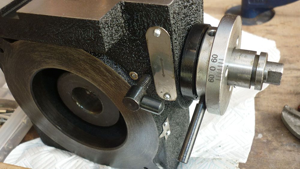

                        If you remove the collar with the 60-0-60 graduations you should be able to remove the black ring behind it, loosen the black locking screw and see if it will slide out, there are usually two screws that limit the rotation of the cartridge to disengage it from the table to allow quick positioning.

                          First, I have to apologise – after looking at my table, it looks as though it may be the same manufacturer, but slightly different design. The handle assembly and seating for the table seem to be identical, but the block looks slightly different.
                          In the side of the block, where the handle/worm is mounted (I think that is the side facing away from the camera in your bottom picture) is an M4 grub screw. This locates in a groove turned in the cylinder carrying the handle/worm.
                          The hole the cylinder fits into has a split on each side for about 2 cms, and an allen head screw fits to one side of the hole through the split. When it is tightened it clamps the cylinder in the block. I have to loosen the allen screw to slacken the clamping off, then remove the grub screw completely to be able to withdraw the cylinder/handle/worm. Just slackening the clamping screw allows the cylinder to be turned, and to set the worm/table gear engagement.
                          I'm sorry if I've misled you, but I guess that if it is the same manufacturer, then same or similar clamping arrangements will apply. In that case, is there a grub screw anywhere around the block close to the handle. One word of warning – my 'grubscrew' was more like a piece of soft metal with grooves in it, and it was difficult to tell it had a hexagon in its end. I replaced it with a better quality one – at least the thread in the hole was OK.

                            I followed Michael`s advice and removed the collar with 60-0-60 degree graduation on. I was at first unsure how to do this ,as i initially thought that the holes around the parimeter were just for the bar handle lever. I couldnt see the hexagon grub screws in the bottom, once these were slackened the collar came off no problem.
                            Another your table is proably somewhat similar from what i can find our ,they are either made by an Indian company called Saral tools or in China by a company called DC machinery. Going by the shape of the main wheel handle mine looks like the Chinese one . A supplied manual or parts list would have helped,i got nothing.
                            The problem was when i looked into the hole in the casting all i could see was a hexagonal hole that looked like a hex head machine screw ,so i was trying to remove it to no avail. I drilled out the hole about a mm larger to get a better view and cleaned all the dirt and gunge out and then only discovered another hex head grub screw about M4 and around 20mm long. I had to remove this almost whole the way until the main shaft/worm came out easily .
                            Turns out the grub screw was located in an oversized depression which seems to allow about a 10degree movement left or right .

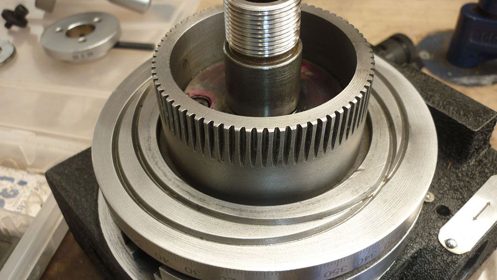

                              p1280381.jpgHeres a couple of photos , the second  shows where the set screw mates with the shaft ,seems a large cut out of the shaft for such a small m4 screw.
                              The first shows the worm reattached to the underneath of the table after removing heaps of dirt/swarf and grease.The red areas i was checking to make sure that this area wasnt contact the centre of the table as there seemed very little clearance about 1mm and the three holes had massive burrs round them.
                              Whats the best lubricant for these tables, grease on the worm and something like slideway oil (such as nutto 68) for the table mating surface?? And 32 on the shaft?

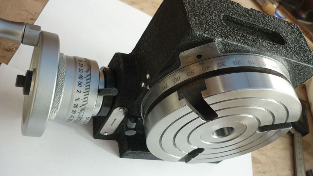

                                    img155.jpgHi An other, thanks. I have removed bits and reassembled several times since earlier. It works pretty smoothly `without` the table clamps I dont know what the problem has suddenly become with them the shafts are right up (around 1/2mm gap)against the table edge and hitting the oil port. cheeky
                                    One thing thats bothering me is i can turn the table by about a full half a degree either way when i stop turning . Which is going to make it difficult to use accurately . (i bought it to cut a pinion for a lathe ) and havent dividing plates.)
                                    I cant figure out how to adjust this out . I noticed when i had it apart that the worm shaft only seemed to engage fully with the worm gear under the table when it is exactly in the middle of the `wormed area` of the worm gear . So maybe its the vertical height of the table central part that is slightly out during manufacture . As in diagram above if the height is different either way in the direction of the arrow then it doesnt engage fully????
                                    I cant see anyway of correcting this or figure out what the adjustment set screw in the casting body is meant to do??

                                        Mark, that long setscrew that engages the slot in the worm shaft eccentric is used to adjust the 'throw' of the eccentric.
                                        The adjustment is sensitive but done carefully should allow the worm engagement to be just right. On mine I had to make the slot a bit longer on the 'disengage' end to allow full dis-engagement.

                                          I had forgot to put the thrust bearing in under the table ,I did this and tried again without the table clamps ,it worked great for a couple of minutes and that loose table movement of a full degree i could do by hand had gone.
                                          Then suddenly it all locked up and everything has gone down hill since,no matter how much i fiddle. I am having a problem setting the locking collar? (with the lever on ) in the correct position .Unsure even what the correct position is.
                                          The set screw that engages the shaft cut out from the side of the casting is driving me crazy ,no idea how much or where the correct adjustment should be . I wish i had left the thing as it was with all the dirt and sharp edges.

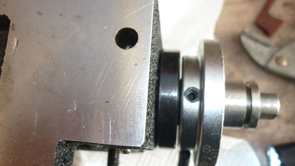

                                            p1280394.jpgWell after all the effort and trying allsorts of adjustment s ive finally done it i thinksmiley
                                            The side screw is very sensitive and there is now almost zero back lash .
                                            I wont be dismantling it again in any hurry.
                                            Thanks to all suggestions. Just need to sort out them stupid table clamps!
