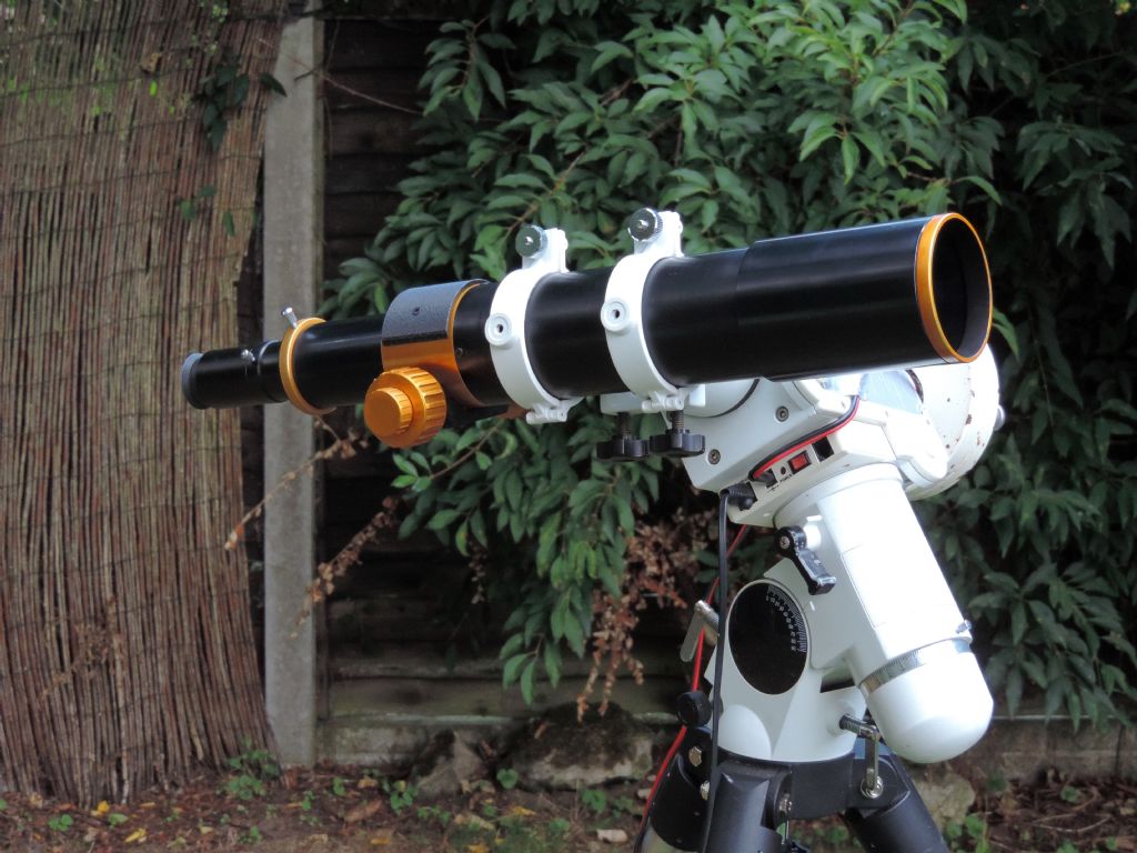

                                        I don't do any aeration.
                                        Current wise, I have a 50W 12V transformer and let the size of the work, cathode to anode distance and internal resistance limit the current, except for really small parts where I put a resistor in series.
                                        I use a 5A moving iron meter to monitor current, it usually swings across to the stop then drops rapidly to about 3-4A.
                                        May sound hit and miss but it's the prep, clinical cleanliness and getting excellent electrical contact (the meter will tell you if its OK) that matter, and the results are passable:
