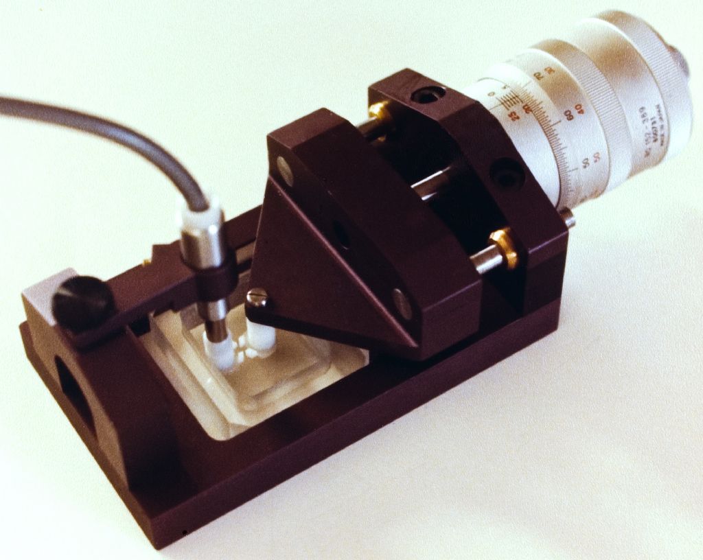

                              While building various research instruments some considerable time ago, I had quite a number of aluminium parts professionally anodised. It was disappointing when one set of parts, supposed to be black, were supplied with a significantly purple colour. Curiously, one piece just visible under the micrometer spindle, was quite a lot closer to being black.
                              I have to admit that there is a slight colour cast in this photograph. It was taken from a very old (paper) print.
                              Edited By Sam Stones on 27/01/2018 21:18:47
                              #338584
                              Jon
                                @jon
                                Always the way Sam, been there done it.
                                Just a thought the two or three pins did they end up sloppy on receipt? If not, not bothered and thats how it came out blue/black.
                                Finding an anodisers that cares is highly remote. If part comes out wrong they may strip and redo a few times each time it removes metal and ends up scrap. Biggest beef with 99% of them. One part at a Birmingham highly recommended anodisers came back and screwed in a further 285 degrees on a 1mm pitch. That tells you approx 0.8mm material has been eaten away in the acid! Scrap job.

                                Sam Stones
                                  @samstones42903
                                  Jon,
                                  It's too long ago to recall if the degree of fit was affected.
                                  Although it isn't very clear in the photograph, the 'pins' (guide rods and the micrometer spindle mechanism) you mentioned were clamped in the same plane. Had there been a problem, it was an easy matter to rub a bit off the matching faces of the clamps.
                                  The anodisers were (slightly) apologetic, but (fortunately it seems) I chose to accept the parts as they were. As one offs, I couldn't afford to remake them. There wasn't time either.
                                  I asked for natural (uncoloured) anodising for all follow up jobs that I chose to have anodised. I seem to recall there were few local anodisers, so I chose to stay with the same company.
                                  In reality, I wasn't interested in colour. I wanted parts with a hard wearing surface.
