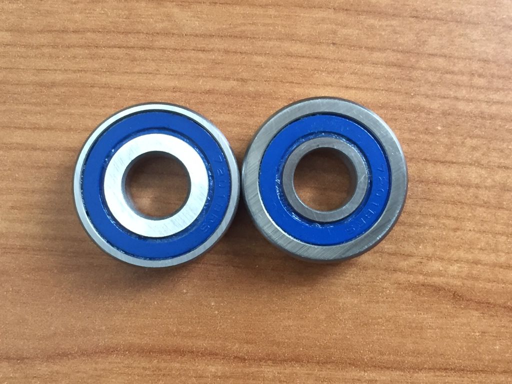

      See below the picture of what we have in stock. It looks like Pauls picture. It is 7206 B 2RS, so contact angle is 40 Degree. Easy to figure out which way is which:
      If you want to open yours to check, you will need to use a very thin flat screw driver and wedge it in carefully in between the inner ring and the seal lip to 'pop it off', to ensure least damage.

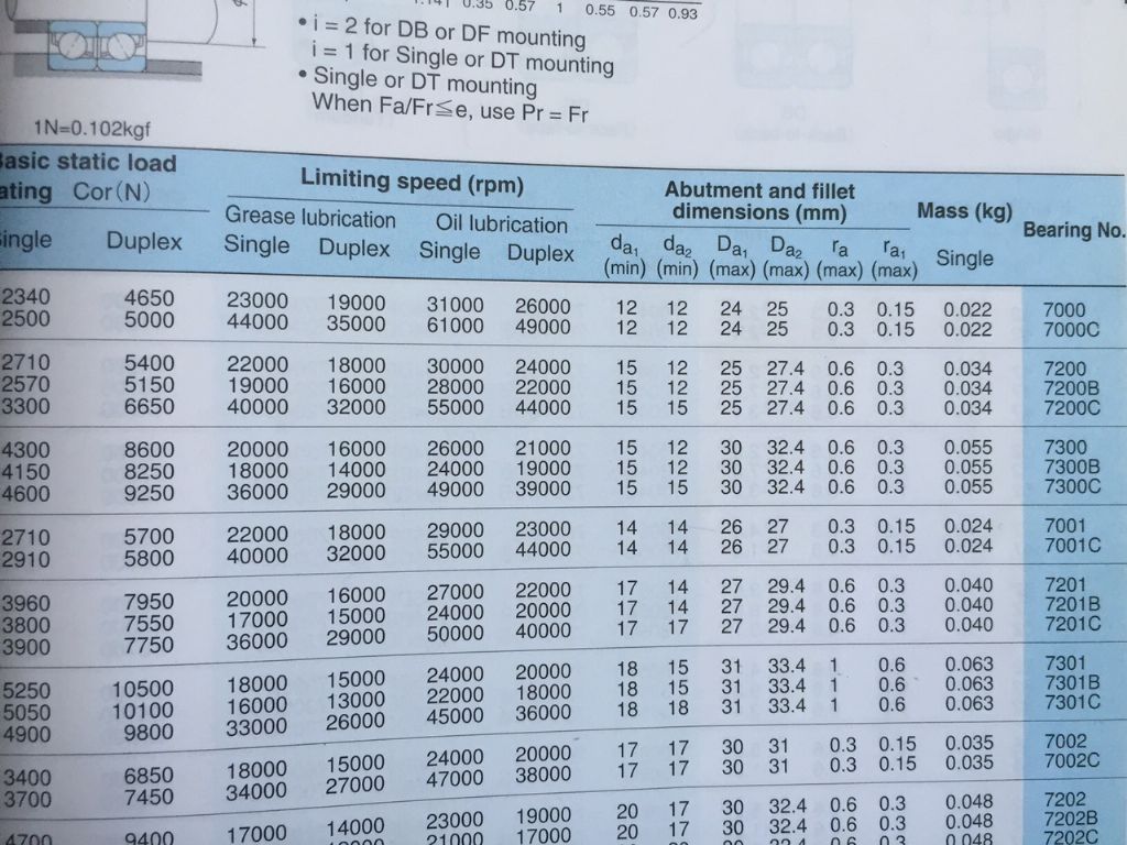

                    Extract from NACHI catalogue for suffix A, B, C:
                    Limiiting speed from NACHI catalogue, for 7201 A, B, C 'open' type, to be used as 'general guidance' only. 2RS reduces limiting speeds due to the friction of the lip of the seals against the inner ring, but still, you get the general idea:

                      Posted by Ketan Swali on 18/06/2015 11:32:30:
                      Small correction, the above picture is for 7201 B 2RS, and not 7206 B 2RS. …. Sorry.

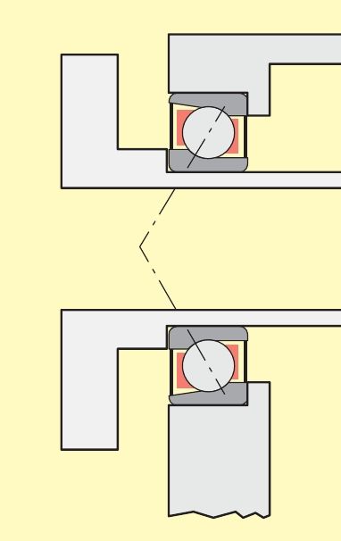

                          If you look at http://medias.schaeffler.com/medias/en!hp.ec.br.pr/72..-B-2RS*7201-B-2RS-TVP you will see the dimensions they should be. The outer ring look like more of a giveaway

                              Is there a letter after the 7201 number on the bearing? As others mentioned, that would indicate the angle. B is 40 degrees and that is usually very easy to see. I'm guessing yours is C which is 15 degrees so hard to tell.
                              If you measure the entire outside diameter of the inside race or the inside diameter of the outer race it might be easier to tell since you'd get double the difference than measuring the thickness of the race.
                              Every angular contact bearing I've seen had the thinner inner race on the ID side. Of course that doesn't mean it's always the same and I've never had Chinese angular contact bearings.
                              Although with a shallower angle it might be more tricky, but you can lightly press the inner race against the outer race to both sides and compare. On regular ball bearings the play is pretty even overall. On B angular contact bearings the difference is very obvious and you can't really pres the inner race much at all to one of the sides. With a shallower angle the difference might be smaller but tehre's a chance you could feel it. The side you press toward with less play would be the direction of the bearings facing each other to creat thrust (sorry about the clumsy explanation, it's not my first language).

                                    Couldn't be more ambiguous – depends where you are standing! Surely the printed face is to be loaded under compression. I'm sure he knew what he meant and I think we know the correct answer.
                                    He assumes the load is what is presented to the inner race.

                                      …….and the direction of thrust is against the non printed side. The axial load is to be presented to the non printed side.
                                      It's not completely clear but I think it means the same as what I found on angular contact bearings before i.e. the printed side is where the inner race is thinner and outer race is thicker.
