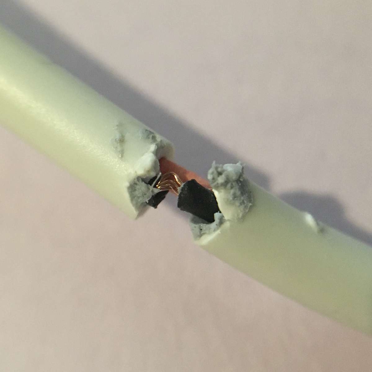

      About three years ago … as a ‘temporary lash-up’ I installed a nice little USB-powered LED lamp under the translucent stage of my stereo microscope.
      It has proved very useful … but part of its temporary status was my use of a generous lump of Blu-Tack to serve as a strain-relief bushing.
      Today, that was revealed as a mistake !
      The majority of the USB cable has remained flexible, but for a length of about 60mm the [white PVC] sheath has hardened, and has actually fractured at the point of maximum stress.
      Lesson learned … and shared

          I suspect that the Blu-Tack has absorbed the plasticiser from the PVC cable in a similar manner that polystyrene will.

            There is a general problem with soft PVC in all sorts of applications. The plasticiser is leached out far too readily, hardening the PVC, and sometimes softening whatever it is in contact with.
            My worst experiences with this have been with older vehicle tyres and inner tubes. If there is no rim-tape handy, the temptation is to use (PVC) insulating tape, which seems ideal, but … the plasticiser moves from the tape to the inner tube, hardening the (sharp) plastic, and softening the rubber, so part A cuts through part B. Not at all pleasant especially in a foreign country eg the Pyrenees.
            What to use instead? I have found duct tape to be OK, as it has polythene as its plastic, not PVC. Polythene does not include plasticiser (I think!), and if you rip it lengthways, rather than cut it, the strength is not sacrificed.
