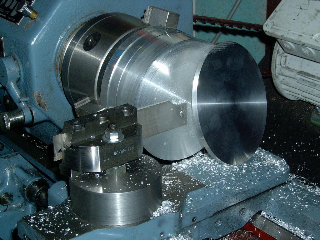

                                              I see it's one of the Iscar TGFH parting tools. Different inserts to the "GTN" used in many (most?) other insert tools. I was provoked into getting one recently after similar reviews here, on offer from Zoro (Cromwell).
                                              I found it worked nicely on steel and loominum. Not quite 125mm but it looked as if it would cope if the time came.
