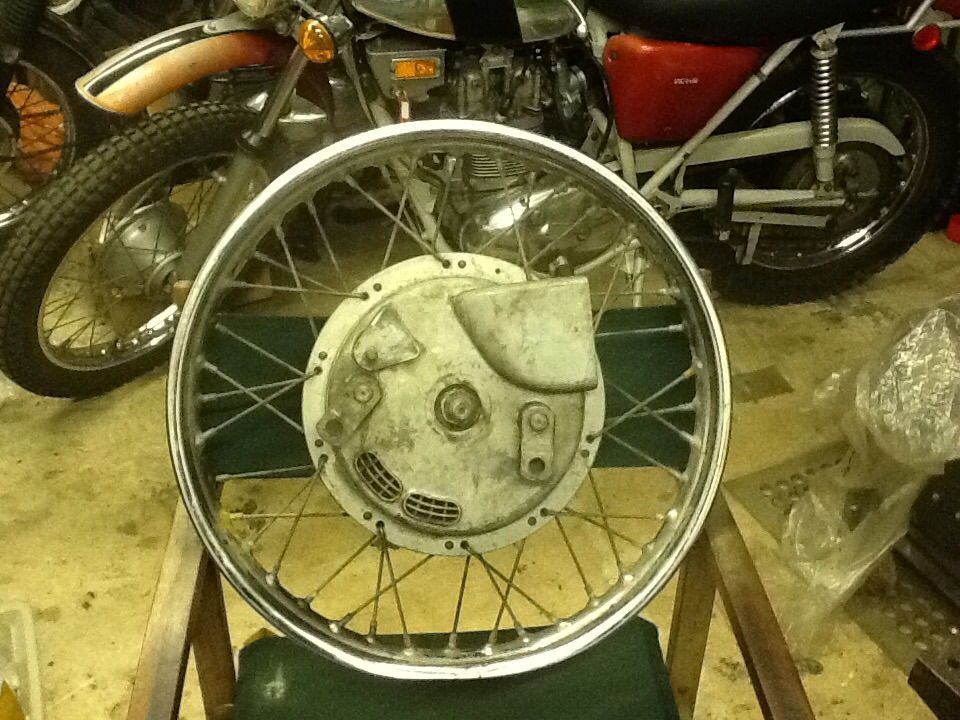

                                  While at the Autojumble last month I picked up this front wheel, with the infamous Triumph/BSA conical TLS front brake. You mention your heavy braking, so maybe they are not too bad after all, with a bit of tweaking.

                                              Yes I have seen the longer actuating arms, but the 8 inch TLS brake is intended for my 1971 250 victor so I don't want to end up with it over braked. A carefully fettled standard conical TLS should be better than the 6 inch SLS conical brake currently fitted, but the Saftek brake linings that Gavin mentions might work wonders for the 6 inch brake as well. The longer arms could be a final solution if all else fails.
                                              I agree that the earlier pre 71 Triumph/BSA TLS brake is excellent, I have one on my other 1969 BSA and it is fabulous. Over the years I have seen many discussions in mags and on the web about problems and improvements with the conical front brakes, but not a lot said about the earlier TLS brake because it works so well as it is.

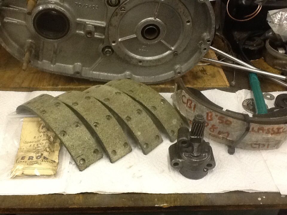

                                              Here a few more items from the Autojumble. A set of genuine original brake shoes for the conical 8 inch brake, plus two sets of unused linings complete with a pack of Ferodo rivets. If all these fail to work well then I will look into the brake linings you mentioned.
