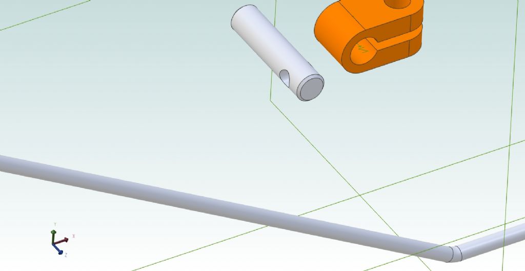

                                    #643704
                                    David Jupp
                                      @davidjupp51506
                                      Nigel,
                                      No need to re-model those parts, they look fine. A part being 'on its side' is not a big issue, you can still apply constraints that will position it 'correctly'.
                                      Either there is something amiss on your system, or there's some small step you are missing out or not quite grasping.
                                      Offer of help still stands – have you read my comments about how to rotate/roll parts in assembly space ?
                                      I've checked your computer spec – it isn't great, but should cope with models like this. If it is being sluggish to update screen, try turning off Ambient Occlusion on the View tab of the Ribbon in 3D workspaces – that will significantly offload the demand on the graphics adapter. There are other settings that can be tweaked to help further if needed.

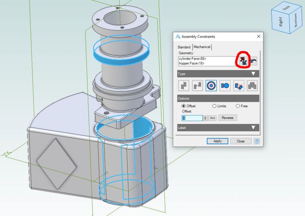

                                                    Nigel as I said yesterday the way items first appear on the assembly screen has little effect on how they are assembled.
                                                    You can see here that the column was on its side but as soon as I applied a constraint to the hole in the base and the column it jumped to the right way up.
                                                    Same with the clamps, I purposely made two files one with it the right way up and another of it on it's side. For each I apply a single constraint to the column and the column hole in the clamp as they are what I want to line up and in both cases they go straight to where I want them, the right way up one just move sideways but the other both sideways and rotates itself to be the right way up.
                                                    No different to you picking up the parts from a pile on the bench and manipulating them the right way round so they slip onto the column. Hopefully you would not say that you can't assemble the pile of parts if they were actually on your bench just because one were laying on it's side rather than on it's bottom.
                                                    #643768
                                                    lee webster
                                                      @leewebster72680
                                                      JasonB,
                                                      Does Atom 3D do what you show? That is a very neat way of aligning objects.
