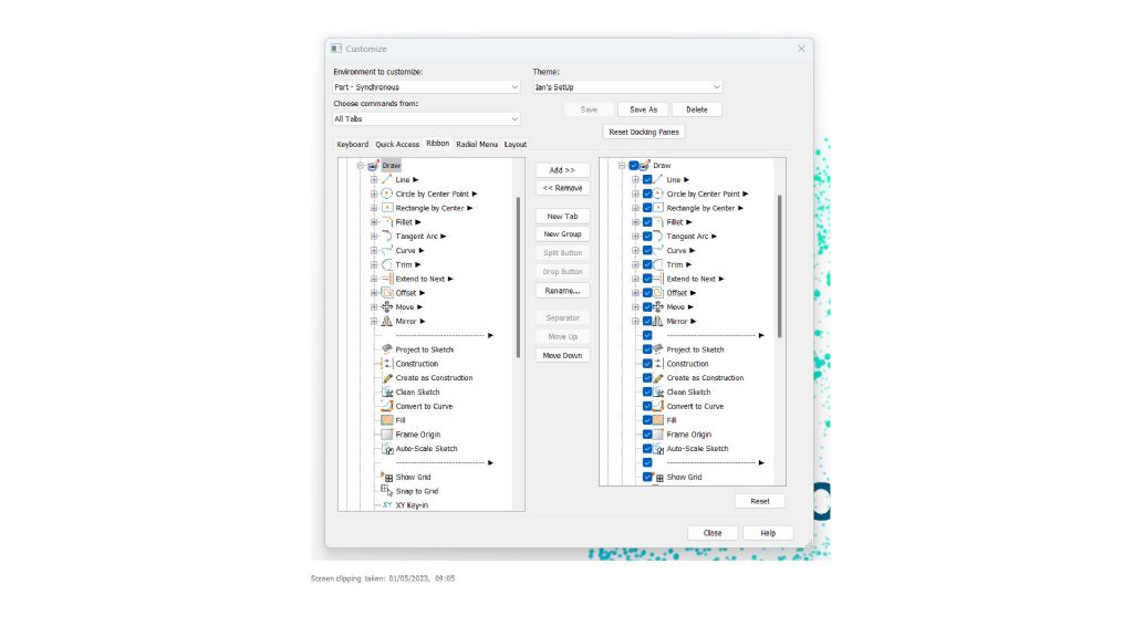

                                IanT
                                  @iant
                                  Posted by lee webster on 30/04/2023 23:58:46:
                                  Nigel, if you do buy Alibre then at least you will have all the time you need to learn it, or at least to learn enough to do what you want. I can't imagine ever using 10% of the features in Solidedge, but I did use 90% of the features in Designspark. Perhaps that's why I got on better with DS. It's a pity we can't pick and choose the features we want.
                                  Not sure if you've looked at SE's 'Customise' features Lee.
                                  You can change the UI in just about any way you want. I have a very slightly modified version of the 'Balanced' Theme but I do intend to get around to making more changes as I get further into it. I've changed a few key-stroke commands for instance but you can also hide Ribbon (the top bar) options if you find them too confusing. You can also make any remaining icons larger/smaller should you wish to. Just about everything in the UI can be changed….
                                  I've attached a screenshot of the 'Draw' commands in the Ribbon as an example. There are a few options there that I've never used but I'm going to wait a while before I hide them – I'm still learning….
                                  More detailed info here: Customising Solid Edge

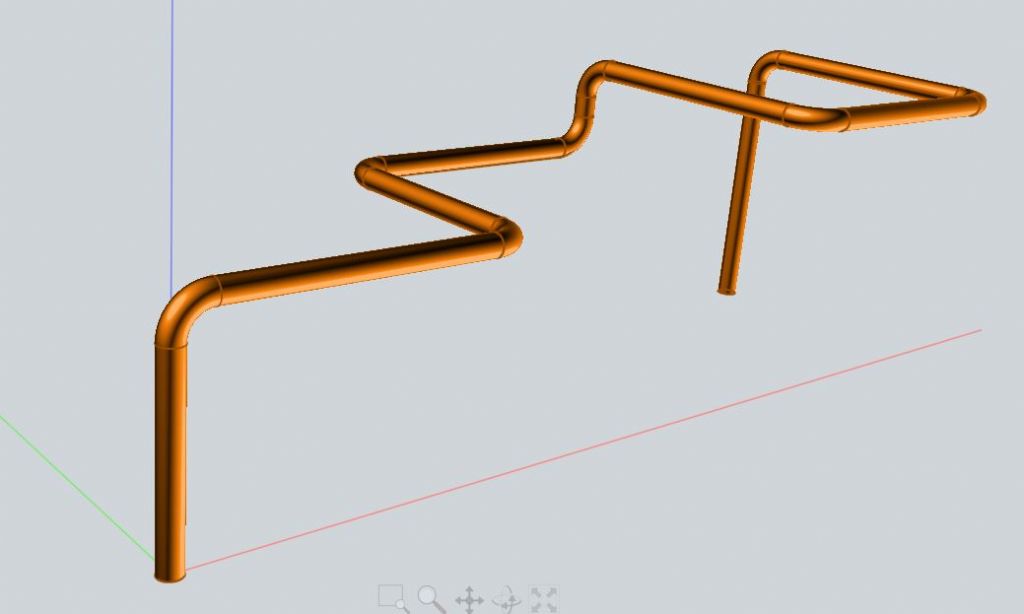

                                        …I share Nigel's pain. After a 6 month break I went back to Solid Edge's 3D sketch-tool last night. It's good for modelling pipework. After 40 minutes cursing repeat failures I went to bed in a huff – I've forgotten everything! I know SE works…
                                        Edited By SillyOldDuffer on 01/05/2023 11:10:13
                                        Dave.
                                        What made it difficult to do?
                                        Something like this?
                                        Martin.

                                            Posted by blowlamp on 01/05/2023 12:19:14:
                                            Posted by SillyOldDuffer on 01/05/2023 11:08:20:
                                            Dave.
                                            Martin.
                                            Exactly like that, except SE can also do dangly fire extinguisher nozzles that curve to a clip on the side. (Maybe MOI does them too?)
                                            The problem is me. I've been using the 2D sketcher for months. The 3D sketcher is similar, and I've forgotten the differences, so it doesn't do what I'd expect (in 3 dimensions).

                                              Posted by SillyOldDuffer on 01/05/2023 13:01:37:
                                              Isn't it just a matter of starting a line/curve in one view (say Front) and then continuing into Top and the Left view etc, until you have the shape you need, then finishing with a Sweep to make the solid?

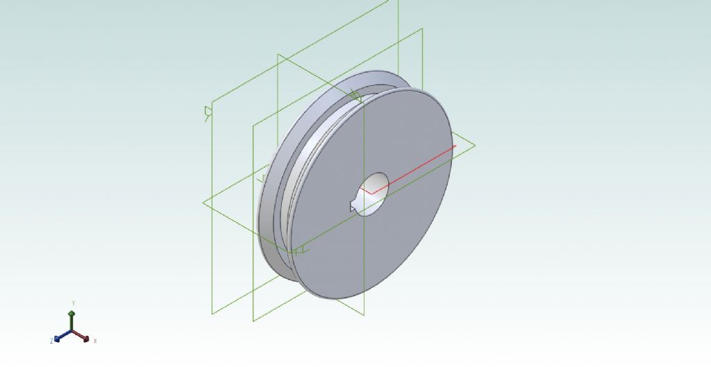

                                                This was one of my own attempts. The groove is a bit unsymmetrical, and any resemblance to any real Vee-belt size living or dead is purely coincidental. Oddly though I managed to make that Revolve Cut tool work on this, but not at all in the tutorial exercise.

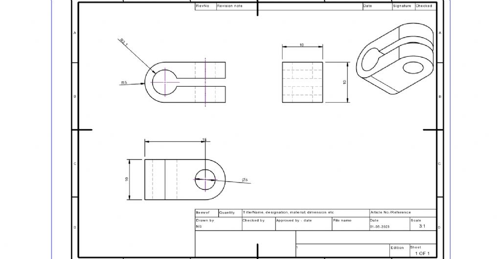

                                                Just spent half the morning fighting my way through that MEW tutorial to draw a scribing block.
                                                I'd already fitted the column to the base, but with a parallel rather than tapered fitting.
                                                So this morning, I've completed the parts but omitted the two threads and the knurling. In fact the text suggests the threads impose a huge overhead on the system, and to use a note on the 2D drawing instead: the convention of course is a thin rectangle to show the thread, and a dimension-note. I judged it too difficult anyway.
                                                The scriber-point is meant to be drawn as was the column taper – a "Revolved Cut". That kept failing as well, with every attempt raising error-messages the user is presumed to understand. To Hell with it then: I created it as a long chamfer.
                                                Something I found too, was where you are meant to enter a value for some features, it won't let you. You have to scroll or step through a counter instead. The Escape key is not always very prompt either, needing several presses. Could be a keyboard fault but I'd be surprised on a unit only about a year old.
                                                I did though discover how to draw two lines of set length at a set angle directly, in this case for the scriber's centre-line; using the inside angle [180 – external] rather than by dimensions afterwards. (There's a proper mathematical name for that type of angle, but I have long forgotten it.)
                                                It has you produce an orthographic drawing for the Clamp. That went moderately well but I was unable to dimension the width of the slot, nor to add the overall length dimension in the way it describes. It tells you to dimension the width next to the radiused end, and a special slot-dimension menu will appear. Oh no it didn't.
                                                The little rendering is all at some peculiar angle of its own, as well, as the image below shows.
                                                I had picked ISO which gives First-Angle projection but the menu also mentions something called "J-ISO" or something like that, and ANSI. I know ANSI is American but the 'J' one is new to me. Is that also American?
                                                There might be a way to carry the colour over into this drawing's rendering, but I didn't see it, and it's not that important here!
                                                I've now an Assembly drawing with five separate parts, none in the orientations shown in the instructions, and I can't find anything that will rotate them individually. The clamp is lying on its side, for a start.
                                                Trying to align the two pairs of planes is a nightmare. It kept doing all sorts of strange things. The text says three pairs but the display had only two pairs plus one plane on its own. The text also refers to a 'Flip' command under Assembly Constraints, to turn individual parts the right way up, but wherever it really is, is not there!
                                                I was unable to reduce the started assembly drawing enough to show all the parts. I thought I had done, but clearly not.

                                                  To my mind Nigel, you are making very good progress!

                                                    If you are having issues entering values into dialogue boxes, it is possible that you are suffering from one of two known issues. These could easily wreck your attempts to learn the software.
                                                    1. Grammarly is known to conflict with Alibre – it may be possible to workaround this with compatibility settings, but if you have Grammarly installed, simplest is to remove it.
                                                    2. Win11 for some users causes flickering of input boxes – a reported fix is detailed in this post on the Alibre User Forum
                                                    JIS – is a Japanese norm.
                                                    The projection angle (first vs. third) is inherited from the chosen drawing template, but can be overridden. Templates can also be customised to suit your own preferences. For example these days in UK ISO sheet sizes are typically used, but I see both 1st angle (as in mainland Europe) and 3rd angle (as in USA) projections both used. A customised template can combine ISO sheet size with 3rd angle projections, plus perhaps a Logo and some preferred dimensions styles.
                                                    The orientation for the 'Front view' in the 2D drawing is set when you select the part or assembly – there are controls to manipulate the model orientation before you commit to make the projections. All other views are relative to this Front view, so no you can't rotate them individually – it would mess up the projection angle for the views.
                                                    Please save these files – and please also accept my offer of help. I could talk you through this so much quicker than all these long complaints….
                                                    A Drawing of the Assembly would usually be of the assembled parts, not individual parts. Though you can add views of individual parts to the drawing should you wish.
                                                    Asking 'how can I?' is so much more positive than saying 'this doesn't work' or 'that can't be done'.
                                                    Jason showed the Flip command in a recent post which you seemed to acknowledge. The MEW tutorial is from about 5 years ago, the Atom3D user interface has moved on since then. If working from outdated screenshots is causing problems, perhaps leave that particular tutorial for the moment.
                                                    It looks like you've actually achieved quite a lot – you have most of the parts (maybe all) for the scriber – seems like you need some help getting to grips with assembling them, and then how the 2D drawing system works. Maybe later go back and look at revolve cuts for tapers and why you are struggling with that operation.
                                                    In assemblies one common issue we see is that if the user doesn't fix the first part in space after adding it to the assembly, then when constraining the next part to it things can fly off in unexpected directions. I strongly recommend fixing the first part in the assembly. To begin with the simplest way to do that is to place the part on the assembly origin, then to apply an 'Anchor' to prevent it moving. There are other options, but that will get you started.
