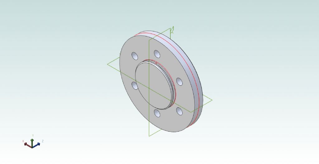

      This disc though, like a cylinder cover, is my first "own" attempt, based on moves in that exercise, and a bit of experimenting once that had shown me basically how the tools "work".
      The red construction lines include the just-visible, little rectangle for the revolved "O-ring groove". The reverse (outside) has a shallow recess matching the boss, and chamfered rim. The stud holes do go right through!

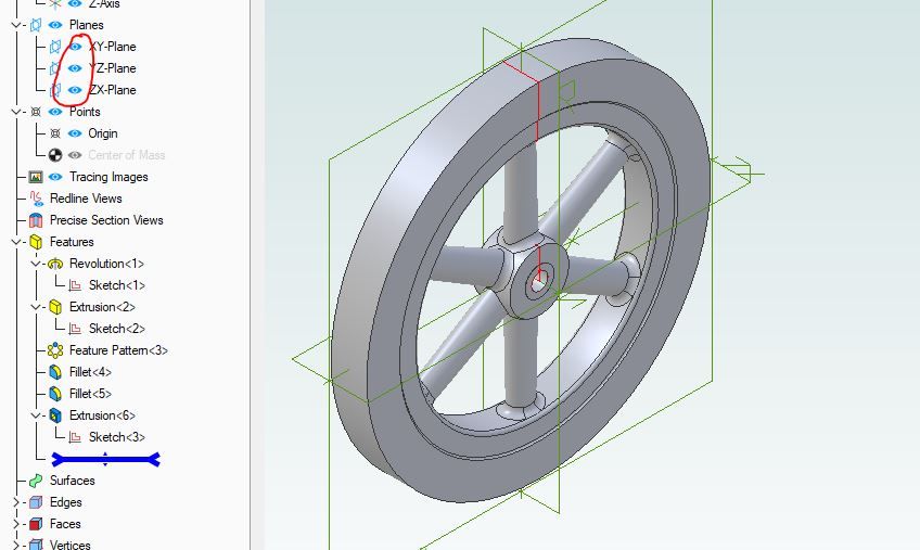

                            Nigel, I see from the cylinder cover image that you only have two of the three planes displayed, this may have been part of your problem with the tutorial. You probably clicked on one of the "eye" icons that toggle the planes an and off without knowing. Click the eye again to make the missing plane visible

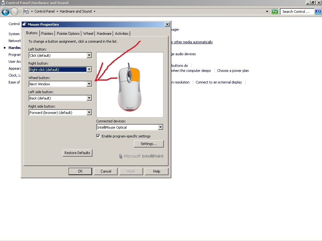

                                  With a programmable mouse you can cycle through all the active windows with a mouse click
                                  There's hardly room for a mouse at my desk, never mind another monitor
                                  Edited By Ady1 on 24/04/2023 13:00:23

                                    The "missing" plane is sort of shown by the red line round it. I'd basically used the techniques from the tutorial so made that primary extrusion through the plane. I did later see the big blue arrows I guessed are to do with the plane indicators, but not twigged what they really are or do.
                                    I might have turned the plane frame off when working out how to make the groove that is not very clear on that image.

                                      Big blue arrows which appear when hovering over a plane are the direction indicator for the plane normal.
                                      Though it may not matter much in routine use, planes have a 'direction'. Put another way planes have a top/bottom or front/back differentiation.

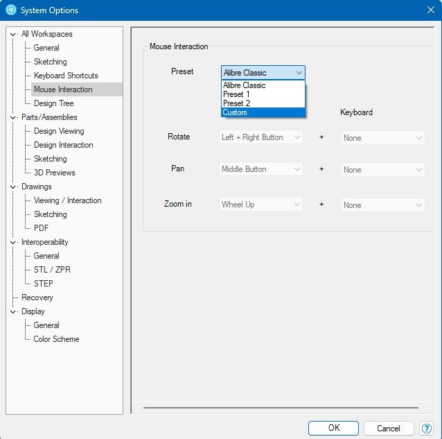

                                      Unfortunately the ability to edit keyboard shortcuts is disabled in Atom3D (because it would potentially provide a way to access features from products higher up the range). Apologies Nigel – I should have checked that in mnore detail (my own system doesn't necessarily show it because I switch between Expert / Professional / Atom3D but my own user settings file is common for all of them).

                                                      When you get your new mouse, it will most likely have the third button incorporated with the scroll wheel. There is a configuration option in the system option page which allows alternative presets to be selected for mouse clicks etc. There is also the custom selection available, too, should you want to tailor it to your specific needs. Me, I just use the "Alibre Classic".
