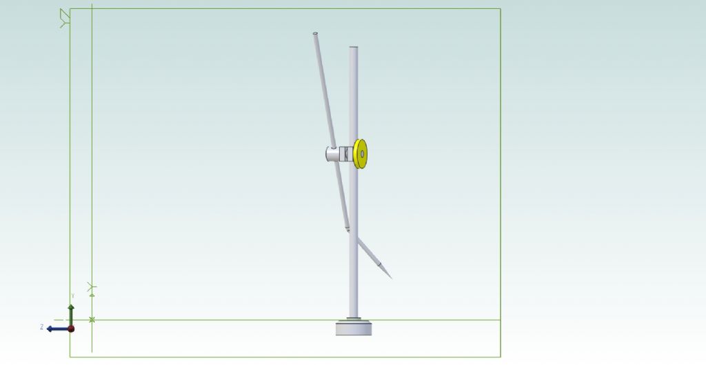

          Got there eventually but what an exhausting, disheartening process (Image below).
          No of course I don't think that, but when trying to follow a tutorial exercise word for word so less likely to go wrong, it is very confusing and discouraging when you can't make things work or your results don't match as it leads you to expect.
          However, I was struck by your video apparently by-passing some of what the exercise test tells you, so I tried copying it and to my surprise I managed to assemble the clamp on the pole.
          So I tried putting the rest together. That was one monumental battle, at one point welding the thumb-wheel inside the clamp. I had to close and re-open the file to sort that out, and eventually succeeded, leaving a trail of at least 20 constraints and any number of "Undos" just in the second attempt at what an expert would doubtless knock off in ten minutes with no mistakes.
          I noticed this though. The instructions, if I had read them right, say you put the parts on the screen, then select:
          Constraints > Enter the mating surfaces or edges > Constraint type (seems semi-automatic) > Apply > Close,
          and watch it slide with eerie grace into place; solid steel through solid steel like a ghost through a wall.
          Only, most of the time nothing happened, or it just aligned them in fresh air.. Finally, in desperation I grabbed the part to be added, and slid it by brute force and ignorance into place. It seemed to work, as if the Closed Constraints menu was still active out of sight.
          Whether the assembly is accurate is another matter. Aligning the collar and pin-holes was very difficult, as much by eye as by constraints that did not seem to do anything. I suspect if you could view it transparently you'd see the scriber has made the hole in the pin oval.
          As for what plane it's on…. More planet than plane. The two vertical planes are XY and YZ, the floor is XZ, and the little trident symbol was pointing anywhere but the normal, positive-going (x, y, z) directions. No idea why. I imagine you've no hope of depicting more complicated assemblies like engines or workshop machines, perhaps from sub-assemblies as well as individual parts, if you've no idea how to align the planes and orientations properly and coherently across all the drawings.
          Oh, and I reverted to using the previous pointer despite it having no scroll-wheel, and this time everything seemed to respond as it should when selected.
          Learning 3D CAD to use to design engineering things to make? I'll be past making porridge by the time I manage to reach that level with CAD, if I ever do.

            The parts may look like they are in mid air after adding a constraint but remember you are working in 3D THREE DIMENSIONS so will probably have to add an additional constraint or two to completely tie the component down into it's final position.
            Beware just dragging something into position as it may look right in a particular view but won't be in another. Also if a part is just dragged into position there is nothing to keep it there so you could find later when adding further parts and constraining them the part you dragged will move out of that position, not what is wanted
            Guesswork and your difficulty earlier positioning that random rectangle mentioned earlier can be solved by entering dimensions and constraining to an axis.

              Nigel,
              The constraint interface has been updated since the MEW articles – there used to be a choice of 2 assembly constraint tools – they've now been combined into a single (improved?) tool that does look different. The new tool can access all the functions of the old, but some naming has changed slightly to simplify things.
              If applying constraints doesn't always work, it may be that something is wrong with your system/installation (I've offered to check this for you) – or you may be accidentally de-selecting, or even selecting a different item than intended. The constraint buttons that become active vary depending upon what is selected.
              Don't worry so about planes – whilst being consistent can be helpful, it isn't a requirement. I tend to just model my parts, then sort out the orientations when I assembly things (unless I design a part 'in context' whilst inside the assembly it will be added to).

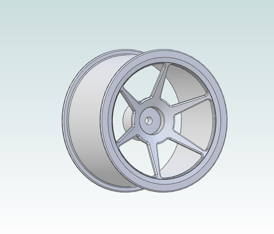

                I have been following this saga with increasing interest and growing frustration but have refrained from commenting until now. It would appear to me, Nigel, that you would be advised (by me, anyway) to decide what part is going to be the basis for your assembly – in this case I would suggest the base – and choose that as the first part in the assembly view, placing the centre of the base at the conjunction of all three axes. Then ANCHOR it there. You could always place it near the axes origin and use the constraints to locate it accurately. Then place the other parts into the drawing as if assembling them as you would in "real life" as it were. Constrain each part to the base and subsequent parts to their corresponding positions using as many constraints as necessary. Depending where I drop the part, I tend to align mating faces first followed by coaxial constraints. That way you build up the assembly and the end result is achieved in a sensible timeframe. For example, today I've decided to start the 3D modelling of a race car suspension, using bought-in wheels and tyres as the starting point.
                This is progress so far. The wheel was placed in the assembly file and anchored to the axes conjunction, The tyre was then adde and finally the driveshaft.

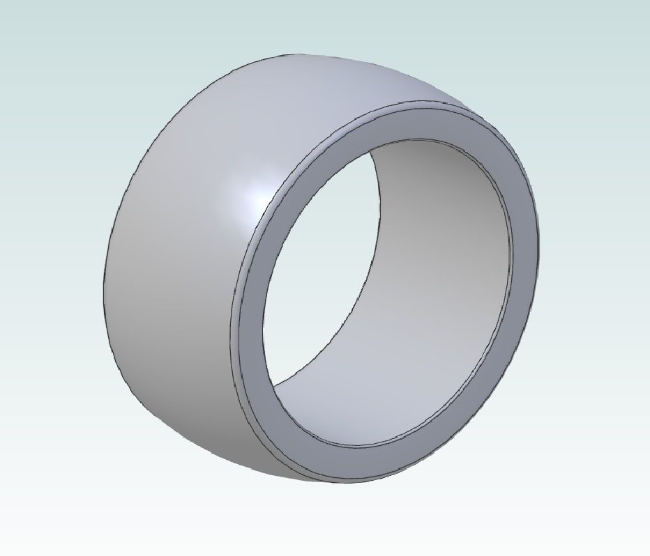

                rear wheel tyre

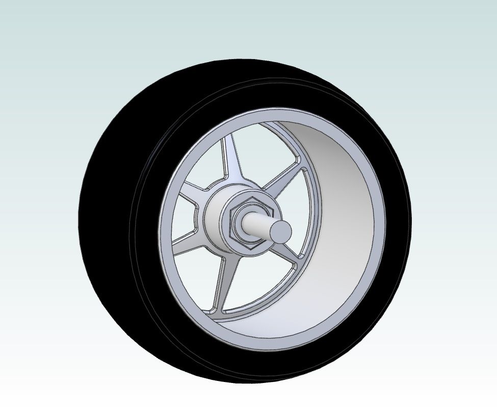

                Wheel and tyre below as an assembly with the (unfinished) driveshaft as one.
                whole assembly_1
                Keep on plugging away, and take David up on his generous offer of help for goodness sake. I'm sure he'll get you sorted in no time, if only you'd give him the chance. Apologies if this advice is duplicating any already given. After 8 pages, I'm losing track of what has been said and what hasn't.

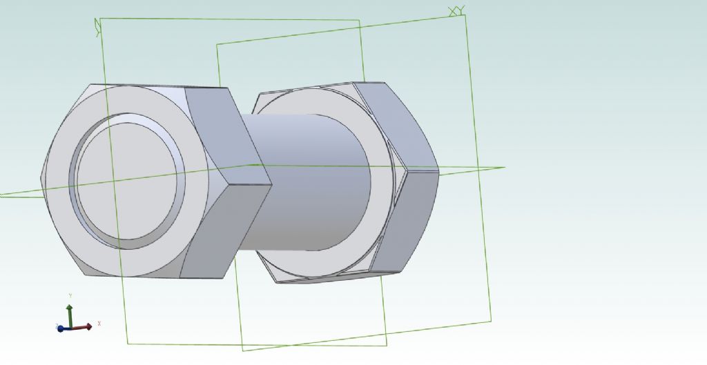

                                          Finally took the plunge and had a tutorial with David Jupp today, so thank-you for that.
                                          To see how much had sunk in I tried drawing a nut and bolt based on ones I have sitting on the kitchen window-sill, obtained for I forget what! I thought from quick measuring by rule that they are M25 but the standard size is really M24 – I am not going to worry about that here!
                                          I set out to try to crack that Revolve Cut thing to make the top chamfers on the nut and head, helped by going right back to Jason's video. It worked, but I still found it difficult. The underside chamfers are just that, Chamfers.
                                          I tried the threads, using values from the Zeus book that I keep by the PC, but they defeated me.
                                          I realised the less efficient way is to draw the nut with hole in one go. By drawing it with no hole then making a copy on its own file, one can become the bolt head and then you can turn the other into the nut, but never mind. It was a second go at the Revolve Cut tool!
                                          The two are separate Parts so if I feel up to trying to give them threads, I can. I forgot about aligning the two sets of planes and had a bit of a fight with that Flip tool to make the nut face the right way on the bolt, but then constrained the two together by end faces. I see the two are slightly out of angle, by the hexagons.
                                          I am now fairly certain that new mouse I tried was giving me gyp, but the Escape key is also a bit slow at times, needing two or three goes. David showed me the view-cube but is there a way to keep it on the screen? It seems very fussy when it will be available when going back and forth between Sketch and Model, and I couldn't determine when.

                                                To get angular alignment of nut and bolt head, one option of several is to use 'show reference geometry' for the nut – then you can use its reference planes to constrain to assembly planes.
                                                Another option (if nut and bolt head are same AF size) is constrain 2 flats to be aligned.
                                                If they are not the same AF size, constrain flats parallel – that is 'offset' with the 'free' option chosen.
                                                Or set an angle between 2 flats (be that zero, or some other).

                                                  Modelling physical threads. This can be done either by cutting material away (as shown in the MEW series) or by adding material on.
                                                  The most common problem I see is that the profile sketch used for the thread is wider than or equal to the thread pitch. For the helical tools to work well, the profile width (along the helix axis) should be less than the pitch (only needs to be slightly less). If needed, rounding of thread crests can be done afterwards using a fillet.
                                                  Another common issue getting helical tools to work is if the profile sketch is not on an appropriate plane, or difficulty selecting the axis for the helix.
                                                  If a particular task eludes you – open a support ticket with Alibre (and attach your file) the team at support will be happy to help.
