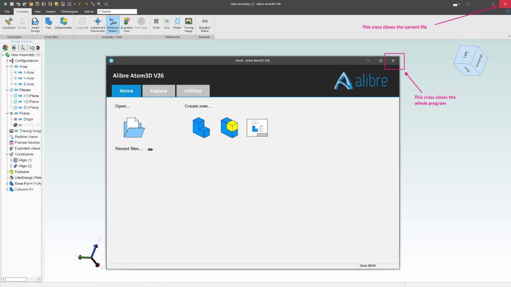

                                            As previously mentioned – the close file, and close program crosses are as per this image
                                            The 'trade mark roundel' was too difficult for many users to comprehend, so was dropped. A pity, I liked it.

                                              David,
                                              This cross closes the current file.
                                              This cross closes the whole program.
                                              Thanks for the heads-up. Seems a bit counterintuitive that the outer 'envelope' cross closes that which is within the program. …but if I think about it long enough I guess I can see the logic. Anyway, it is now a 'known known' to me, so no excuses.

                                                  Ches,
                                                  I arranged the 'Home Window' in front of the current workspace simply to show both in one image.
                                                  The Home Window is always active whenever the program is open (but often ends up behind the current workspace). There can be one or more workspaces open, each in its own window.

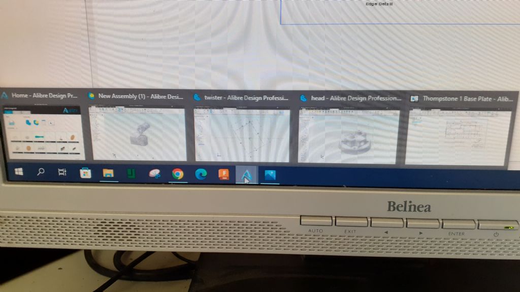

                                                      It is no different to having several tabs "open" along the top of your browser, cross on each tab will shut that individual one but the browser stays open. Same with alibre you can have several drawings, models, assemblies open at the same time and just close any one of them but Atom will still be running
                                                      Edited By JasonB on 30/04/2023 13:30:43
