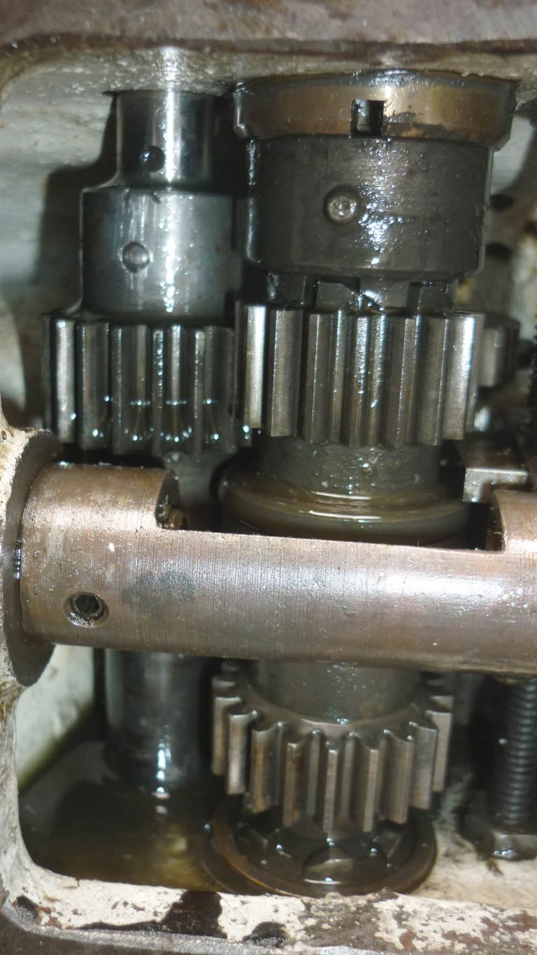

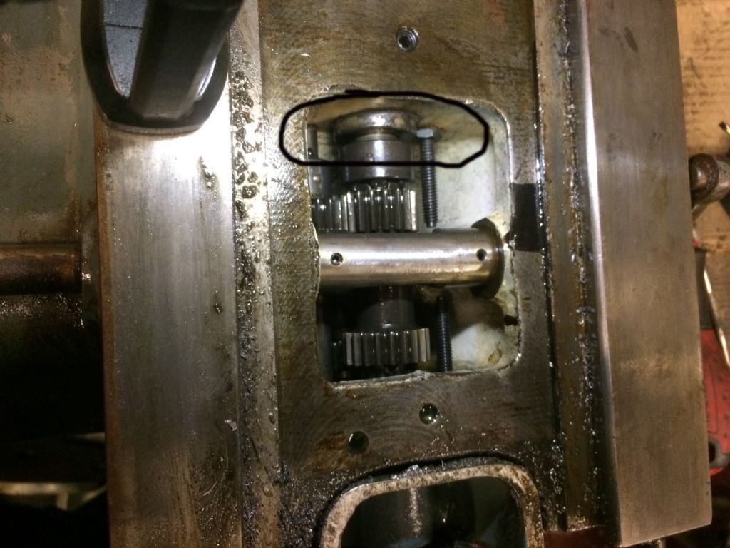

          Posted by David Broadbent on 30/12/2019 13:00:27:
          I think this is the most telling shot – the 4mm gap above the upper dog clutch.
          Where is this 4mm gap your refering to?
          #444085
          David Broadbent
            @davidbroadbent33226

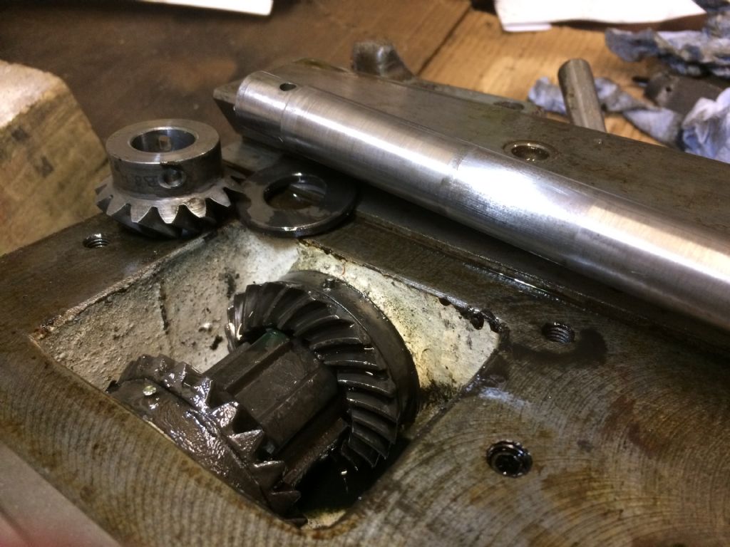

            Take a look at the photo, the 4mm gap is between the top of the dog clutch and the bearing tube as it emerges from the casting. You can also see on this photo that the selector quadrant is against its lower stop although the upper dog clutch is fully engaged.
            As I discovered this was due to the lower bevel drive being rusted solid to the drive shaft lower down. As the machine tried to move the table upwards under power, the rusted bevel drive didn't allow the shaft to move, so the carriage moved without it – effectively pulling the shaft downwards, shearing the taper pin in the upper bevel drive and creating the 4mm gap you see. I hope that's clear – it isn't easy to desc ribe in so few words!

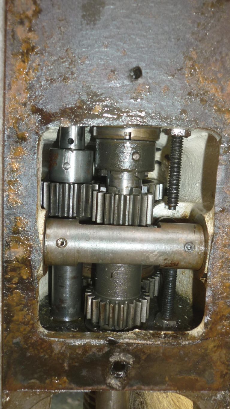

              mark smith 20
                @marksmith20
                Thanks , does mine look right??
                #444242
                David Broadbent
                  In my limited, recent experience I would say yours looks fine. The 4mm gap I saw was the distance that the carriage had been pulled off the shaft, shearing the taper pin in the upper bevel gear in the process. There can't have been much shaft still within the bevel gear actually, although it still worked as the mechanism was turned by hand. The gap was the only indication that anything was actually wrong.
                  Normally the distance between the upper dog clutch and the upper bevel gear is fixed by both parts being located on the shaft by taper pins. In fact that is the only vertical location provided for the shaft, everything else being keyed to slide up and down it. There is a thick washer under the upper bevel gear, which may possibly be some kind of selective assembly fit as there are no other shims or packers in the system to eliminate any up and down movement. My guess would be that the thick washer maintains the optimum clearance between the upper bevel gear and the upper dog clutch to the bearing tube that sits between those two parts and sits slightly proud of the casting as it emerges top and bottom. The correct setting of the upper bevel gear into the two crown wheels within which it runs is then achieved by moving this bearing tube within the machine casting. Once set this tube is fixed in place by a pair of grub screws. The diagram posted by Phil P illustrates this relationship pretty well – although it only shows one grub screw holding what may even be a two part bearing tube in the Deckel machine whereas my machine has an upper and lower grub screw. .
                  To me it looks like the whole thing is designed to run for a long time without being messed about with – unless of course the machine is left outside for several years and bits get stuck together with rust causing a taper pin to shear!

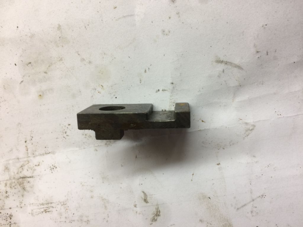

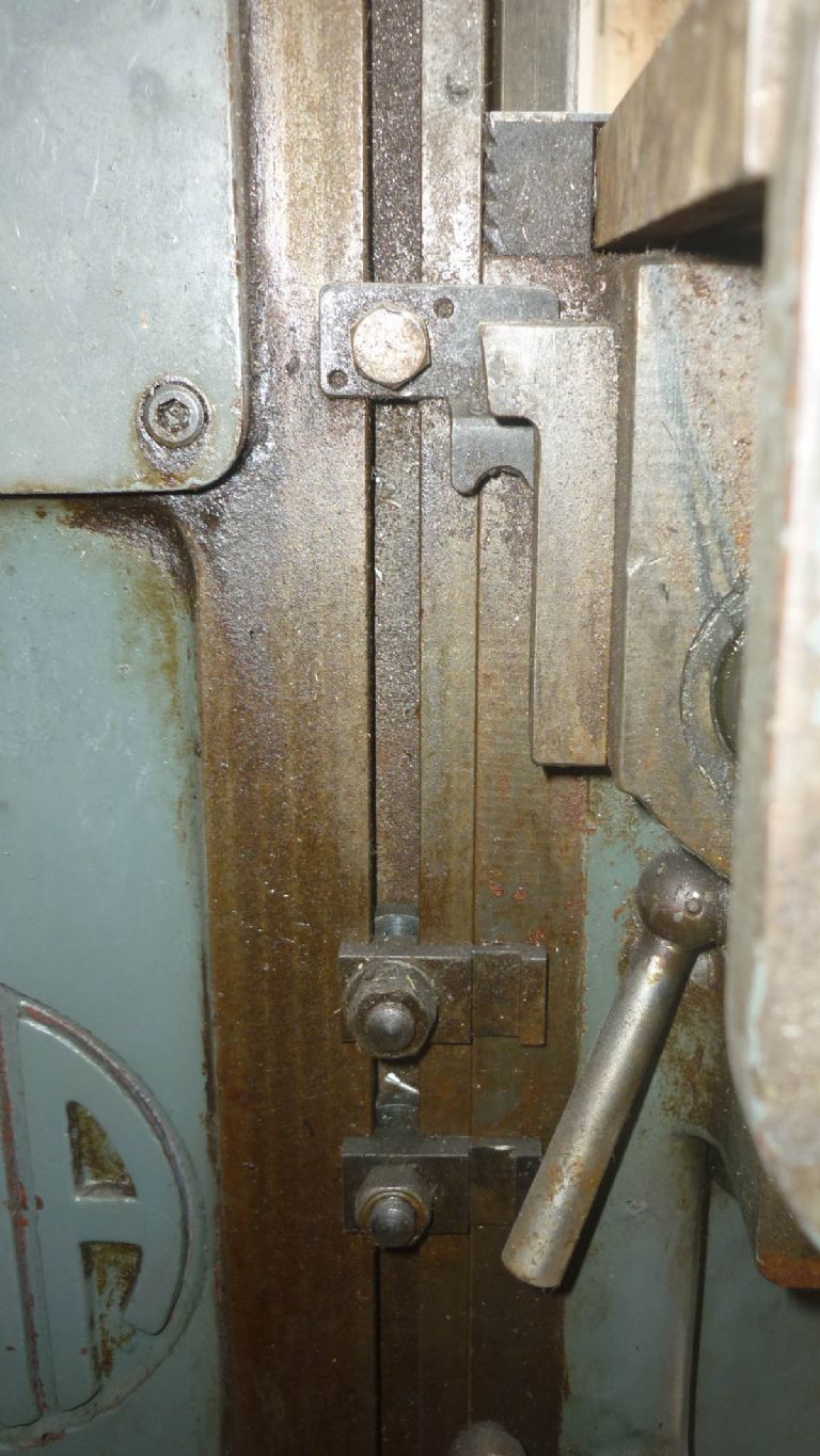

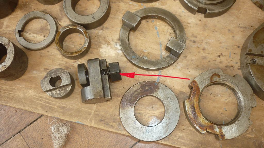

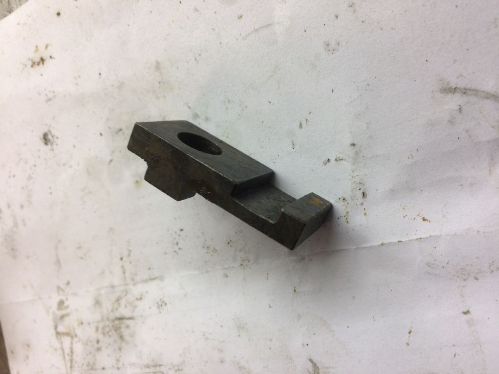

                                      img_4221.jpgIt has taken longer than I expected, but today I am very pleased to announce that my Alexander milling machine is back up and running with everything functioning perfectly! Thanks again to all who helped in providing invaluable advice.
                                      OK so it's up and running but I do have a couple of parts left over! Before I get mercilesslty trolled for this remark can I point out I know where these bits go – just don'timg_4220.jpg know what they do. As you may gather from the pics they fit in the vertical slot you might expect limit stops to fit, but with the channel machined into them – the wheel on the power feed limit crank just passes through/over them. Can anybody tell me how these things are intended to be used – I have three of them!

                                        Dave, they are movable limit trips ,but im also confused how they work. smiley There should be two on each axis in between the fixed ones at the ends.
                                        Heres  mine on the z axis. I also have this bit which im unsure what its for?

                                        Phil P
                                          @philp
                                          When the power feed is already in neutral the trip lever will pass through the slot to prevent you manually crashing into it with the hand wheel feed.
                                          When the power feed is engaged the trip lever will not pass through the slot until it has been pushed into neutral again.
