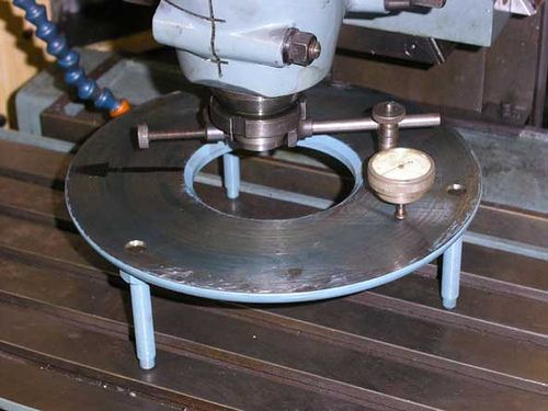

                        And tramming is a two stage process. One to get the table level in both directions and one to set the head. I use a brand new solid brake disc clamped to the newly level table to help with the second stage.
                        c
                        #545904
                        Andy Pomfret 1
                          @andypomfret1
                          Thanks, I'd figured out the tramming process but the brake disc is an excellent tip.

                                Alternative to using a brake disc (which may not be truly parallel and flat) look out for a large bearing outer ring – I use a 10" odd diameter scrap bearing outer ring for tramming my swivel and tilt table on an AcieraF3. But then again the Aciera also has taper pins to quickly locate the 'zero' in all axes.

                                    A brake disc is not always guaranteed to be perfectly flat and true – remember pads 'float' in their calipers so that they can adapt to out of trueness. From memory discs have a tolerance of 50 micron (0.002" ) with regard to trueness. A bearing ring will have a couple of micron tolerance so are far more accurate.

                                                Here is what I use for tramming, the three legs are set to the same height with a micrometer.
                                                Hope this is of some help.

                                                  Is that a brake rotor mounted on the legs, or is it something else that you trust to be flat?
