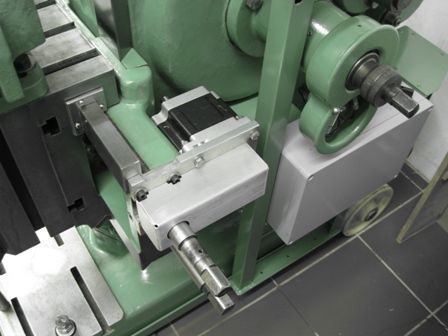

      This should see the last of my Shaper postings! Thank Goodness, some may say..

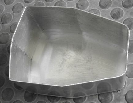

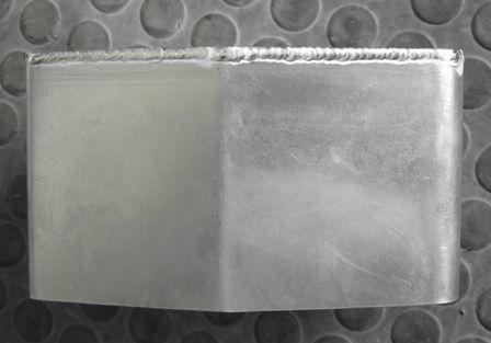

      It is all together and working – the last bits were some assembly and then belt covers for the stepper motor belts. The main drive V belts still have no cover – I will see if I make a cover later – I quite like the big pulley turning round and round..
      The Stepper covers are from Aluminium, the Z axis cover is Tig welded – took a few minutes of practice to get my hand in again for Tig welding Ali…
      Powered everything and started testing the software in the controller and that works fine – one or two changes were made, mainly in stepper acceleration and feed speeds. The X Axis feeds when the Ram is at the rear most position – no feed during the rear stroke, so no tool tip rubbing and no clapper action..So the X axis has to accelerate and feed FAST to have stopped feed by the time the tool tip arrives at the workpiece on the forward cutting stroke, especially at maximum ram speeds…. Likewise the Z axis for down feed, although the axis is much lighter and gravity helps a little.
      Anyway it all works! I ground up a HSS tool to test and cut some PVC first, then some Aluminium, the latter a 3mm feed and a 4mm deep cut – a 4mmx3mm 'chip' – quite nice and all very new to me!
      Tig welding the Z Axis stepper belt cover:
      Z Belt cover painted and fitted
      Belt cover on the X Axis stepper.

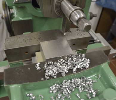

      Process is:
      Set a feed step size for X and/or Z axis
      Set a start point for the tool relative to workpiece
      Set an endpoint ( by jogging the axis) for the tool
      Set the X axis feed direction (left or right) if feed the table across
      Rewind the table to the start of the cut
      Set the Z depth of cut by jogging with the DRO
      Start the machine.
      It will cut, feeding by step size, till the endpoint and stop.
      The Ram can be jogged slowly FWD/REV, and a button will feed the move the ram till the rear position and stop it there ( for RAM position setup, etc)
      Rewind to start again, feed Z down again using DRO, and start, etc…
      A video, hopefully…
