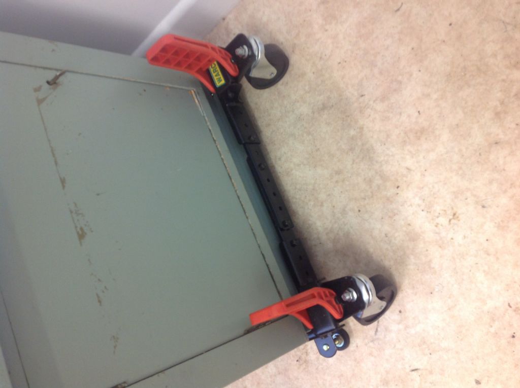

        Trev T
          @trevt
          I would go for one of these:
          **LINK**
          I have got two already, one carrying a cabinet housing vacuum/extractor and mounted mitre/bevel saw, the other carrying a cabinet full of accessories with mounted morticing machine (heavy cast iron bodied thing). The trollies are very adjustable for size and lock solidly to the floor when in use. The smaller version is rated at 500lb, the larger at 700lb, so either would cope with the 350lb printing machine. The casters are outboard of the frame so stability would not be an issue. Problem solved at very modest cost! I have no connection to the provider except as a satisfied customer…
          Trev T

              Trev T
                @trevt
                Whatever system is employed, there will be a requirement to control directional manipulation. The machine trollies only have two swivelling casters, those where the lifting is actuated. This makes it easier for a single operator to control movement, as they only have to manipulate the assembly from one end. I have no difficulty in moving either of my outfits, sometimes involving taking them outside the workshop altogether, me being a 10stone short***** 81yr old!

                John Haine
                  @johnhaine32865
                  Oh, Trev, I wish you hadn't posted that link! That's the kind of thing I was avoiding having to make, and here it is off the shelf and at a modest cost! Maybe I'll go that route instead….how much do they add to the height please?
                  #264167
                  Trev T
                    @trevt
                    John…
                    Sorry for the delay in answering your query – been having yet more trouble with my wayward laptop which resents the imposition of 'critical updates' by MS!
                    The additional height involved in mounting my stuff in the machine trollies is an astonishing 20mm! I had forgotten how little this was, which is due to the casters being mounted outside the frame (which is where the additional stability comes from).
                    Assuming your wife's machine is mounted on a wooden base (eg: cabinet/bench) with the weight bearing on the four corners, mounting will not be a problem. Any introduced baseboard to achieve this would, of course, increase the additional operating height. A few screws through the frame into the structure would complete any 'H&S'(!) issues…!

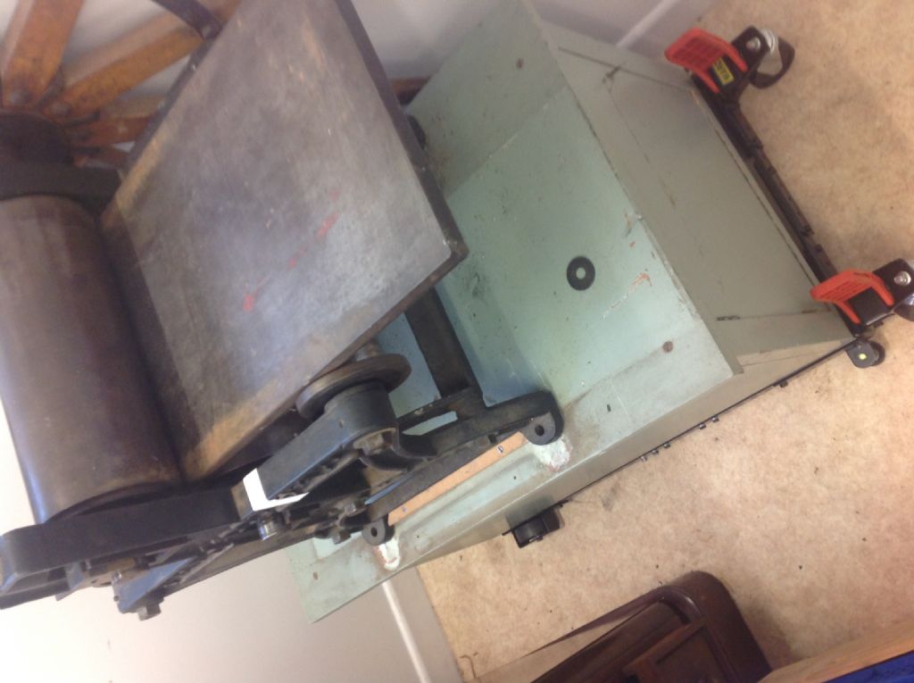

                      #265123
                      John Haine
                        @johnhaine32865
                        Well, after all the comments and suggestions, an update. I decided that Trev's suggested solution was low risk, though boring – I could spend a lot of time trying to get air lift to work and not succeed, but the machine trolley was low risk and available quickly. (Swamps and alligators come to mind.) So I ordered one last Monday, arrived Thursday, fitted yesterday, reassembled press today. It does the job.
                        Sorry the pictures are sideways. This shows the press, the trolley base, and a vew looking under the bed. The top, driven roller is about 5 x 15 inches; the lower one 6 x 15, both solid cast iron. The bed is a 3/4 inch steel plate 15 inches wide and 36 long. Assembly was quite hard work considering you have to lay one of the sides flat, insert the rollers vertically, then drop the other side on top, bolt it together, and finally tip it onto its base.
                        Many thanks to Trevor for the suggestion, I'd never have found those bases without.
