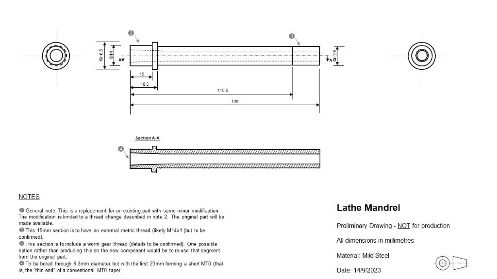

      I need a replacement component made for an old small (12"&nbsp lathe. It's a new mandrel with a different nose thread). So it's a small component but includes a small section of screw cutting and internal morse taper, which I am unable to do with the facilities (and expertise) I have.
      I'm looking for some advice on whether there is an "accepted" (or recommended) way of finding out if it's the sort of thing someone would be prepared to help with. Or, indeed whether it's a job that's too big (in complexity rather than size terms!) to expect help with.

              So, the lathe (a Flexispeed) is 12" between centres. The part I want to replace (the mandrel) is about 5" long and would be produced from 0.75" diameter steel.
              I would, of course, expect to produce a proper drawing. But I think another point I perhaps failed to explain in my original posting was I am not ready with all the precise details yet (I am working on that) but was instead simply trying to gague whether this is it's the sort of thing that would be deemed acceptable to seek help with or, to be put it bluntly, be looked upon as a damned cheek!

                                I have now produced a preliminary drawing.
                                I have also found a small company that claims to do small jobs at very competitive prices so I have requested a quote. I will see what comes of that.

                                    With respect, I think you will find that the Flexispeed is made to Imperial dimensions so you should stick with those, apart from your chosen nose thread.
                                    From your drawing, 12.8mm is a bit more than 1/2", so probably 1/2" bearings. 6.3mm is a bit less than 1/4", so probably 1/4" bore – you need to be a lot more precise than that! And what are you going to do about the worm gear?
                                    If you can find someone to do it, best to just let them have the whole machine and tell them what you want, so that they can fit the spindle to the job rather than trying to rely on a drawing.
                                    And it costs what it costs. It may not be difficult for a skilled person, but it will be time-consuming, so don't expect them to do it for beer money.
                                    £200 odd for the Cowells spindle isn't unreasonable, and an accurately made one-off, starting from scratch, will probably be be more than that.
                                    Sorry if this all sounds a bit negative, but I am not sure you are being realistic. As said- what is the actual problem with the existing spindle?

                                      The reason for replacement is just to change the nose thread so as to make it possible to but replacement chuchs.

                                        There's some valid points here but, in my defence the diagram IS clearly marked as preliminary and not for production purposes. It was provided simply to provide an indication of the size of the piece and key features (to clarify some points raised in an earlier reply). The drawing also proposes what to do about the worm, gear!
                                        As for the "beer money" point. Unfortunately, my post seems to have been misunderstood right from the outset. The purpose of the post was not originally asking for someone to offer to help (although someone has). It was instead seeking advice on how to go about requesting help and, more importantly, whether it this sort of job is considered too complex to expect anyone to help in the first place.
                                        I fully accept the point about imperial measurements. I would do that on a final version of the drawing intended for production.

                                          I'd be inclined to have the bore a little over 1/4" so you can pass that diameter stock through it. 6.5mm would do and also avois a step where the small end of the taper meets the bore as MT0 is just over 1/4".
                                          You may also want to condider specifying a finish particularly for the bearing surfaces which may be better off ground than turned.
                                          Does the Flexispeed have bearing shells or does the spindle run directly in the Cast iron, if in the iron than again a little over 1/2" could be useful if the bearing surfaces have become worn that would allow them to be fitted to the new oversize spindle.

                                            If the object of the exercise is just to allow fitting of different chucks, then an easier solution might be to make an adaptor, or a few separate backplates. I had a Zyto branded Flexispeed long ago, and I think the nose thread was 1/2" BSF. If so, no problem getting a tap to start you off.

                                                I believe you need to have a better spec material than mild steel for a spindle, as a minimum EN8 but En16 or higher would be my choice.

                                                  If you want replacement chucks, why not make an adaptor?
                                                  I've made one to fit Myford 7 Series thread (1.125 x 12 tpi ) chucks to a Myford ML4.
                                                  Also, more recently, have modified a backplate to allow a modern 80 mm chuck (Intended for a mini lathe ) to be screwed onto a 3/4 x 10 tpi Whit form threaded mandrel on a much older lathe.
                                                  An adaptor might well be cheaper abd quisker than a complete new spindle.

                                                    It seems my post has probably come across as, at best very naive and at worst careless and completely lacking any forethought!
                                                    In fact I've been pondering the problem for a few weeks and done quite a bit of research in various places, these forums included, where others have encountered the sample "problem" with exactly the same lathe (and its close cousins).
                                                    Many options have been considered by others (with lots of input from forum members). I obviously won't repeat all the options and the arguments for discounting them (including a spindle adapter) here but in summary there have been two solutions used by others that stand out:
                                                    1) Manufacture a new spindle.
                                                    2) Bore out the chuck and convert, and insert a bush threaded to suit the existing spindle (effectively an adapter in the chuck rather than on the spindle). Down side of this of course is it has to be repeated for each check or accessory to be mounted on the spindle.
                                                    and actually, none of these solutions is feasible without a usable chuck to hold the work in. That, you might say, is the chicken-and-egg situation I have here wink
