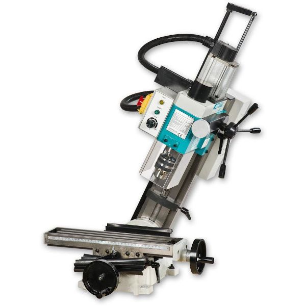

      I have recently been gifted a Warco mini-Mill (other suppliers and names are available). Due to its weight and a rickety path to the workshop, I thought I would separate the column from the table as advised here and elsewhere.
      This is the rotating column variant, and I have the column retaining nut off and the column resiting at about 20 degrees to he horizontal. I can lift the column up and down, but it doesn't seem to want to slide backwards very easily off of the bolt. Not a surprise since that's the main locating point.
      Any tips on easing it off? It's a big lump and I don't want to drop it. I currently have about a 1mm gap between the column and the bracket, so in principle could apply some leverage but I won't want to hack the surfaces.
      Adrian

            I think the mill is similar to this:-
            Is there only the one retaining bolt? Other than gently rocking whilst pulling I can think of nothing except as the OP suggests of applying a little leverage.

              If it's the X1 type mill the column should come off O.K. with the nut removed. I would try a bit of penetrating oil and work it up and down a bit as you pull. ARC have some dismantling guides on their websites for their versions that might help.

                I have the tilting column version in which a rectangular column rotates around a large bolt in the Y-axis so that the head can achieve angles in the X-Z plane of about +/- 70 degrees to the Z axis. It is essentially the same unit as described in Neil's article on mods to the mill at http://www.stubmandrel.co.uk/workshop/90-improving-the-rigidity-of-an-x2-mill **LINK**
                The goal is simply to separate the unit into two lumps for lifting purposes. Two approaches appear on line: (1) undo the Z-stop, wind the head up to the top and take it off and (2) unbolt the column and the head. Ketan in a post here prefers (2) to (1) so I thought I'd better try that first, since Ketan certainly knows more about these units than I do!
                The problem is that the column doesn't really want to come back off of the rotation bolt, and it is pretty hard to get much force onto it without using a wedge to separate them, and I don't want to hack up the sliding surfaces for the rotation axis.
                Of course this arrangement, in which a single bolt and a thrust washer are all that you have to maintain rigidity in the Y-Z plane, is pretty flimsy, so I shall no doubt soon be implementing the bracing plate approach described by Neil in that article above. If I only I can get the thing down into my workshop first…
                Adrian

                  Hi, like Journeyman I think this is the one Adrian means.

                    Thanks to Russell and Nick whose messages crossed with my clarification: yes indeed that is the version. Apologies for confusion: I forgot that there was a round column version.

                      Thanks to Ruissell's pointers, I looked at https://www.arceurotrade.co.uk/machineguides/Super-X1L-Mill-Dismantling-and-Reassembly-Guide.pdf https://www.arceurotrade.co.uk/machineguides/Super-X1L-Mill-Dismantling-and-Reassembly-Guide.pdf I shall try unbolting the bracket from the bed rather than sliding the column back off of its rotation bolt. The Warco variant I have has a rather different mounting arrangement for the column – the Sieg one in the document above and Neil's article looks like a much more sensible engineering proposition with a proper pivot but there is enough commonality to give me some ideas.

                        I have the Chester equivalent of that machine, and wonder why you feel the need to take it apart to move it? I can lift it on and off the bench by myself. I did get help to carry it down the cellar steps, mainly because it's a bit awkward to hold.
                        Removing the table would remove a similar amount of weight, and is easier to do.

                            Nicholas – OK, well that's excellent, but beyond my capabilities. The machine weighs just under 70kg. My body mass is 80kg, and machine tools are not cuddly things to carry, though I can manage a 45kg compost bag without trouble (bags of compost don't have sharp edges). The machine has to be taken about 100m up a rough path. I can lift it onto a low trolley to move it around the house, but the trolley won't go up the rough path, and I can't lift it up to bench height. Hence proposal to split. I don't think taking the table off will be sufficient as it is only a small proportion of the mass, but I'll take a look.

                                Your 70kg is the shipping weight. By the time you've removed it from the crate, taken the vice and drill chuck off it will be less than half that. Which is low enough to move around, although some help moving it down your path would be sensible.
                                Strapping it to a sackbarrow would also work.

                                        thanks for the various suggestions. I am hapy to say that the mill is now on the bench at the bottom of the garden, though still in two pieces.
                                        Just to respond to a few messages, and in case somebody is reading this in five years time when faced with the same challenge…
                                        @Stuart Smith 5: yes, winding the head up to the top is one option, but Ketan and others have noted that lifting the head up and aligning it to get it back on can be strenuous, hence the suggestion that taking the column off is easier (though I note Clive successfully took the head off before removing the column).
                                        @Clive: for me the solution was to take the handle off one end of the table and move the table to its furthest extent. This allows the column to tilt down to maybe 20 degrees above horizontal without fouling the table or the handle. I chocked with wooden blocks to take the weight, then simply undid the three bolts holding the column bracket to the bed. I should have thought of this before, but hadn't removed the previous owner's protective bellows to look carefully at the construction. I think trying to take the column off of the pivot with the base still attached was basically a bad idea.
                                        @ Nicholas Wheeler 1: I guess you are thinking of a different unit when you suggest it would weigh less than half of 70kg. Once I had the unit split, I weighed the two parts. Together they amounted to just over 57kg. Rather nicely, the base/table unit and the column/head unit weigh almost the same, to within 1kg, and I can manage 29kg. I would suggest that one person carrying 57kg any distance might be a bit challenging even for fit young guys (I'm a fit old guy of 61). Though wouldn't it be great to have a mini-mill 100m dash at your next model engineering sports day
