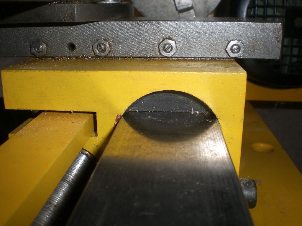

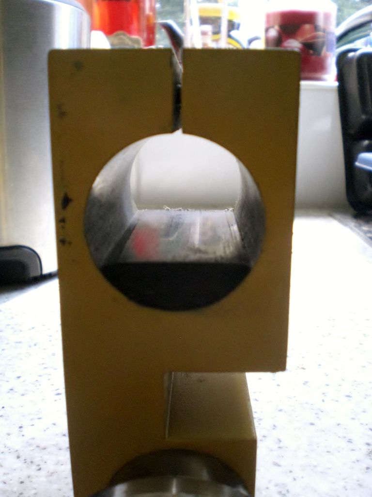

                    Hi Hans, not quite sure what you are trying to say, but a plastic half round part should be fitted inside both the tailstock and the carriage, the full length of the bore. The photo below shows the tailstock, looking though the bore of the tailstock, showing the position of the plastic part. The tailstock is in the upside down position in this photo.
                    Below is the one in the carriage, in position. It is these that stop them rotating on the bed.
                    Hope this helps, but if not, a photo may help us to understand your problem.

                    #419996
                    Hans Mol
                      @hansmol79190
                      Hello
                      all solved thans to this forum
                      i used the two pieces of plastic and drilled two holes in the support through the plastic.
                      then inserted 2 steel expandable pins in the support intomthe plastic.
                      also used some two component glue
                      this all prevented the rotation of the support around the bed
                      thanks

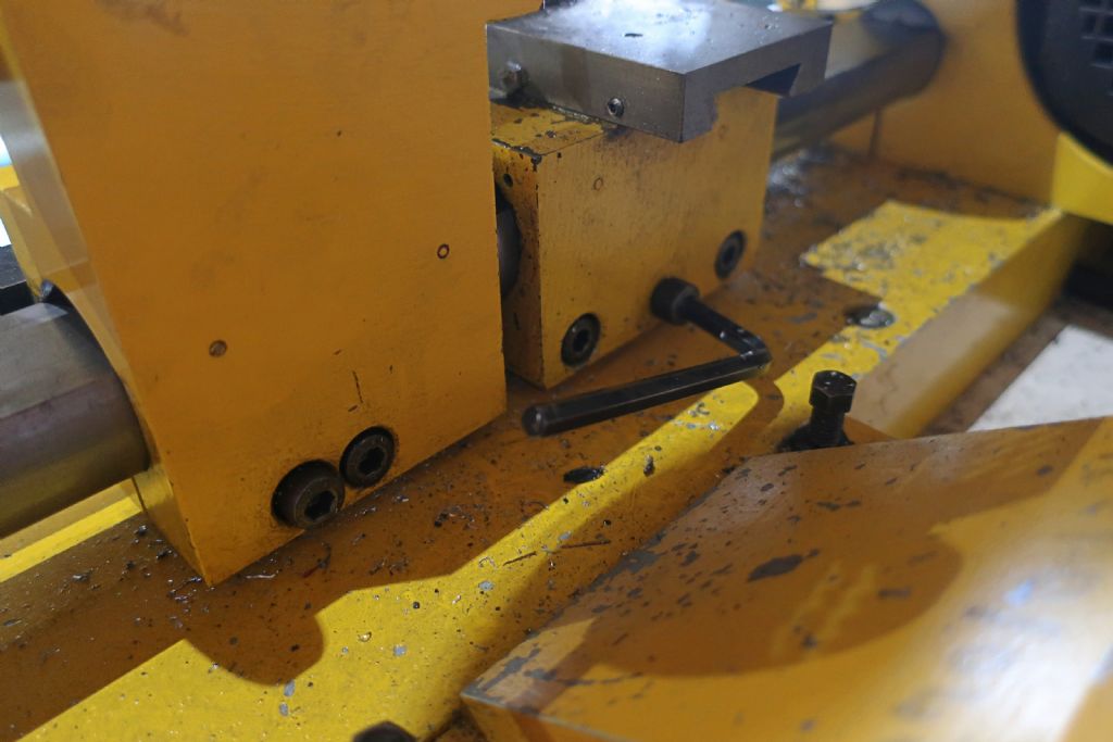

                            There are two socket screws in the rear of the tailstock base – the one at the front (nearest the headstock) is a CLAMP screw. The one to nearest the centre of the base is a FORCING screw which presses against the side of the base, to open the gap and allow the tailstock to slide.
                            To free the tailstock, loosen the front clamp screw, and gently tighten the forcing screw until the tailstock is free – no more than one quarter of a turn, as there is danger of cracking the casting. As you say, it may be stuck to the bed with old grease.
                            To adjust the tailstock for use, slacken the back forcing screw, and gently tighten the front clamping screw until the tailstock is only just, but still firmly held. Then gradually tighten the back forcing screw until the tailstock can move. It may take some attempts to balance the forces correctly to achieve smooth movement with a new lathe, as the parts will need to bed in.
                            The carriage is adjusted in the same way – here, the FORCING screw is in the centre, and the CLAMP screws are at either side.

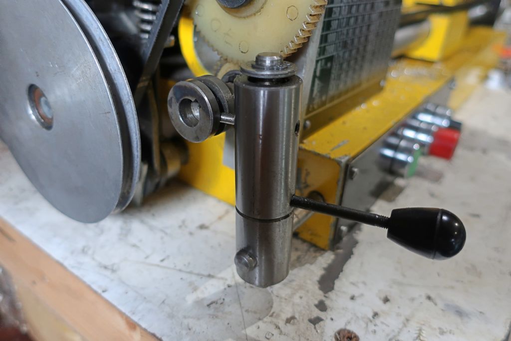

                                  DiogenesII
                                    @diogenesii
                                    …I'm not sure when they revised the design..
                                    ..Nick, I notice a few other differences from the model you have, the switches obviously, but perhaps of more interest, the dog-clutch lever mechanism..
                                    …Legend plate states Saupe & Sohn Gmbh, 1990… ..more pics in my album..
                                    Edited By DiogenesII on 09/07/2021 17:31:51
