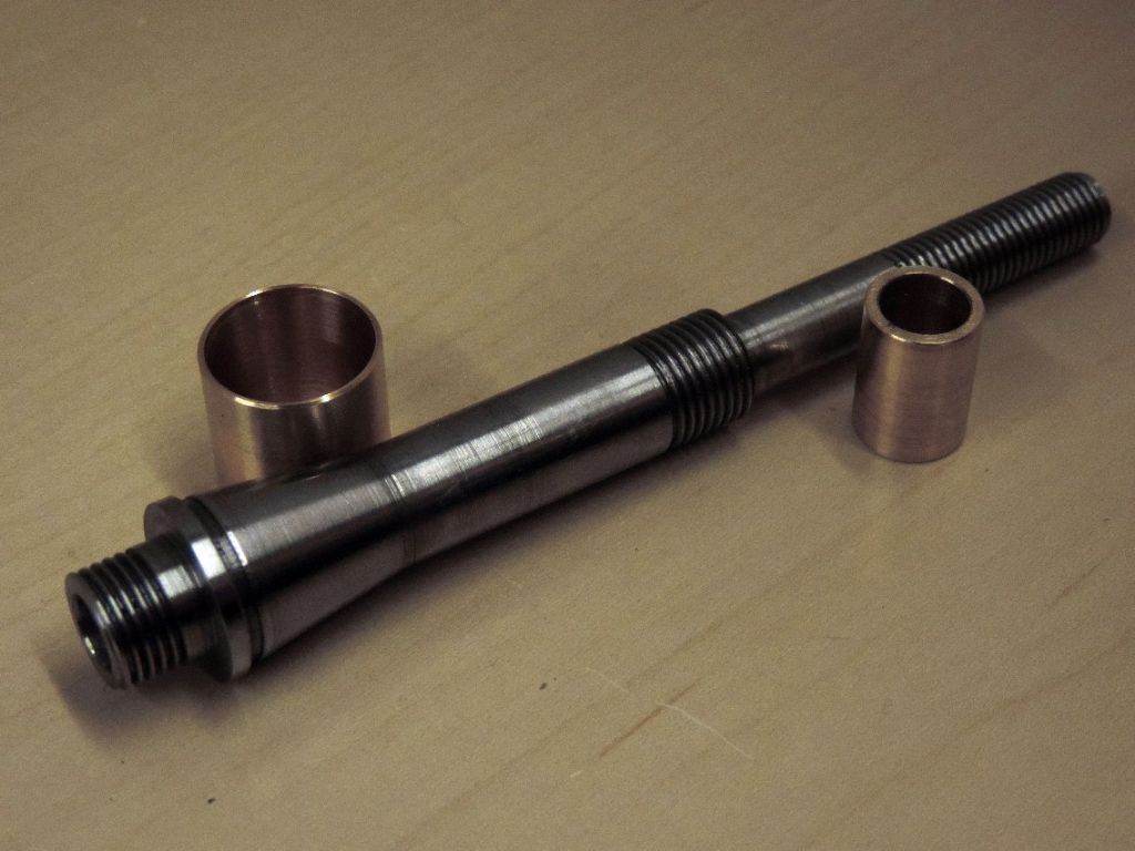

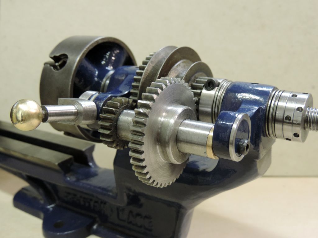

                Progress on 'supercharging' mine has stalled a bit;

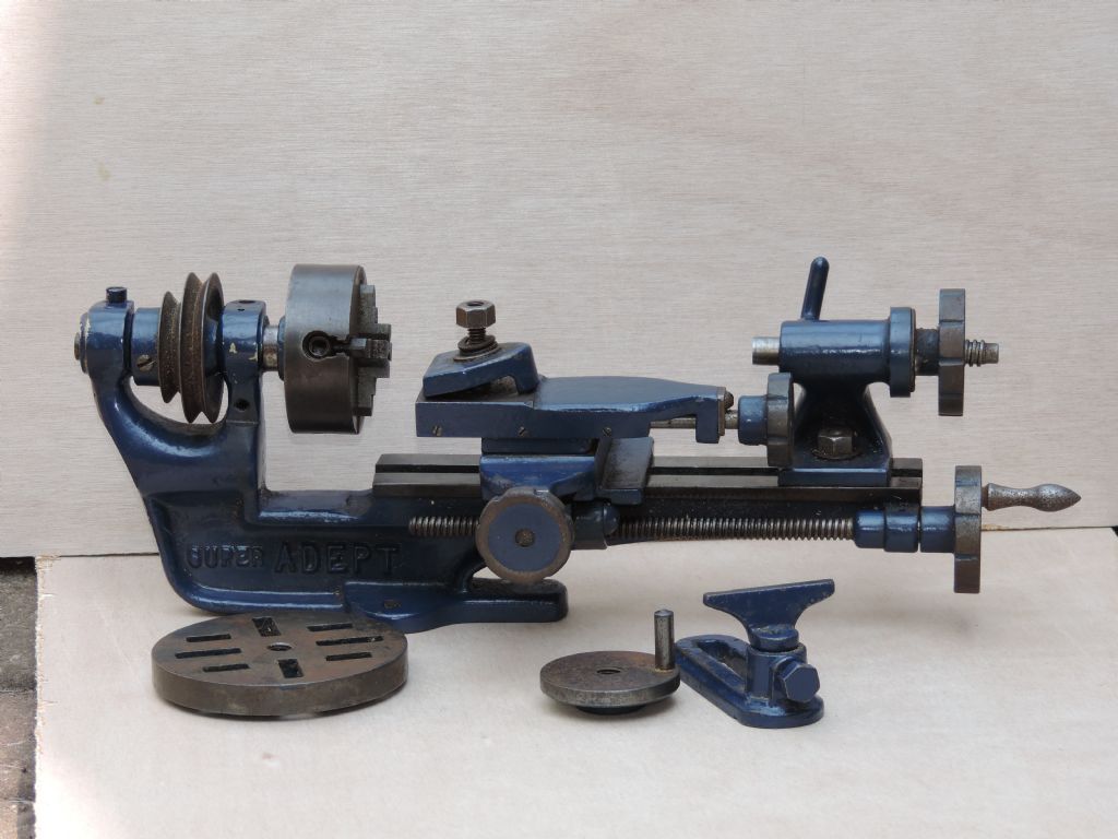

                            I have posted some images of the new lathe in my adept mini lathe album. I’m confused though as both lathes are marked as Adept but the first one has more characteristics of a super Adept. The second one has a tail stock unlike any others I can find in the net. It must have been modified to a screw feed as the handwheel is an old radiator valve wheel and the screw is normal form not acme.
                            The original solid centre is still with the lathe. The locking screw is on top rather than behind the casting.
                            Do I have two heavily modified machines or just par for the course output from Portass?

                              First one looks like a standard Super Adept.

                                I thought that Neil but the bed casting does not have super on it. It does have dovetails on the bed whereas the other has square slides.
                                The tailstock is puzzling me on the second one with its top mounted locking screw.
                                The tool slides on the first one puzzle me as the shaped ends appear to have been cut flat.

                                  They are a neat looking little machine when you see them all tidied up like Neil's, with little baby back gear and all.
                                  Surprised to see they use a tapered bronze bearing in the front headstock. Obviously where Myfrod got the idea for the Super 7 bearing from.
                                  #331542
                                  Roderick Jenkins
                                    @roderickjenkins93242
                                    Posted by Hopper on 11/12/2017 08:48:39:
                                    I think that's one of Neil's mods. I expect be got the idea from a Myford wink
                                    Rod
                                    #331543
                                    Hopper
                                      @hopper
                                      LOL, that makes more sense. Nice one Neil.

                                        My lathe has parallel bearings, taper bearing a bit over the top for Adept (except Neil's one).

                                            I don't think the 'super' is a reliable indicator. What is definitive is if the bed has cast in lugs for the leadscrew, then it must be a Super.

                                                  By the way Neil, the carrier bracket for the leadscrew is a brass affair with two locating dowels and bolts under the lathe bed, no cast lugs???
                                                  #331624
                                                    Posted by Tractor man on 11/12/2017 19:19:37:
                                                    In that case someone may have converted an Adept. The Adept has no leadscrew.

                                                      I don't think anyone has ever classified the Adept taper, it seems to be a 'factory special' – one reason for my beefed up spindle with an MT0 taper.
                                                      I plan to bore out the tailstock for a spindle big enough for MT0 as well.
